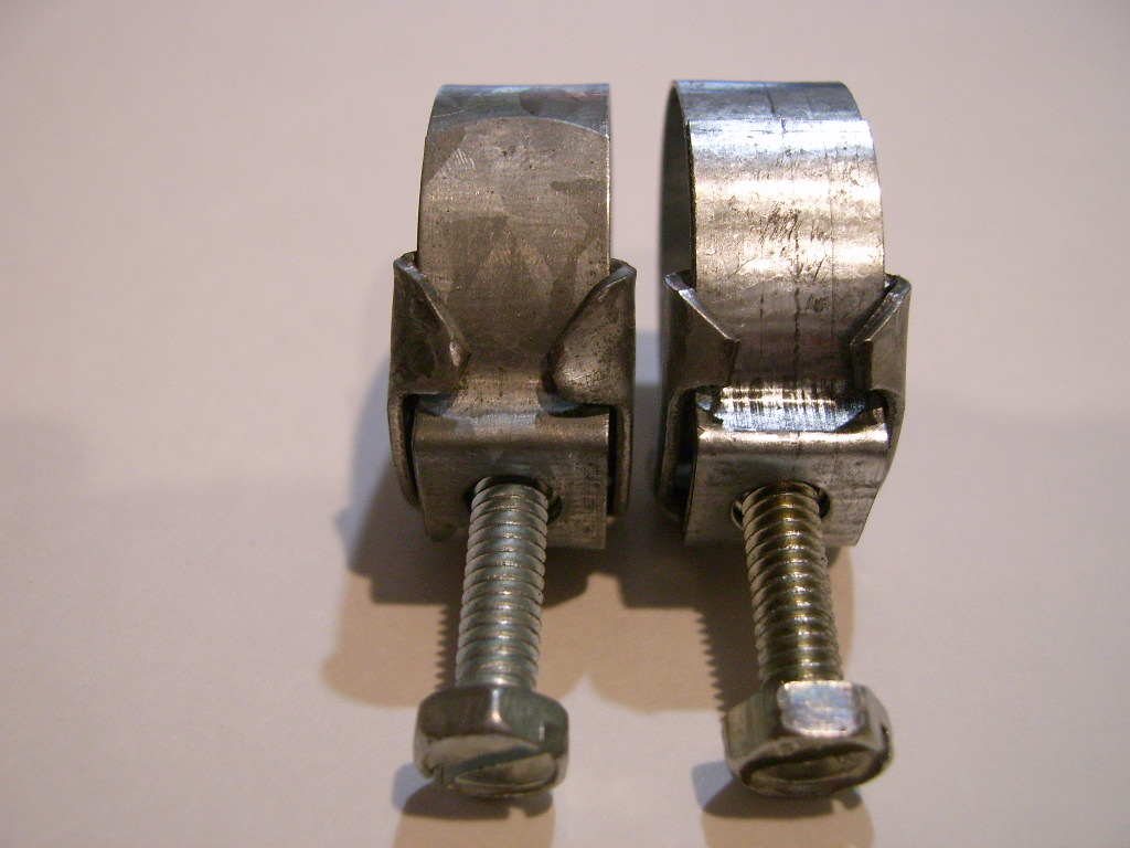

Can someone measure the width of an original smog clamp across the band? Preferably smal block '69-'72. Pic is untouched '74 z. From what I've gathered so far is that they are supposed to be 7/16" wide 1 1/16 GN34 (5/8" hose). Curious to see if any 1/2" wide GM34 came from the factory.

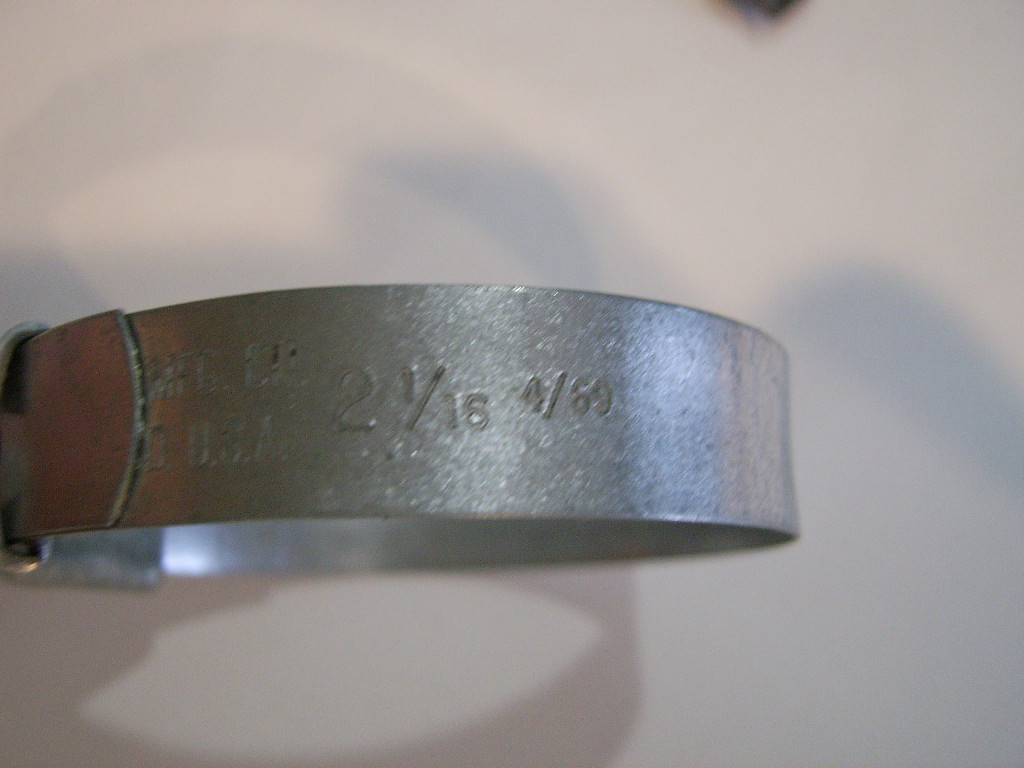

Will update with reviews of any purchases. I spoke with Eric at Marti. Eric verified all sizes for a '70 z are available except the 7/16 wide 1 1/16 smog clamp. That is, if 7/16 is in fact what was used. Trying to verify this through this thread. They can do 4/69 dates but not 1/70. My car is a 04B, so I didn't ask about any other '70 dates.You can also order undated.
Will need the thickness of an original clamp for comparison, if someone can help with that.

I had an original Wittek clamp that is stamped 3/69 1 1/16" and the band width is 7/16".
