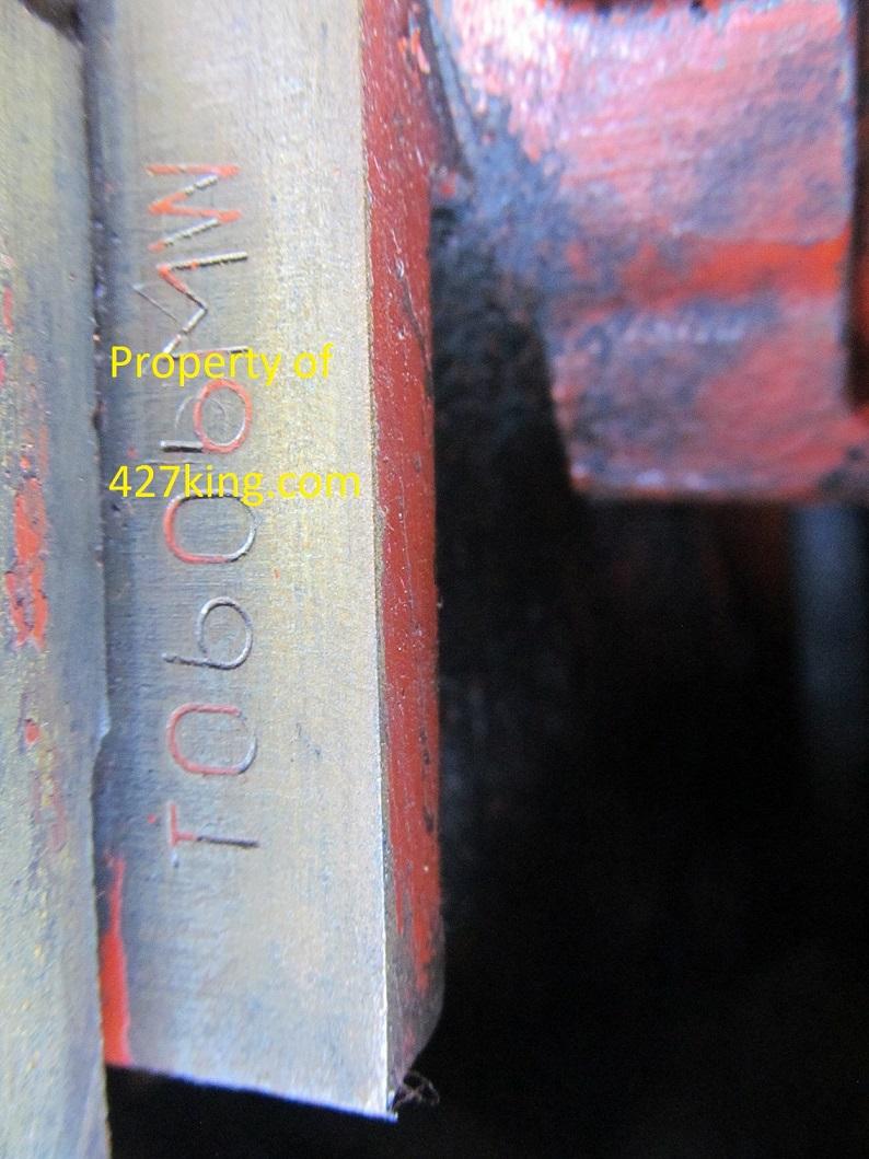

Old 10-27-2019, 03:09 AM
the427king's Avatar
Join Date: Jun 2011
Location: CT
Posts: 7,070
Thanks: 217
Tony heres the pad from the car you found me.
No Fisher priced toys here
The Following User Says Thank You to the427king For This Useful Post:
elonblock (10-27-2019)
Old 10-27-2019, 03:13 AM
the427king's Avatar
Join Date: Jun 2011
Location: CT
Posts: 7,070
Thanks: 217
Notice how high the center of the W is pointed on mine vs the one at auction.... IMO it is a restamp.
Old 10-27-2019, 03:28 AM
Zedder's Avatar
Zedder Zedder is offline
Join Date: Sep 2002
Location: Ontario, Canada
Posts: 3,325
Thanks: 100
Thanked 639 Times in 352 Posts
Thanks! Yours looks much better! That pad is perfect!
Mark
