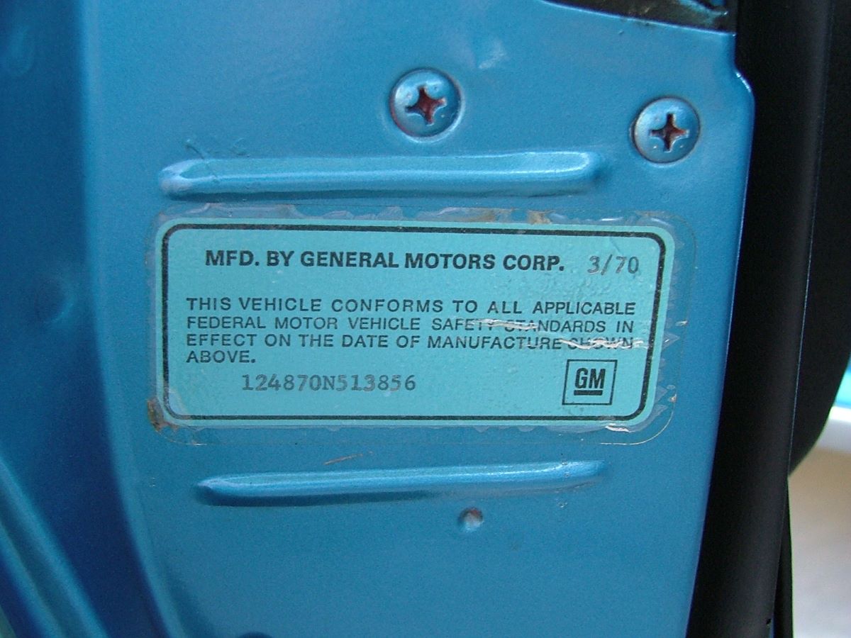

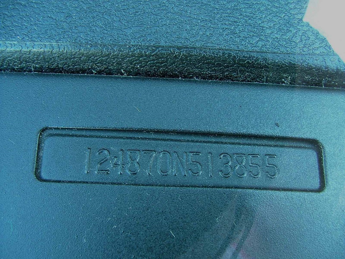

Here are some disturbing facts and pics from this seller as I have been in contact with him.
1. All the pics used to present this car are the exact ones used from the Bringatrailer ad which was posted several months ago. .
2. How many 1970 Mulsanne Blue Camaro Z/28’s have stripes painted on the roof as well as having the rear taillight panel blacked out?

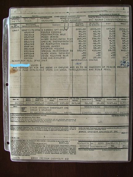

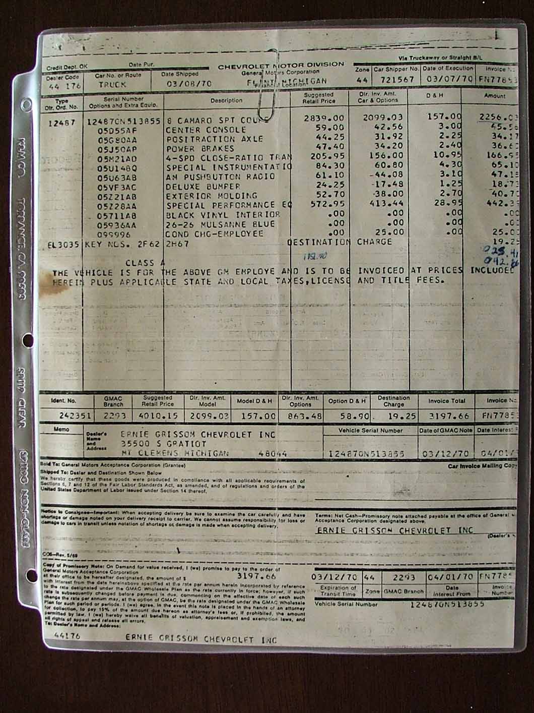

3. I then requested the current eBay seller (called preacherhank2) forward me supporting documents to prove to me that this Camaro is an actual Z/28. The documents that were forwarded were very similar to the ones used from the ad on the Bringatrailer ad.
4. I then decided just for fun to compare the documents between both cars and this is where it gets really scary.
5. It just so happens that both cars VIN numbers are just one digit off. Are you interested yet……?
6. This 1970 Camaro Z/28 VIN currently on eBay is 124870N513855.
7. The 1970 Camaro Z/28 VIN on Bringatrailer is 124870N513856.
8. The pic of the trim tag that was supplied to me from the current seller on eBay is VERY similar to the one that was supplied on the Bringatrailer ad. What was now so unique was that the body sequence number for the eBay Camaro is the same body sequence number that was posted on the Bringatrailer ad. In other words, did GM use the same sequence number twice while building two identical Camaros in 1970? Are you interested yet……?
9. As a result of using all this duplicate info. the original selling GM dealer (Ernie Grissom Chevrolet in Michigan) in 1970 must have just happened to get two identical 1970 Camaro Z/28, just one VIN apart. Possible…..yes, but just keep reading
10. To confirm my suspicions, take note of all the supporting documents, especially the two pics of the in-dash VIN number. Notice the chunk of dirt in the blue paint just to the right of both VIN numbers in the dashs. Is it not odd that this dirt would be duplicated to a “T” on both cars?

Here are the same pics as in the other post.
Just like magic......two identical cars but with different VIN's. Boy that sounds surprising......NOT!

Even the cracks, shadows and fuzz are identical.

This fool is very talented Photoshop wise... Except he didn't remove the dust!
