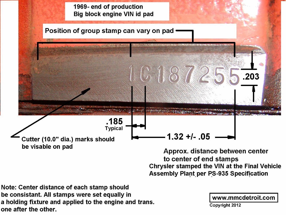

PERSONALLY, I'd need to see that VIN stamp on the block with no paint. At first blush it's kinda wonky. The zero starts high then everything droops then goes up again at the end.
Not exactly following Hamtramck norms for stampings I have seen and owned. Not calling BS on it but would have to get closer...

This is from Dave Wise. My gut says it should be a straighter gang stamp as Dave shows here
(courtesy MMC Detroit) Also note broach marks

And I just noticed the Julian date of 3028 on the transmission (Nov. 11, 1969, in my previous post I thought it was a 1968 tranny but I am correcting myself) matches the VIN last 4 digits??? That is unheard of. And again that stamping , ugh ....AVOID!

Does not appear to be gang stamped as the GM products were, although I am not familiar with Mopars.
