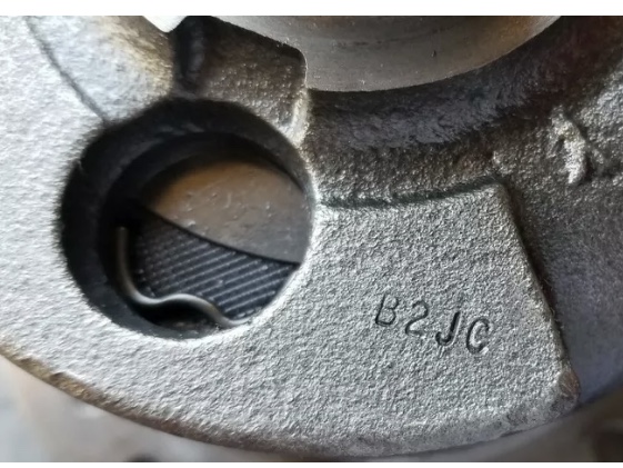

It would make sense that they didn’t use the letter I for year - but I swear I had one a few years ago with the year letter stamp being I. I could be wrong or suppose it could be later. Although they stopped being used in production in 1972, they were made much later.
Here is a later one. Year code JC - maybe 1993?

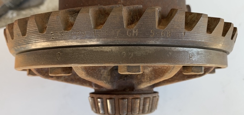

The format is letter number letter. Here is one stamped C 22 H from a 10 bolt 3 series posi.

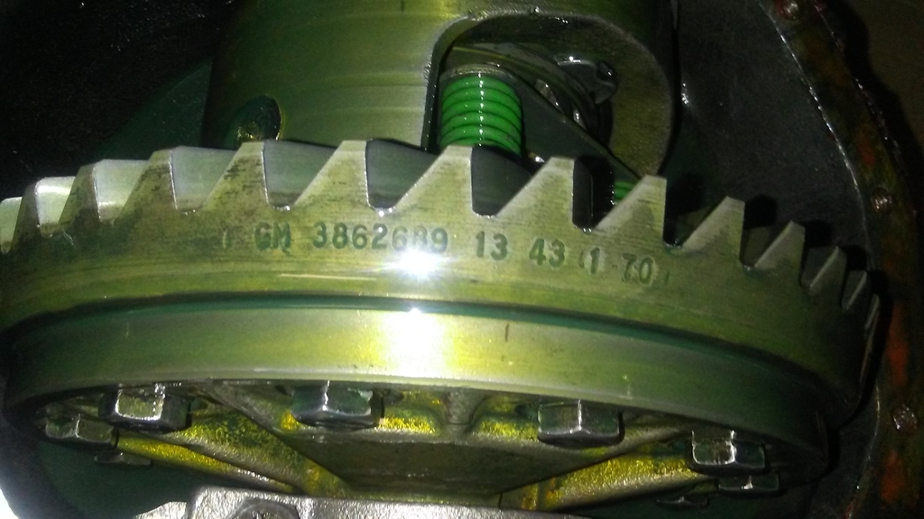

Here is jan. 22 assembled rear gear.

Thanks for posting that. The posi assembly date stamp is late 69, fits fine for a Jan 1970 axle assembly.
Would anyone have data from other years they would want to post from original axles?
