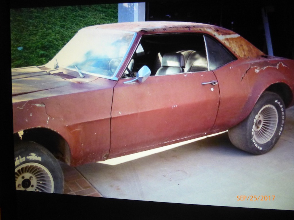

Could it be possible that the JL8 option was ever ordered/installed on a standard 1969 Camaro that is factory equipped with a 307ci engine and a Saginaw 4 speed transmission? Thanks in advance!

Yes, Gregg found that very set up. I saw it when he brought it home after pulling it out of a California field.

Mine was ordered with 307, 4 speed, factory air, blue light stereo, vinyl top and of course the JL8 option. It had June of 1969 dated Delco air shocks and trailer wiring still present when I found it. It was delivered new to a dealer about 30 miles from the Van Nuys plant but was built in Norwood due to the JL8 option.

Whose car is this? 307 V8 with AC:
