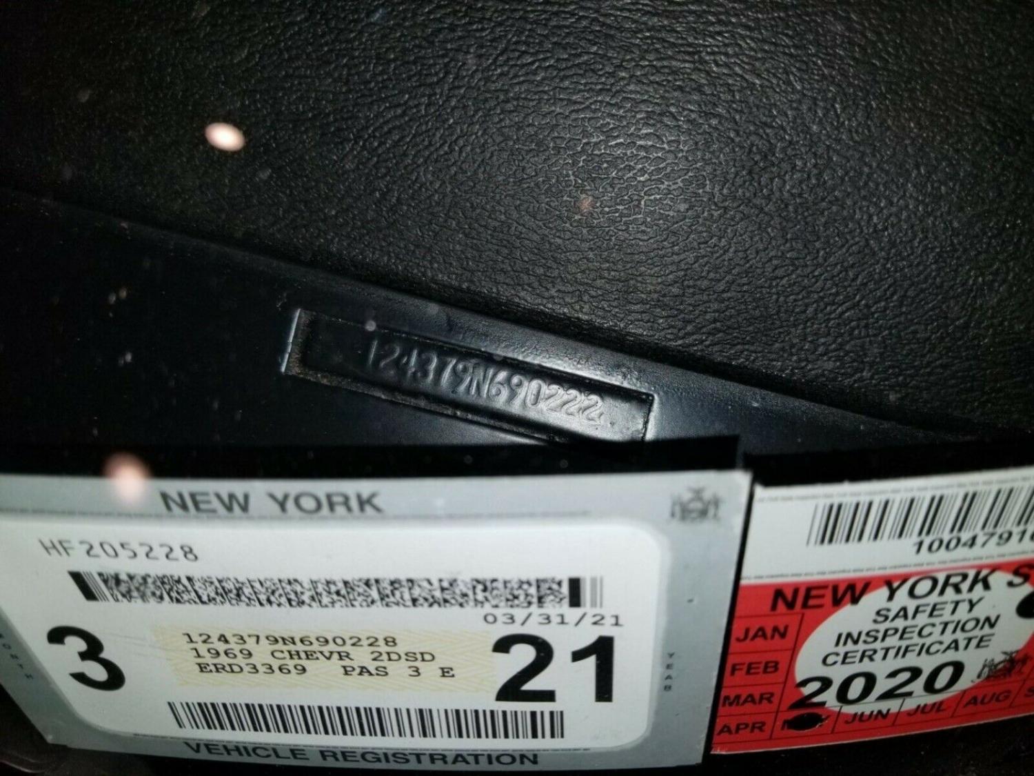

The NY registration label on the windshield lists the VIN as 124379N690228; the VIN tag and invoice shows 124379N690222. Wonder what VIN is on the title. The protect-o-plate photo is hard to read but the last character of the VIN looks more like an 8 than a 2. On the invoice, the last character of the VIN is typed on a line but the line under it is not visible as it is in several other areas on the form. The dash top has been replaced so the VIN tag has been removed from the car.

Auction is a scam, the window sticker and VIN pictures have been photoshopped.
Look at how the line does not go through the last 2 on the vin.

124379N690228 was on BaT las month.
https://bringatrailer.com/listing/19...maro-rs-ss-25/
