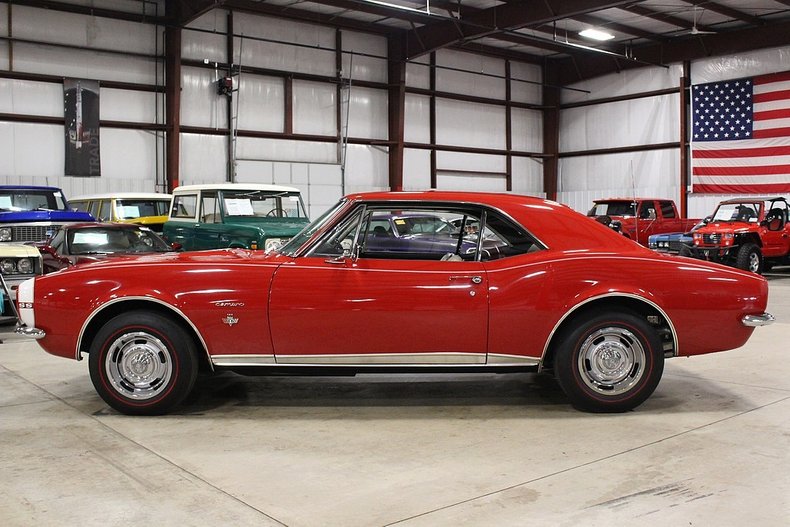

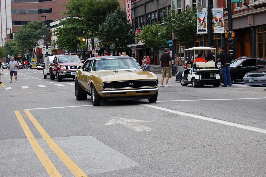

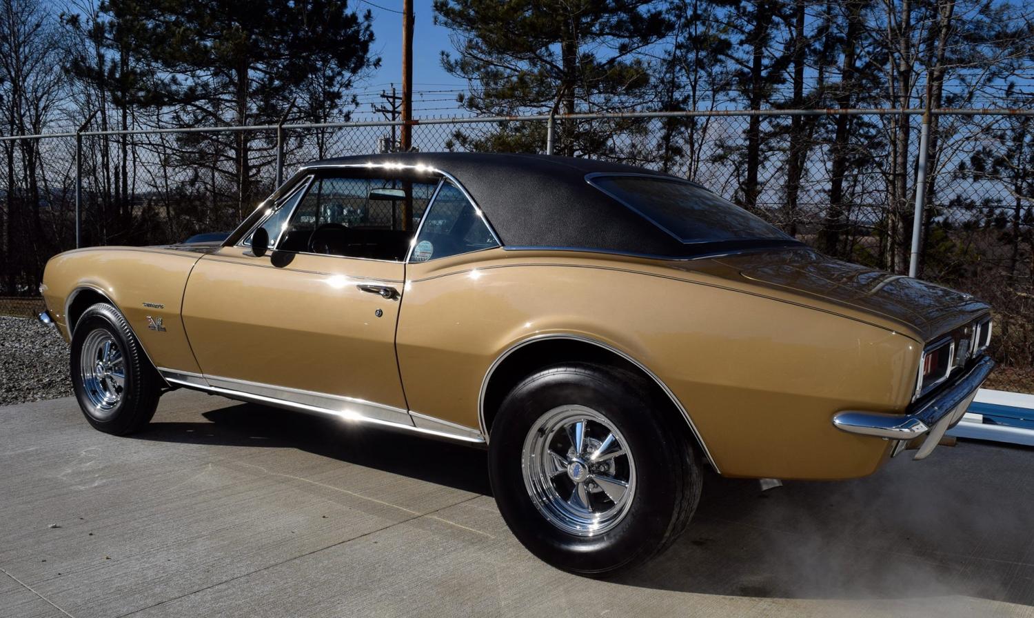

I’d like to buy a set of Cragars for my 67 Camaro, but don’t want to mess with the suspension at all. From your experience, what size rim/tire can I get away with in the back? I love the skinny/wide look like in this pic, but doubt I could do that without air shocks or something similar.

Old 08-09-2020, 02:31 PM
Zedder's Avatar
Zedder Zedder is offline
Join Date: Sep 2002
Location: Ontario, Canada
Posts: 3,322
Thanks: 100
Thanked 637 Times in 350 Posts
This the ride height of my car.

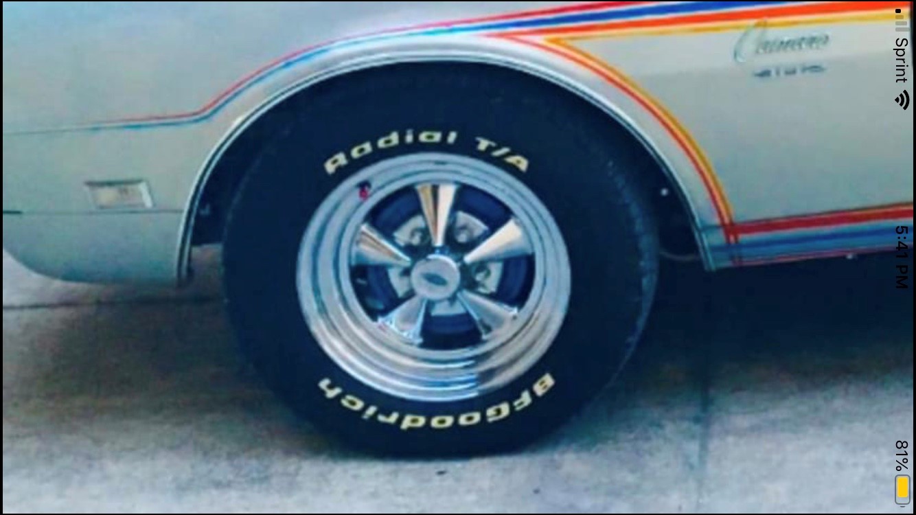

15x8's on a L60/275 tire fit nice on a 67/68 but I prefer a 15x7 rim with the same tire because it bulges the side wall of the tire for a little more period look. if I could only figure out how to post pics ? I have tons on my phone I could share
Old 08-09-2020, 04:31 PM
NorCam's Avatar
NorCam NorCam is online now
Join Date: Feb 2015
Location: Alberta, Canada
Posts: 4,237
Thanks: 2,748
A shot of Jeff's 67 with Cragar's.
