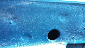

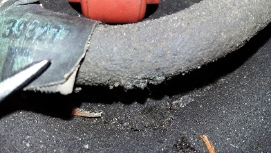

Have a local friend with what might be a 1968 Z/28. He's owned a bunch of Camaros over the years, older, so not necessarily his first rodeo.
15" tire sticker in glove box, has a 12 bolt in there. Are there any codes that might be on suspension parts to help him?
Orig engine and trans are gone.

Yes, the small block spring tags will be different than big blocks if they are still there / visible. While the 15" tire sticker is a good clue I have seen non Z28s with that sticker.

Spring sticker
Old 03-08-2021, 01:28 AM
fiveforty fiveforty is offline
Join Date: Nov 2007
Location: Goffstown N.H.
Posts: 276
Thanked 78 Times in 32 Posts
If it has production line dated fenders that have only been drilled once for the Z28 emblem. This is an 04D car with fenders dated the 11th and 15th week of 1968
