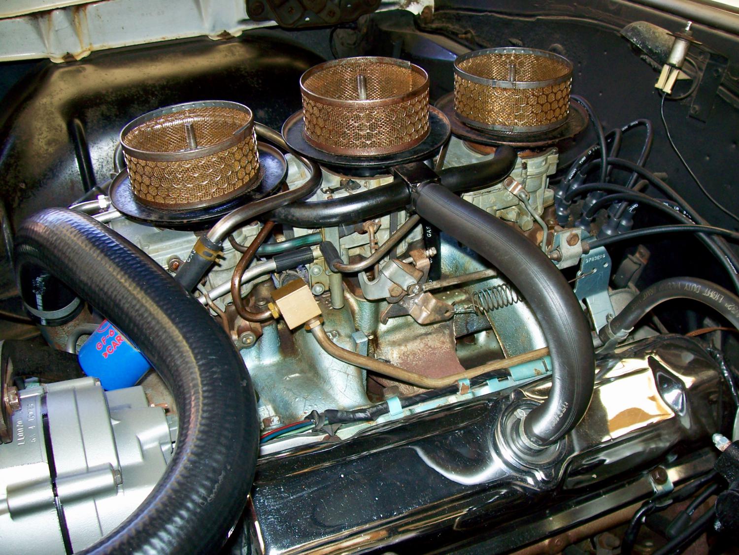

The view of the engine they show and the view of my “YR” are very close except my car was assembled at the Fremont plant which used a “Bundy Tube” fuel lines opposed to the other plants using aluminum fuel lines.
As it turns out, both the test car and my car were built with Power Brakes, Power Steering and Underhood Light.

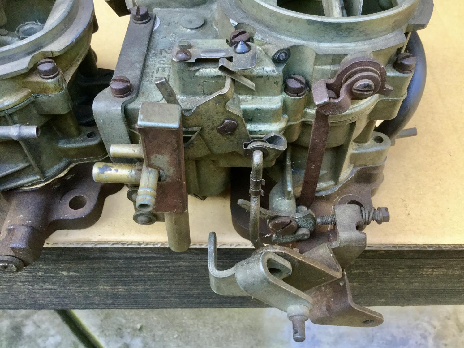

Intricate, yes, with no less than 12 major components.
Left side.
The “Trigger” of the system.
The center carburetor “vacuum switch” has a slide mechanism built in that allows vacuum to enter a steel line that goes up and over the carbs to activate the two end Rochesters.
The flat lever on the side of carb has three arms, two of which open and close the vacuum source.
Once you put your foot into it an arm moves the slide switch and allows vacuum to open the end carbs. This is when the Howling starts.
This is shown on a spare carb.
So, once you take your foot off the loud pedal there is still a residual vacuum in the lines holding those end carbs wide open, hence “Suicide Linkage” !!!
You are freaking out at this point thinking something is stuck and your going to die. Just at that moment, the vacuum releases the carbs and your safe.
My first time in that situation I sh*t. Now I know how to feather that vacuum switch just right.
I’ve heard stories of customers with these vacuum cars back in the late 60’s being scared and demanding the dealer do something about it.
Bring her in mam and we will throw the vacuum stuff in the garbage and installed this user friendly mechanical linkage.
This adjustable trigger switch is made by Trico.

Interesting there is no hose going to the hollow carb mounting stud on the pass side front of the rear carb.Just has a rubber cap on it?Tom

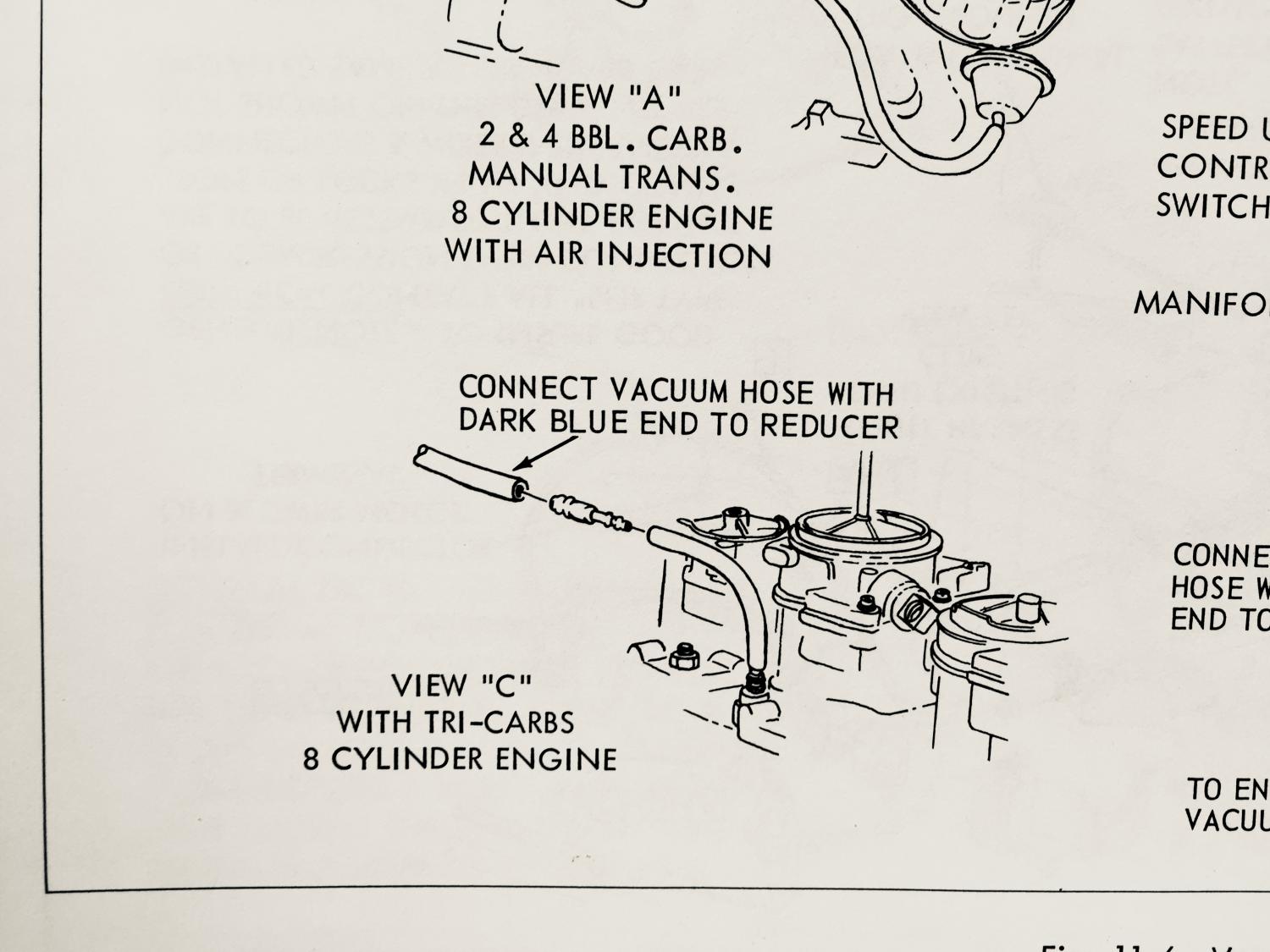

tjs44,
The test car and my car have the flat top cap on the hollow stud as these cars do not have air condition.
Air condition cars with Tri-Power pulled their vacuum source from that hollow stud on either the rear carb or center carb as shown in the illustrations.
Thanks, Chris.
