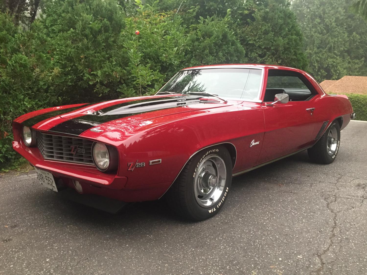

Good morning
Were some 1969 Camaros originally ordered with the NK1 black cushion grip steering wheel? I had a Feb 1969 L78 years ago with it..no reason to doubt it wasn't the original wheel...original owner claimed it was.. I also recently looked at another early spring 1969 car with it. I have seen where it is disputed if it was available or installed in 1969 Camaros though.
thanks
Attachments - The Supercar Registry NK1LA.PNG NK1.PNG IMG_5205.jpg IMG_5141.jpg
