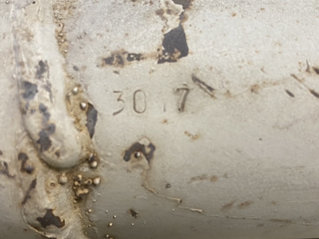

I acquired a set of NOS Blackjack headers. The part number is 3017. Unfortunately, I can’t find that number anywhere. Does anyone have an old catalog to match it up?
The story is, they were mocked up in a 1970 Chevelle but never used.
Thanks in advance, Kurt

Comparing w/ other Blackjack/Appliance Headers, they appear more Camaro like than 'Velle?
1'st pic below is your pipes compared w/ Nos '68-72 Velle pipes from this thread, note swept back angle of mid runners...
https://www.yenko.net/forum/showthread.php?p=1301952
2'nd pic is yours compared to 1'st Gen Pipes from this second linked thread, pass' side looks different for accessories perhaps but driver's almost the same other than pic angle?...
https://www.yenko.net/forum/showthread.php?p=1260298
Also of note in the second linked thread is Member Whitetop mentions he has a Blackjack Catalogue.

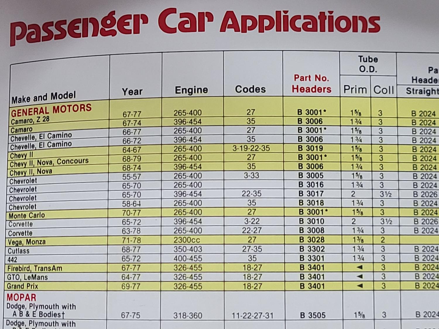

I have a catalog. Remind me in case I don't post the information tonight.

Hi Kurt! Those look identical to my Appliance CH4s, which are for 67-69 Camaro. You can see mine on my build thread.

Chuck, I think your 100% correct, before Appliance headers changed to Blackjack the CH4 number was used, pretty sure the blackjack number is 3017, same header later issue.
I put a lot of those Appliance headers on in the early 70,s when I worked at a local Calgary speedshop JB,s Automotive , very nice headers very equal length too. I have a set of CH3 headers for a small block Camaro been saving them for years. FWIW when Blackjack took over they changed to that rotating lower flange.

WW also cool they're B-Body!
Note the 'Vette pipes are the only other application shown w/ 2" runners and 3-1/2" collectors.
As above, they're similar to F-Body so may swap/fit one or both applications?
