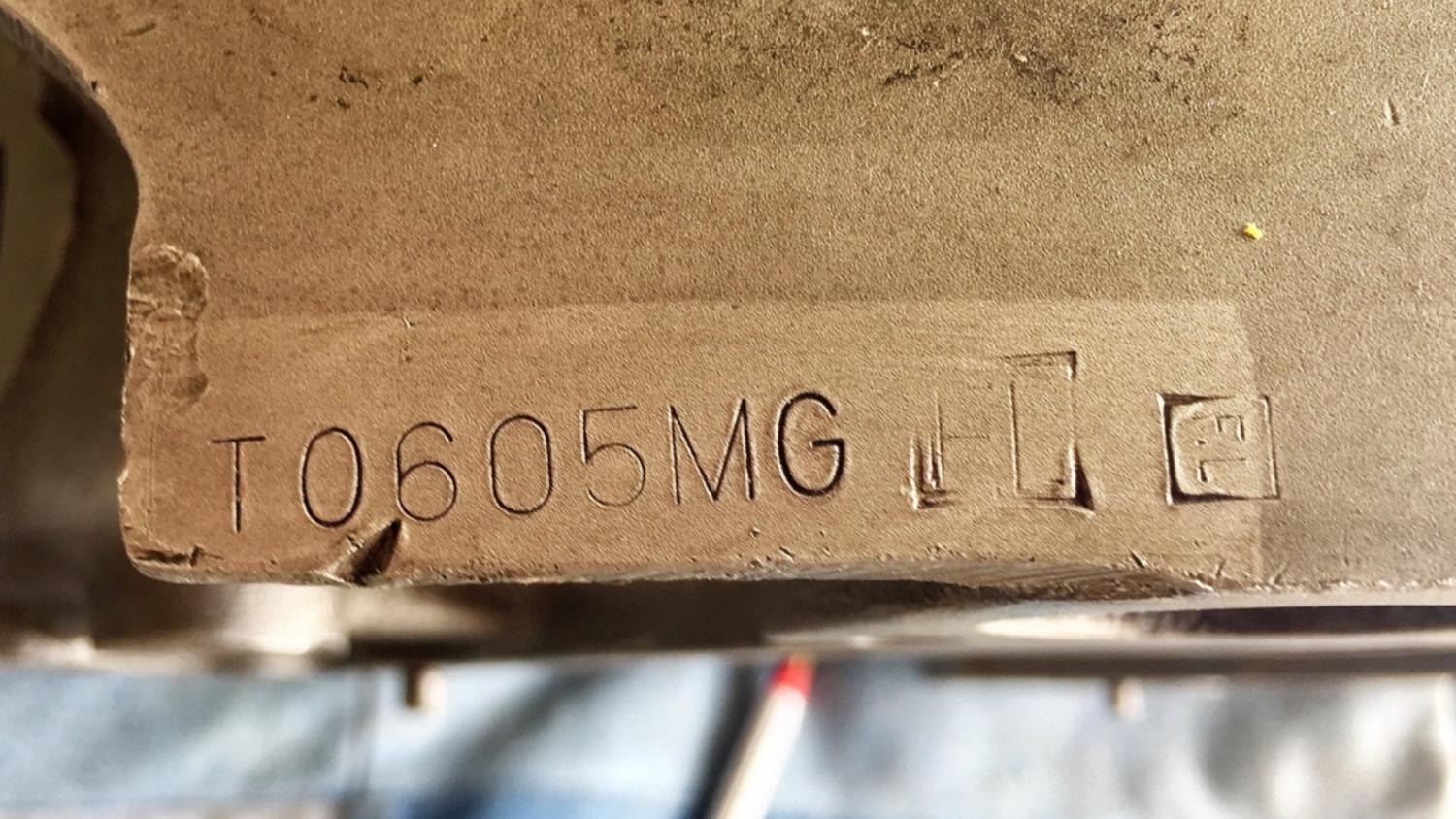

This is a pad from what may have been an experimental ZL1 Corvette Automatic. The MG is the build code for Corvette only automatic transmission. There are remnants of a VIN on the other side of the pad. We're trying to figure out the origin of this block and what it may have been installed in.

What's the little "FL" stamp all about?

Those are inspection marks from what we understand.

FWIW Chevrolet Engineering docs indicate they rebuilt one of the L-88/aluminum cylinder case development engines [ZL-1 option did not exist at the time] re-configured "...for "F" Car Installation." Date is August 19, 1968. The VIN[listed elsewhere] indicated an early production 1969 Camaro. It was not the black and gold show car, built late March at Norwood.
Tim, have you seen this 11/73 LA ad I posted in the Old Newspaper Ads thread a few years back?
Sounds like a possible fit other than stick, where was the block when found?

Pete, would that be the press release ZL1? The block was found in Arizona. It is being rebuilt now as a complete engine. Great add.
