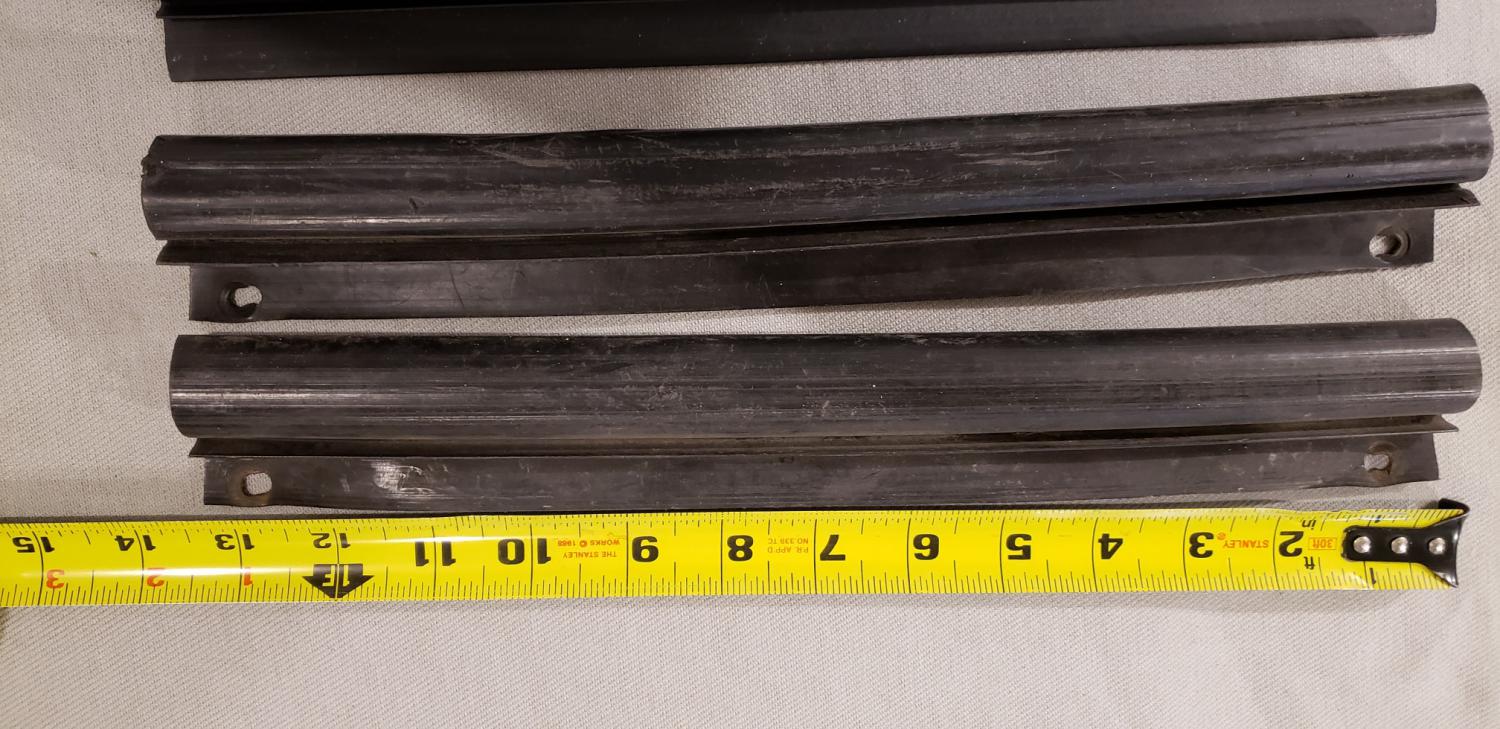

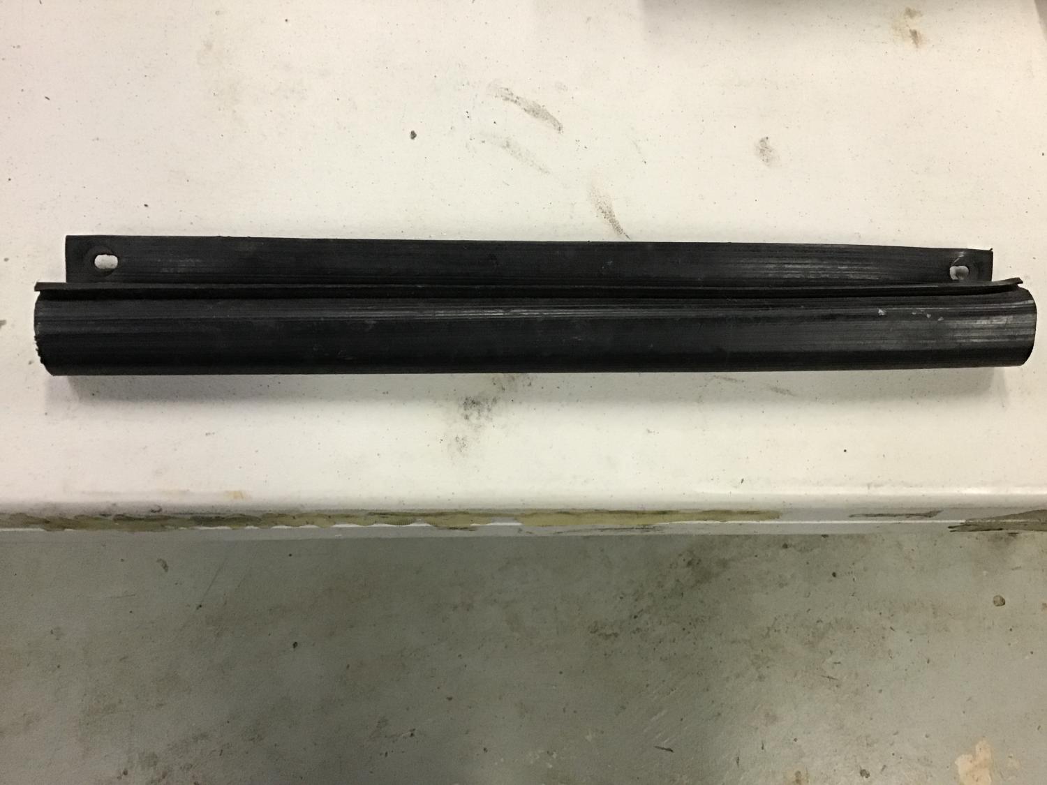

Does anyone know if this wire gutter is GM or reproduction? This one has ribs that run horizontally across the entire gutter. I’m not familiar with these. I tried to include pics of these “ribs”. The gutter is 13 inches long. Thanks

The repros don't have the reinforcing ribs, all smooth. Any numbers or cymbals on the back side ?

Here is a comparison of a repro to originals.

No numbers or cymbals that I can see just thicker reinforcing ribs horizontally where the bolt holes are.

Default Gutter
On the top picture, the far right is a reproduction. The left and center were the originals.

The 13 inch long gutter with ribs from the original post is the factory 69 Camaro gutter.
I think Chevelles also had this same gutter.
