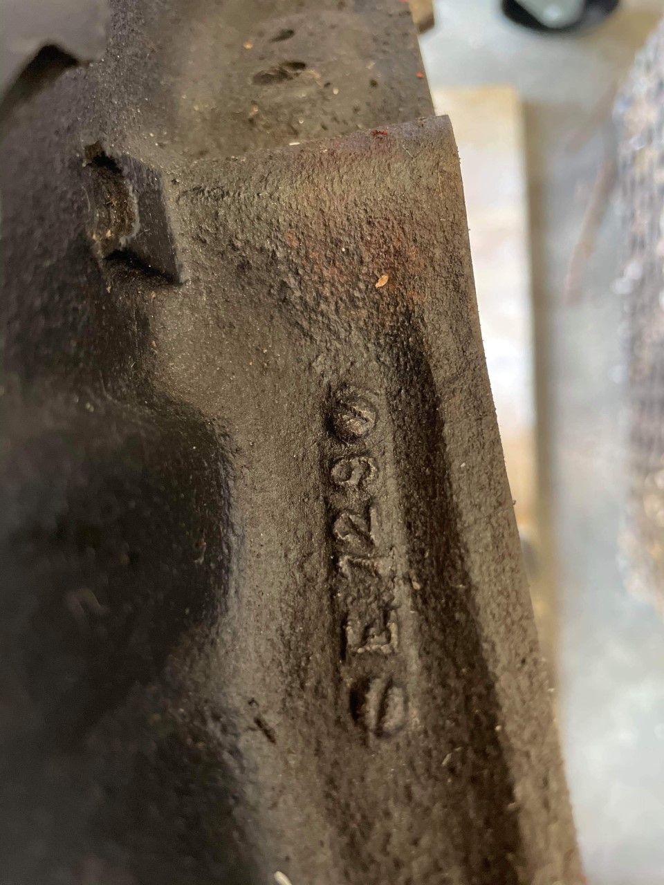

I sold the DZ block that was in my old Camaro to a fellow member, who was able to pull up the serial numbers by the oil filter, which were 19N6 4527.
What do these numbers match, the VIN of a 1969 Z?
Is there any information we can glean from these?

Yes, thats the partial VIN
124379N6x4527 would be the full VIN
What was the stamping on the pad? That could maybe narrow down the VIN possibilities

Thanks Jonesy. The block was decked, so the DZ and the rest on the pad could not be read, unfortunately.

Inserting 0-9 into that VIN would make it land into Feb twice, March once, April once, May once, June twice, August once and Sept twice.

I guess finding the original car would be like a needle in a haystack.

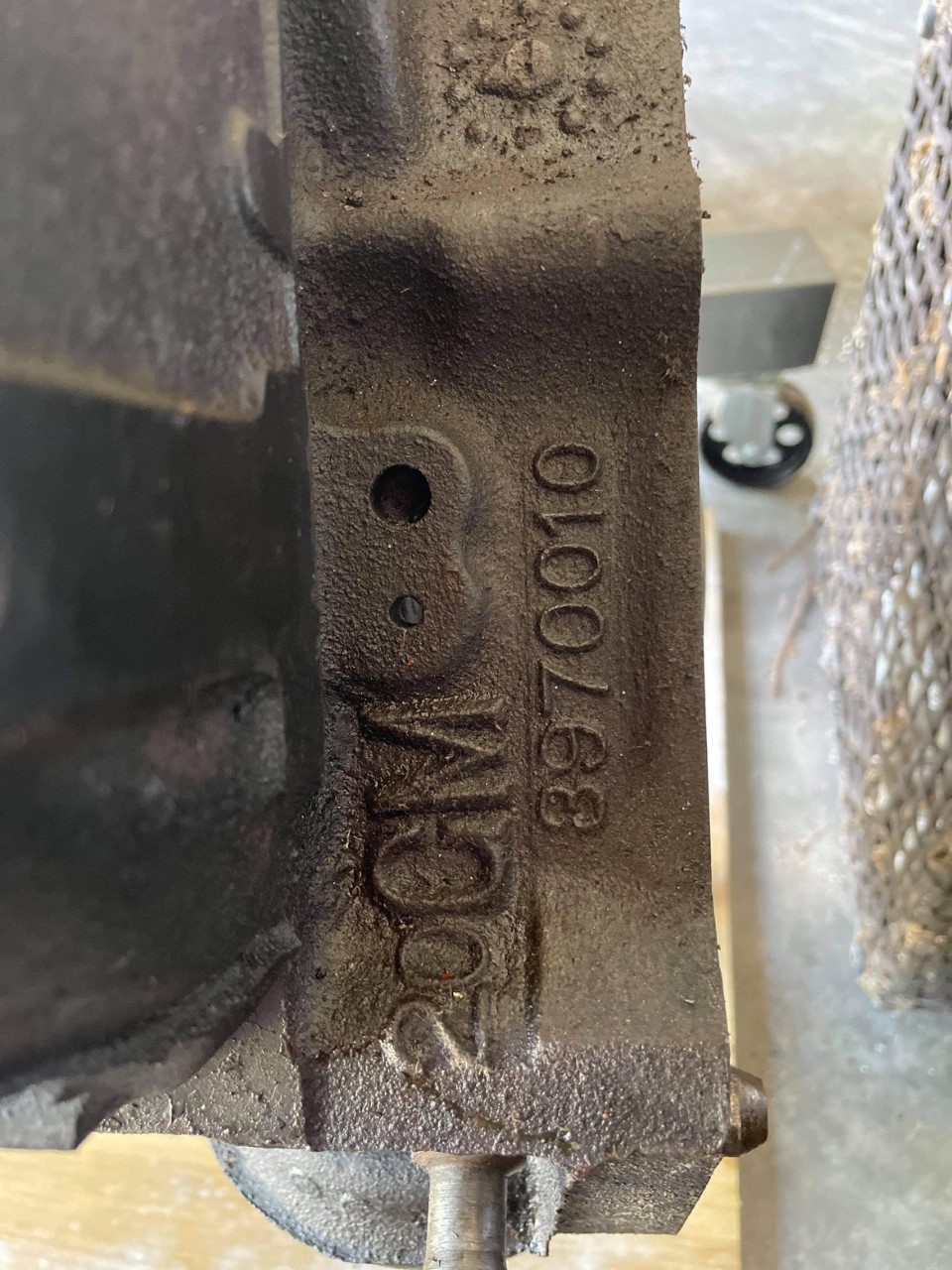

Old 01-01-2022, 07:59 PM
rlw68's Avatar
rlw68 rlw68 is offline
Join Date: Oct 2017
Location: North Carolina
Posts: 352
Thanks: 187
Thanked 276 Times in 116 Posts
What's the casting date?

Old 01-01-2022, 08:35 PM
x77-69z28's Avatar
Join Date: Apr 2008
Posts: 2,153
Thanks: 3,007
That would narrow it down quite a bit!

Old 01-01-2022, 08:48 PM
Jonesy's Avatar
Jonesy Jonesy is offline
Location: Duluth, Minnesota
Posts: 3,129
Thanks: 333
Thanked 788 Times in 493 Posts
Ya, casting date. That could help also.

Old 01-02-2022, 01:07 AM
Location: Naples, FL
Posts: 4,983
Thanks: 23,810
Thanked 2,368 Times in 925 Posts
It's a 39700010 block, and the pad was blank. I used acid from a couple different forensic kits to try to raise it, but nothing showed. Guess it was just cut too far down or the OG stamp wasn't very deep.
