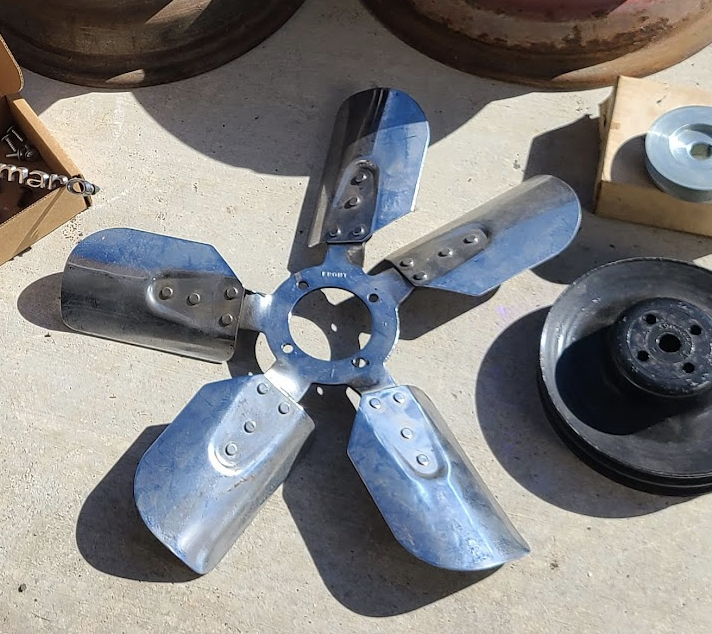

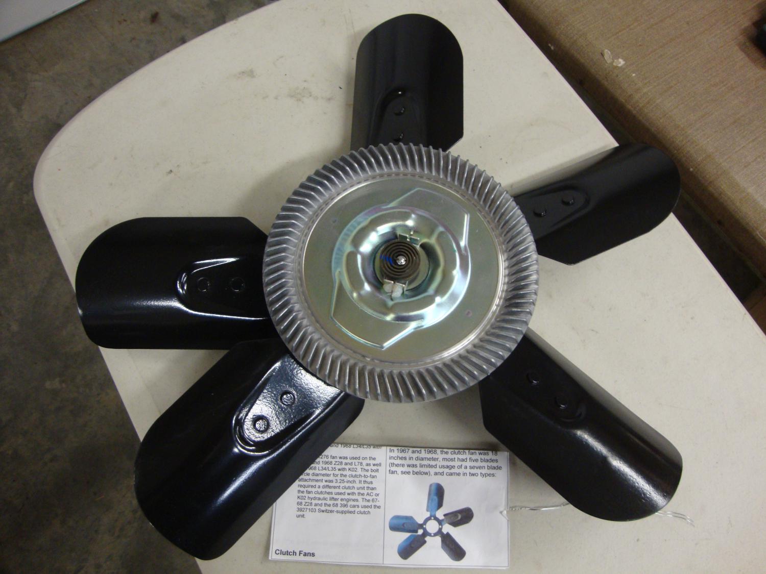

Technical Inquiry:
Looking for a new functional fan clutch that will bolt up to my L78 fan with 3.25" bolt pattern.
Can't afford an original clutch right now but I'd like to run the correct fan.
I can't seem to find one with a 3.25" bolt pattern. Anyone?

I'm going to give Hayden Part 2713 a shot as it does have a 3.25" bolt circle.

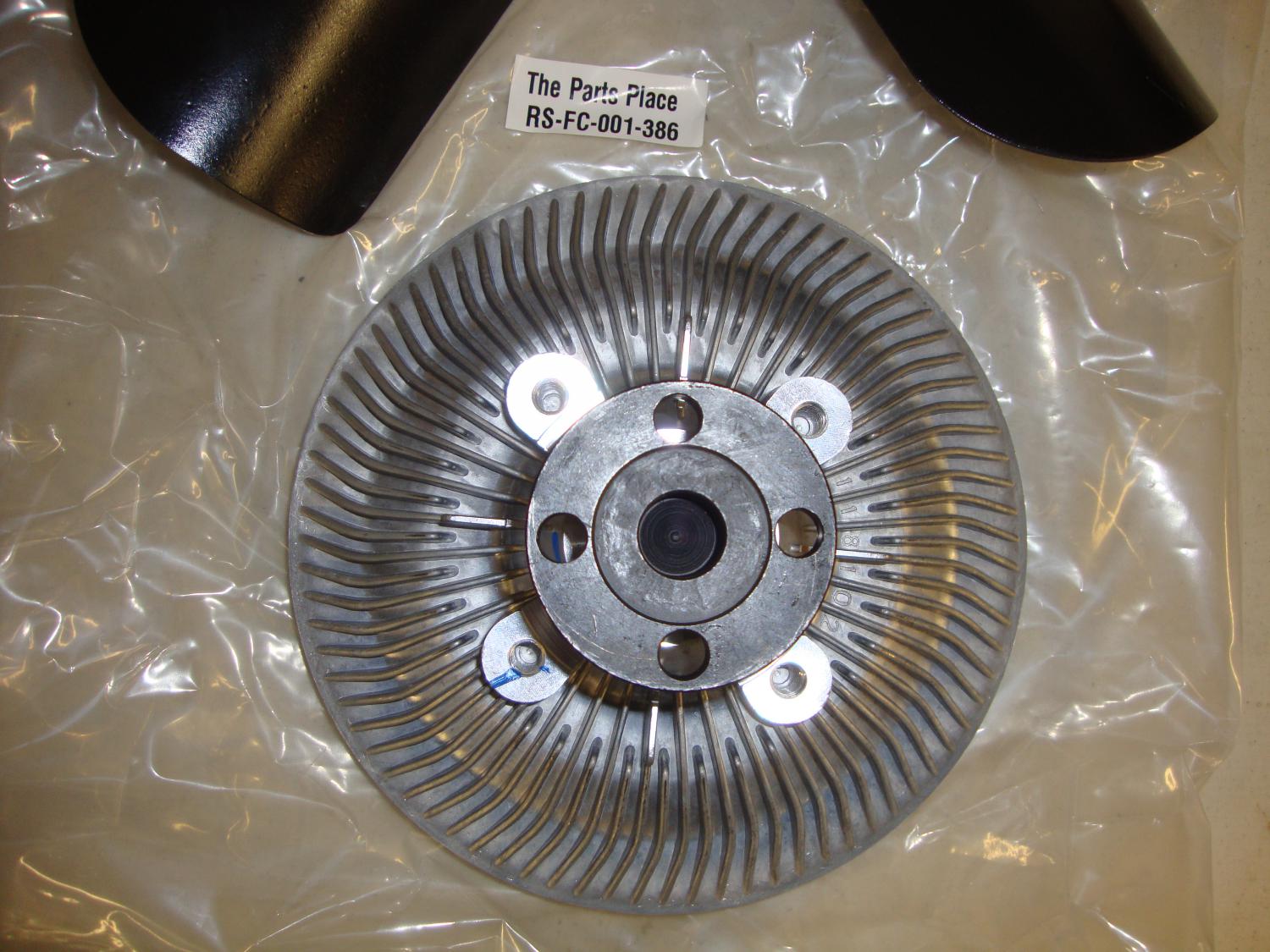

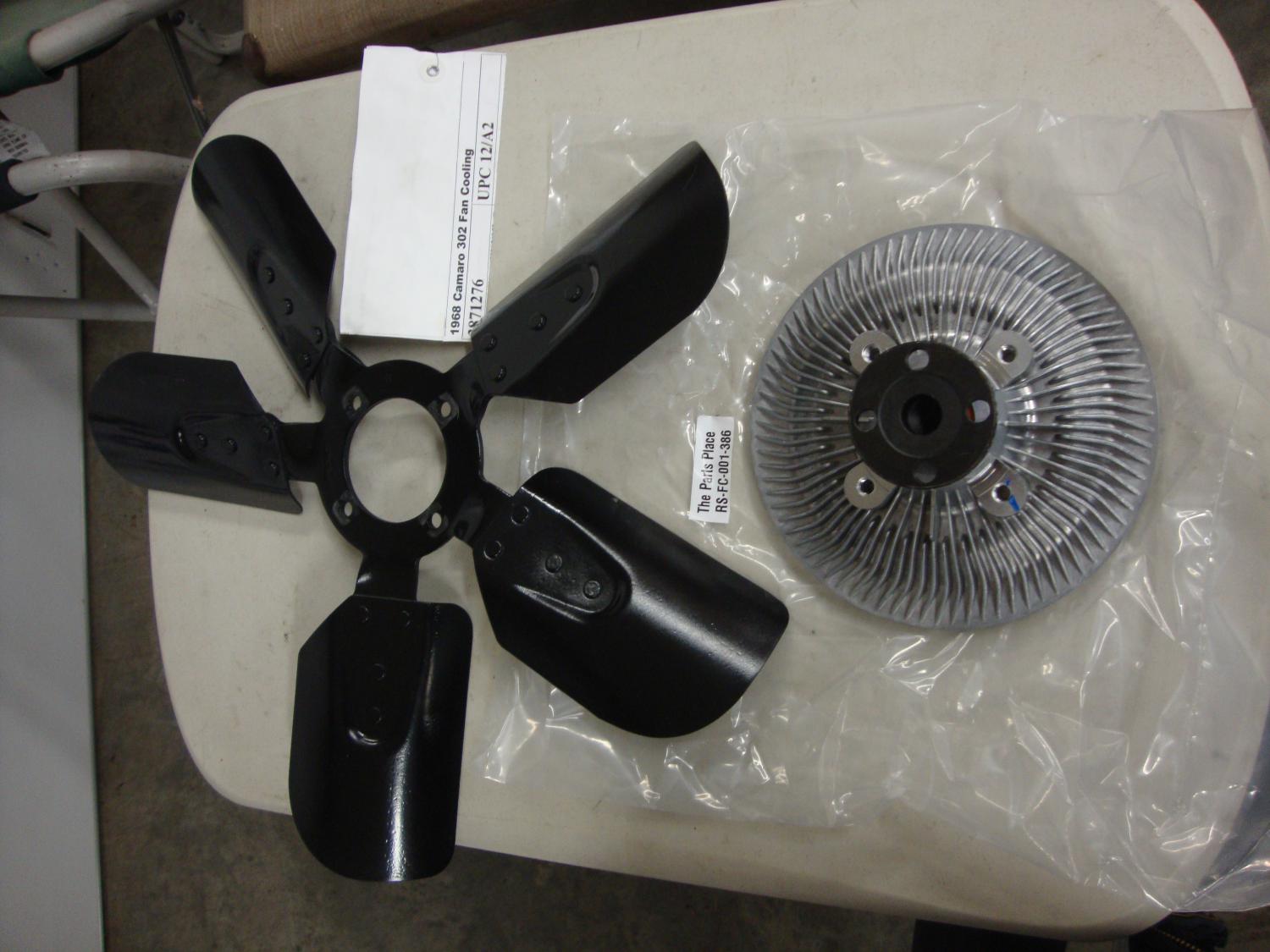

The Part Place
TPP #: CS1386Z

I purchased this and it fits very well & will report how it functions when I lite off and run the motor and car. This is used with a Factory Solid Lifter Fan. While the replacement lacks the appearance of the GM Clutch, it should fit the bill as an economical temporary replacement for those seeking the rare orig clutch.
