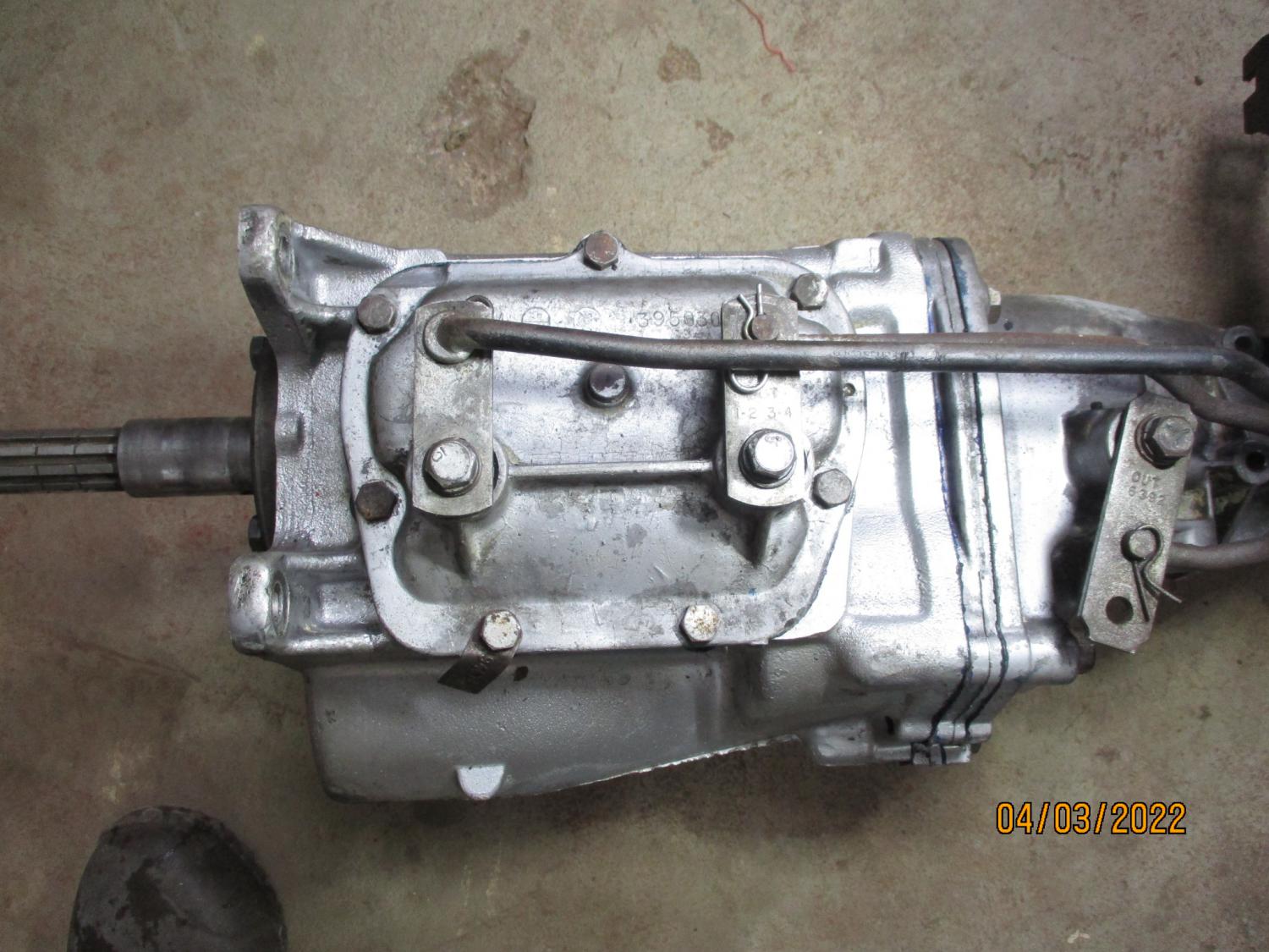

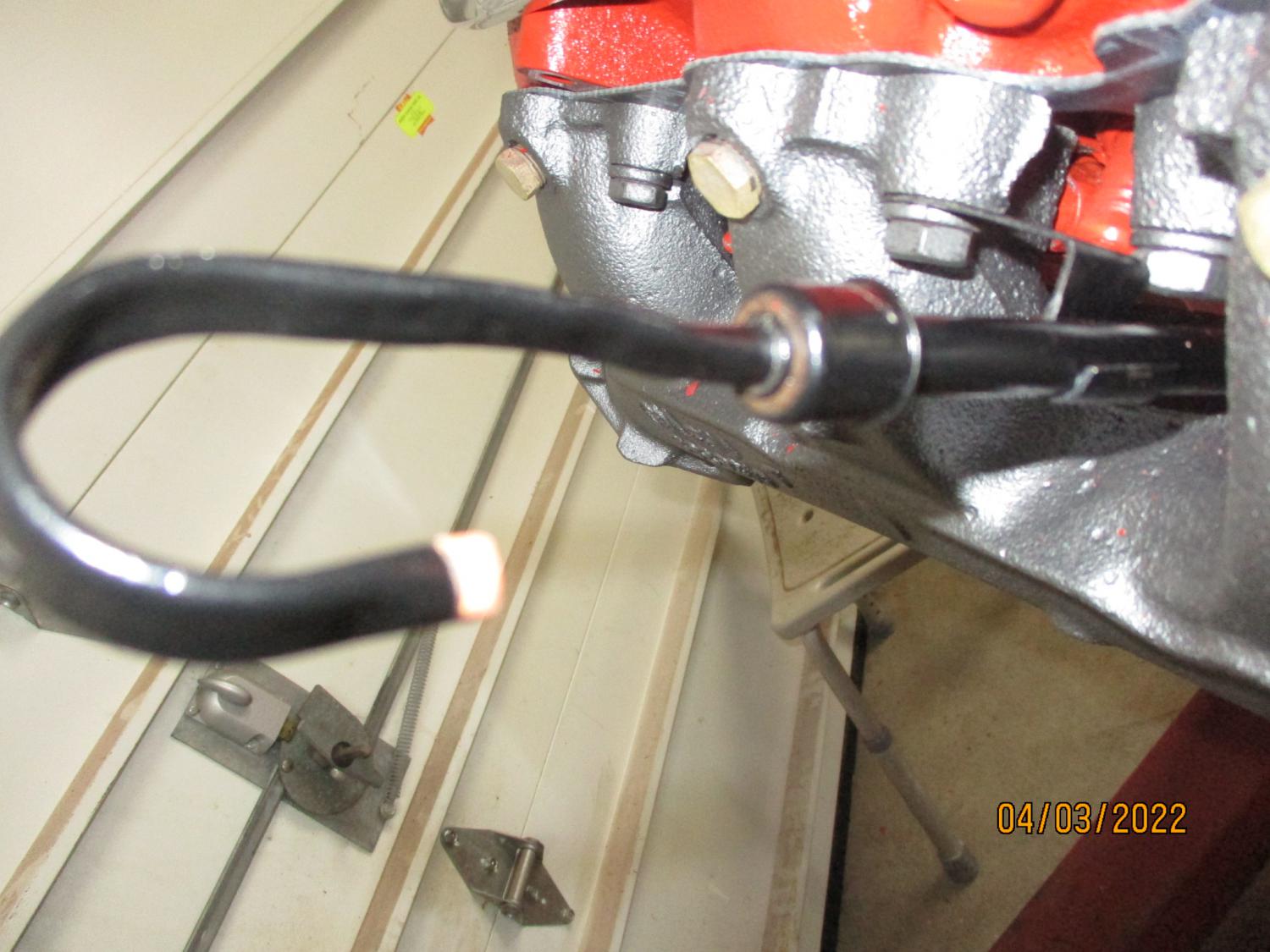

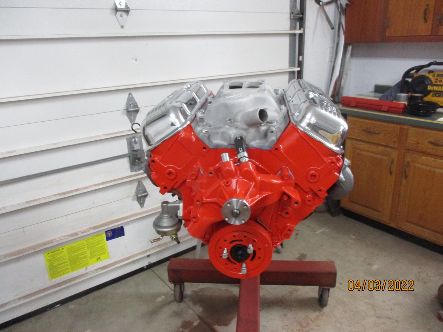

Helping a local car friend with an under the hood 'refresh'...thought I would share a few photos and ask a couple of questions. This is not a 'concours' job...but we are trying to make it look nice. We have had some help from SYC members with parts and advice...much appreciated.
The motor is a base 396/325hp...he added the Motion style valve covers and an Edelbrock performer manifold. Engine has been gone thru...steel chain and gears, roller tip rockers, new water pump, new OEM oil pan, etc.

-what is the correct color for dipstick tube and stick...and does the 325hp have the yellow tip?
-Muncie trans. with Hurst CP shifter...shouldn't there be bushings on the shift levers?
