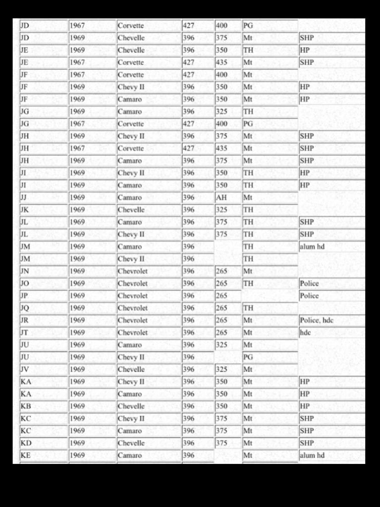

----JH on the pad is a 67 427/435 engine so not original? That roof will be awful under the vinyl. Probably have to be replaced.....Bill S

JH 1969 Chevy II 396 375 Mt SHP
I believe JH is correct for 69 396/375 Nova and Camaro.

Posts: 9,342
Thanks: 32,177
Thanked 4,442 Times in 1,889 Posts
----I wondered weather JH was used on any other combination. Thanks, as I don't have a listing of Nova codes!.....Bill S

Posts: 12,371
Thanks: 18,401
Thanked 5,583 Times in 2,398 Posts
JH Suffix used for both '67 L71 'Vette also '69 L78 Camaro/Nova Stick cars as Nasty site Listing below.
Subject Nova VIN 114279W496465
