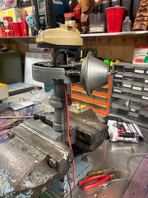

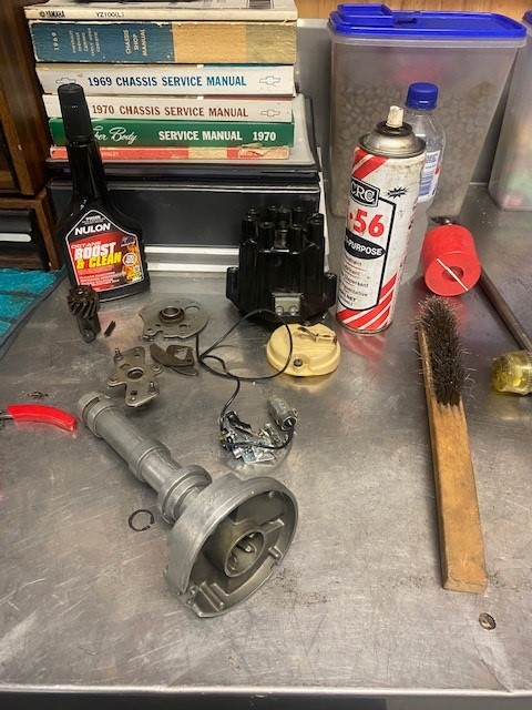

Hi all.
I'm rebuilding a Delco distributor and installing a Pertronix 1181 module at the same time and came across a couple of small issues.
Upon disassembly I found that it was missing the felt washer and oil well seal. I've managed find a felt washer on ebay but am struggling with the oil well seal. Do we know if this is being reproduced?
TIA.
1969 SS 396/350 Chevelle

Old 07-11-2023, 04:32 AM
cheveslakr cheveslakr is offline
Join Date: Oct 2010
Posts: 483
Thanks: 1,046
Thanked 313 Times in 138 Posts
That's nice to know, most are pretty crusty. I think that's the shaft you're using behind the CRC cap? It doesn't have the spiral oil groove that I see on some shafts, but couldn't tell you the rhyme or reason. It also appears to have a bit of wear, or at least a small groove which may not be of any concern.
