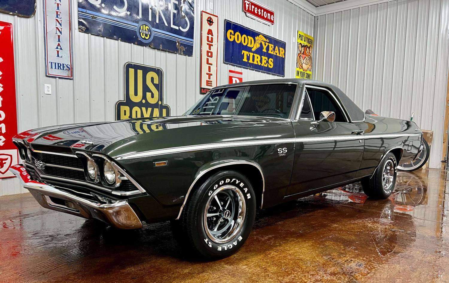

Guys looking at a 1971 El Camino. Guy claims it's an original 454 car. Is there anyway to verify this? It's NOT a Canadian car so that option is out. Just like to know if it is a 1971 SS 454 car, or what it really is.
