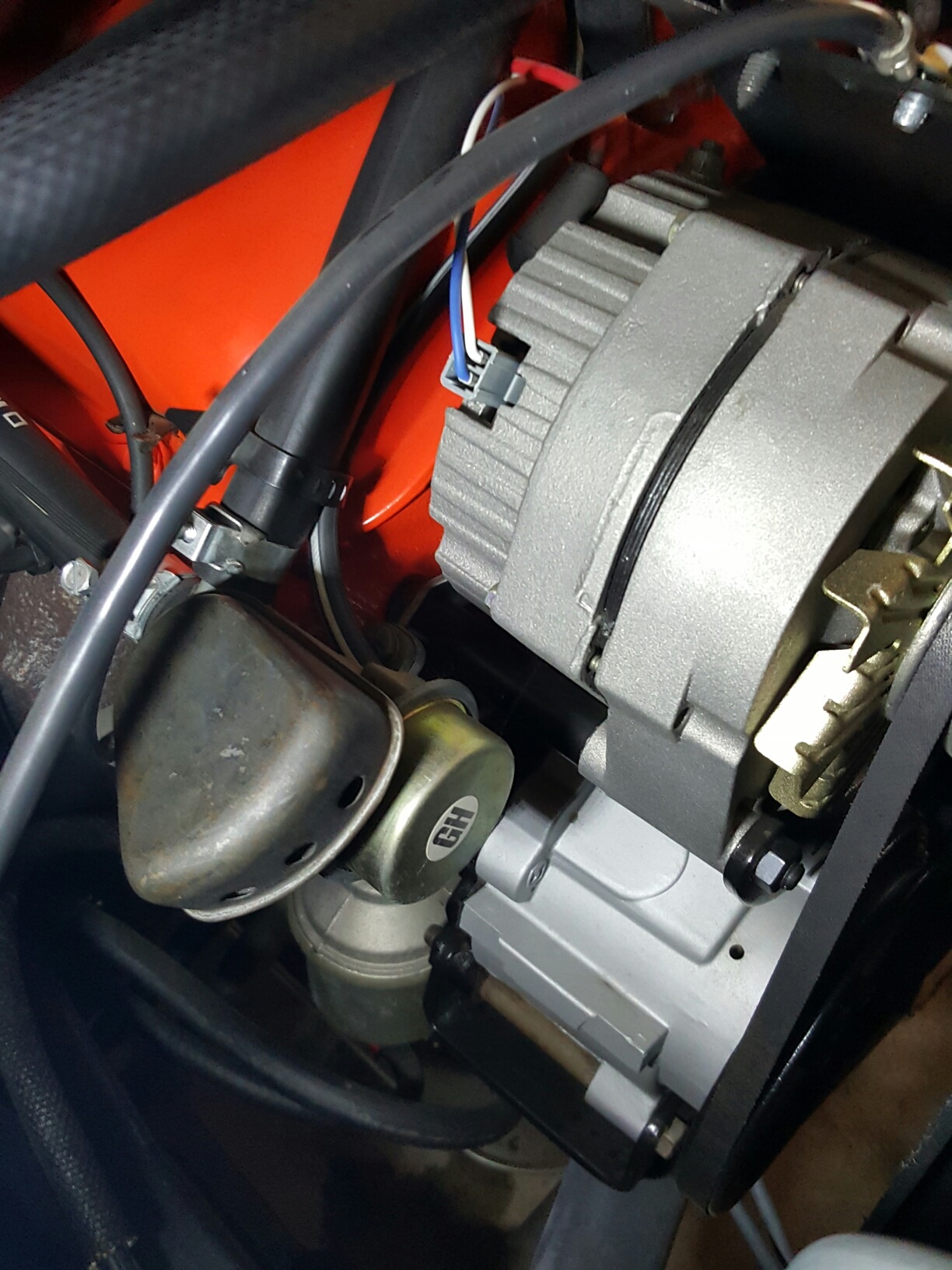

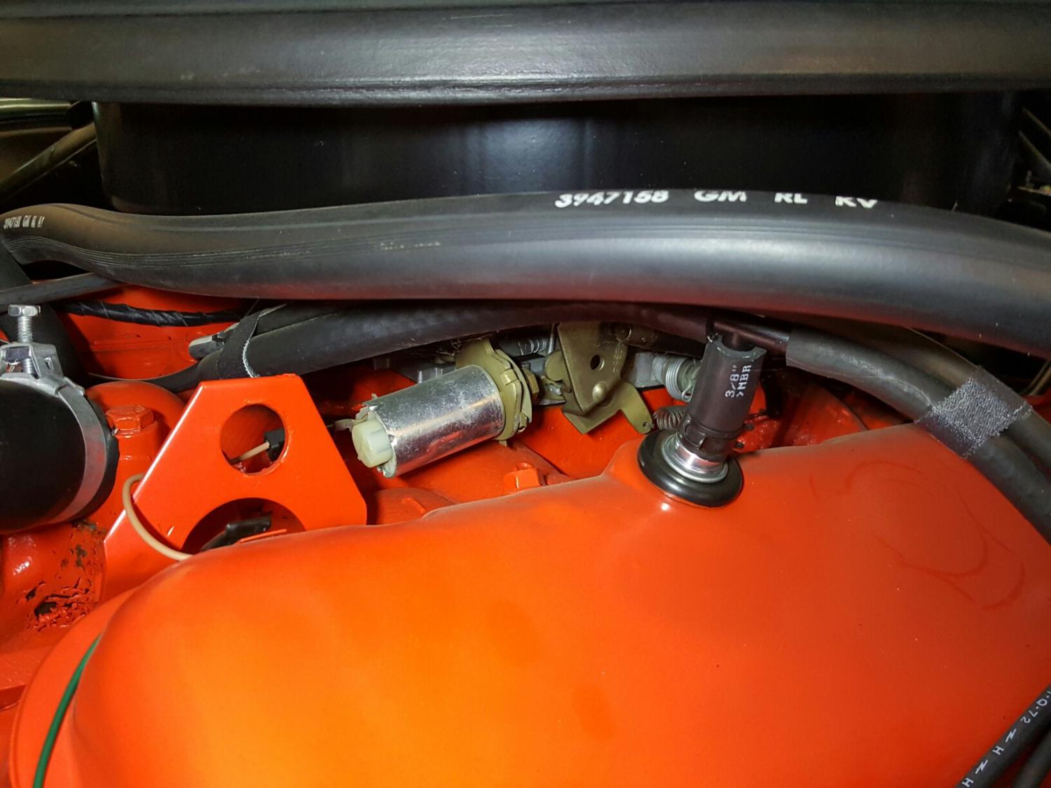

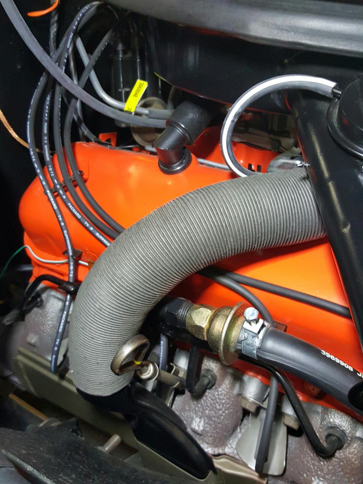

Jake is correct. The valve covers for the 72 U and W codes are the same. They were painted with no decals. Oil plug was push in rubber.
Here are some pics of my old W Code vert.
