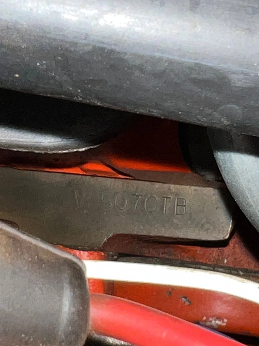

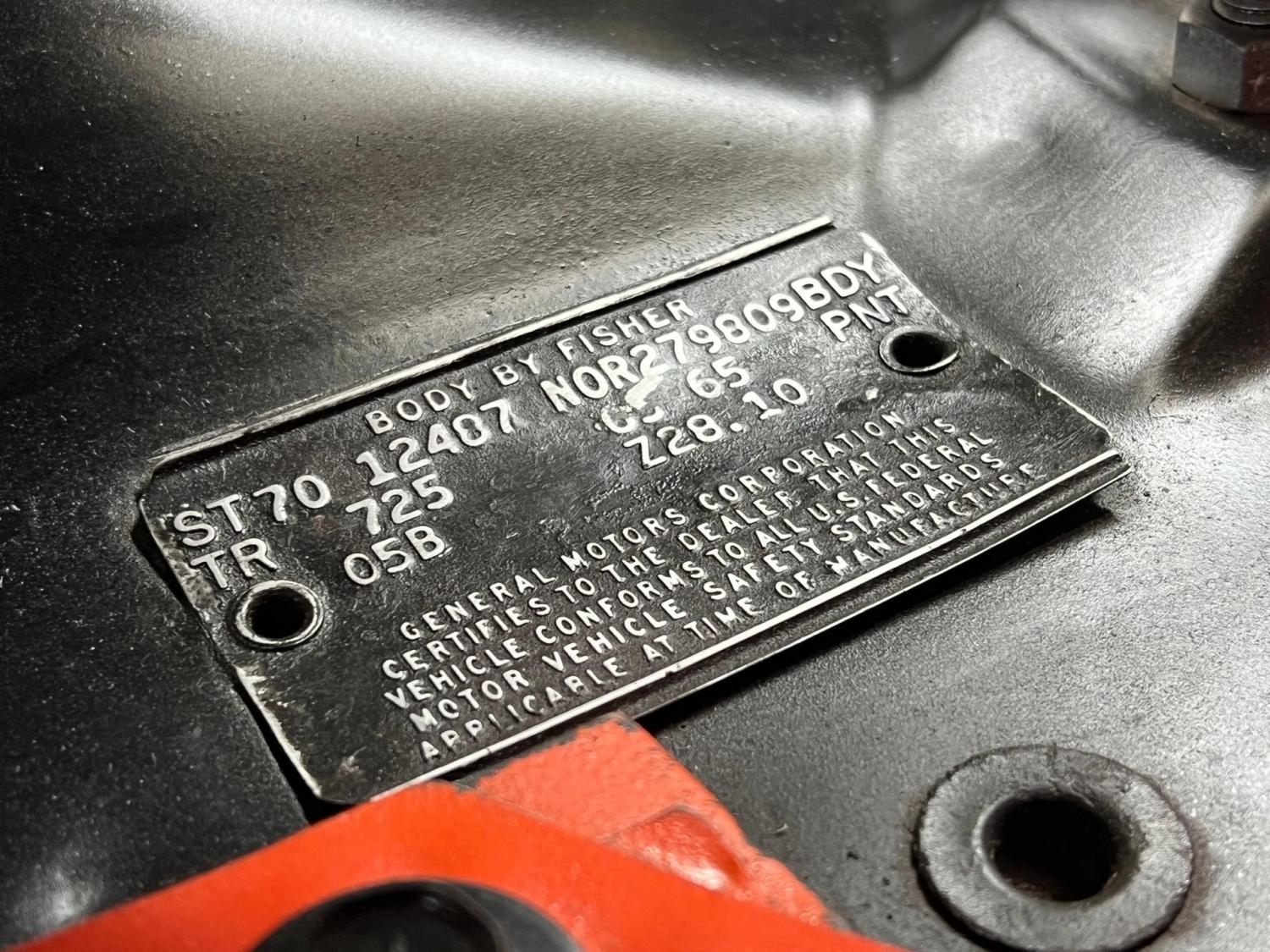

A friend of mine asked me what I thought of the pad stamp, trim tag, and paperwork on this Z/28. I have my opinions and I am curious what everyone else thinks. Opinions?

Hi Jason. I’m not an expert, but I have a CTB block (that I believe is genuine) in the garage and I think the suffix stamp looks different from the one pictured here. The gap in the C and particularly the B… I also agree that it would be unusual to have an OH built car sold new in CA, but I’ve also heard that sometimes that happened with low volume models and maybe even because of the unique build year in 1970.
My block, FYI for the stamp comparison:
https://www.yenko.net/forum/showthread.php?t=174868
Just MHO,
Anthony

Seems kind of suspicious that a car sold into California is missing the mandatory NA9 evap equipment. Does it have it on the car? This probably would not have appeared on the sales form, but pretty sure it would be on the window sticker, which most likely is a fake one. Affirming this is the "Black Cloth Interior". This was only available with the Z87 Deluxe interior option which would have been on the sales order and the window sticker. Looks to be a "made up" window sticker that matches the options the car now has.
The CTB on the engine pad also looks a bit wrong to me, but I'm not an expert on this. My CTB engine suffix looks just like Anthony's. Note the B has equal size top and bottom bumps.

I agree with the suspicions on the block stamp...especially the "B" which appears to be a different font than another known original stamp produced 2 days after the subject block. As for the paperwork, Dave noticed some key items, but in addition, note the date on the top of the hand written retail order. The date at the bottom appears to match the date at the top...but wouldn't the customer have written the date at the bottom when they signed?

If he had sanded any harder on the cowl tag you'd have nothing to go by.
