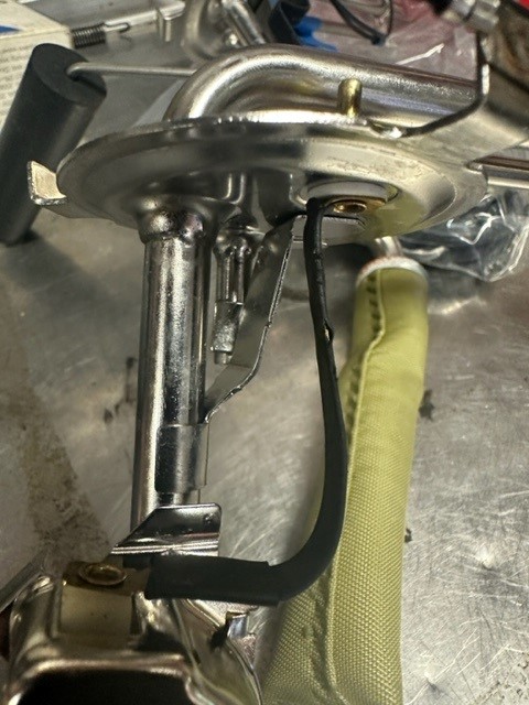

Hi all.
Looking for some advice.
I've had some issues after installing two new senders and their reading.
After installing both senders, the gauge reads with the ignition turned off and then goes to empty with the ignition on.
Everything was fine with the previous sender, it was still working but was corroded so I changed it when I cleaned out the tank.
TIA.
1969 SS 396/350 Chevelle

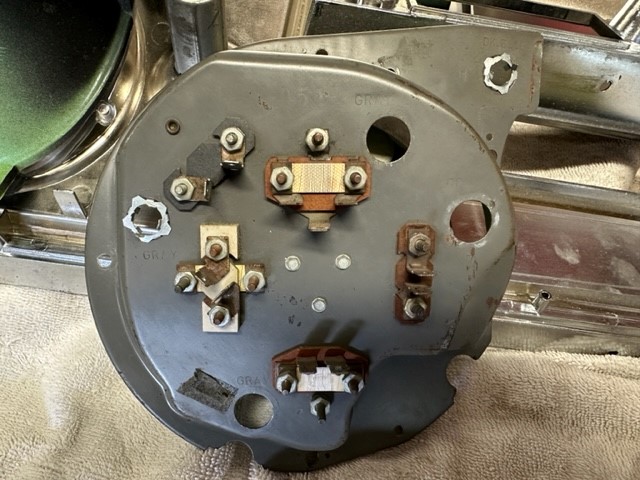

Had the same issue with my 71 Nova ... check the instrument cluster/fuel gauge ground.

Well, pulled the gauge cluster out and bench tested the fuel gauge and sender and everything seems to be working so I'm at a bit of a loss.
The resistor on the rear of the fuel gauge is obviously ok as well given everything is working.

If the gauge reads empty with the key on and there is gas in the tank, then the tan wire is somehow grounded or pinched is my guess. Try unhooking the tan from the harness and with the key on, see where it reads. Then using a jumper wire ground the tan wire and repeat the test. The fact that both senders read the same can pretty much rule out the senders as being the issue. Make sure you reattached the sender ground to the body up above the rear differential. That could be a problem.

The problem surrounds the sender being fitted in the tank and not wanting to work as I have connected 2 new and one old senders which all worked whilst connected into the cars system but outside the tank, but once installed in the tank, only the crusty old sender works. Needless to say that sender stayed in the tank. I thought the new senders may have been grounding out in the tank somehow when fitted, so I played around with the power strap off the sender to make sure it wasn't touching anything but it didn't seem to make any difference. Anyhoo, the crusty old sender stays in for now and I will look to find another OEM sender that I can have rebuilt to install at a later date.

I am having this same issue in my Chevelle - installed new tank and sender last night to replace cursty but working original units. Tested new sender prior to install. Hooked up power wire to sender then hooked up ground, moved the float up and down and the gauge in the car worked as it should. Installed everything and put 5 gallons of gas in car and the gauge reads empty. If I disconnect the power lead to the sender the gauge reads full. I had to drill a new ground as the new sender wire was too short to make the old location work, thinking that might be the problem. Ran out of time and will try again this weekend......ugh.

I had to drill a new ground as the new sender wire was too short to make the old location work...
I experienced the same thing 15 years ago when I got a repro sending unit for my old 69 SS396 convertible. They make all the rest of the sending unit correctly and then 'cheap out' by making the ground wire a few inches too short! When I called whomever I bought the repro sending unit from, they claimed they had no complaints from anyone else on that issue, which I found hard to believe. Solved the problem by returning the repro unit and sending my original to John Wolf in Ohio, who correctly restored my original sending unit.
