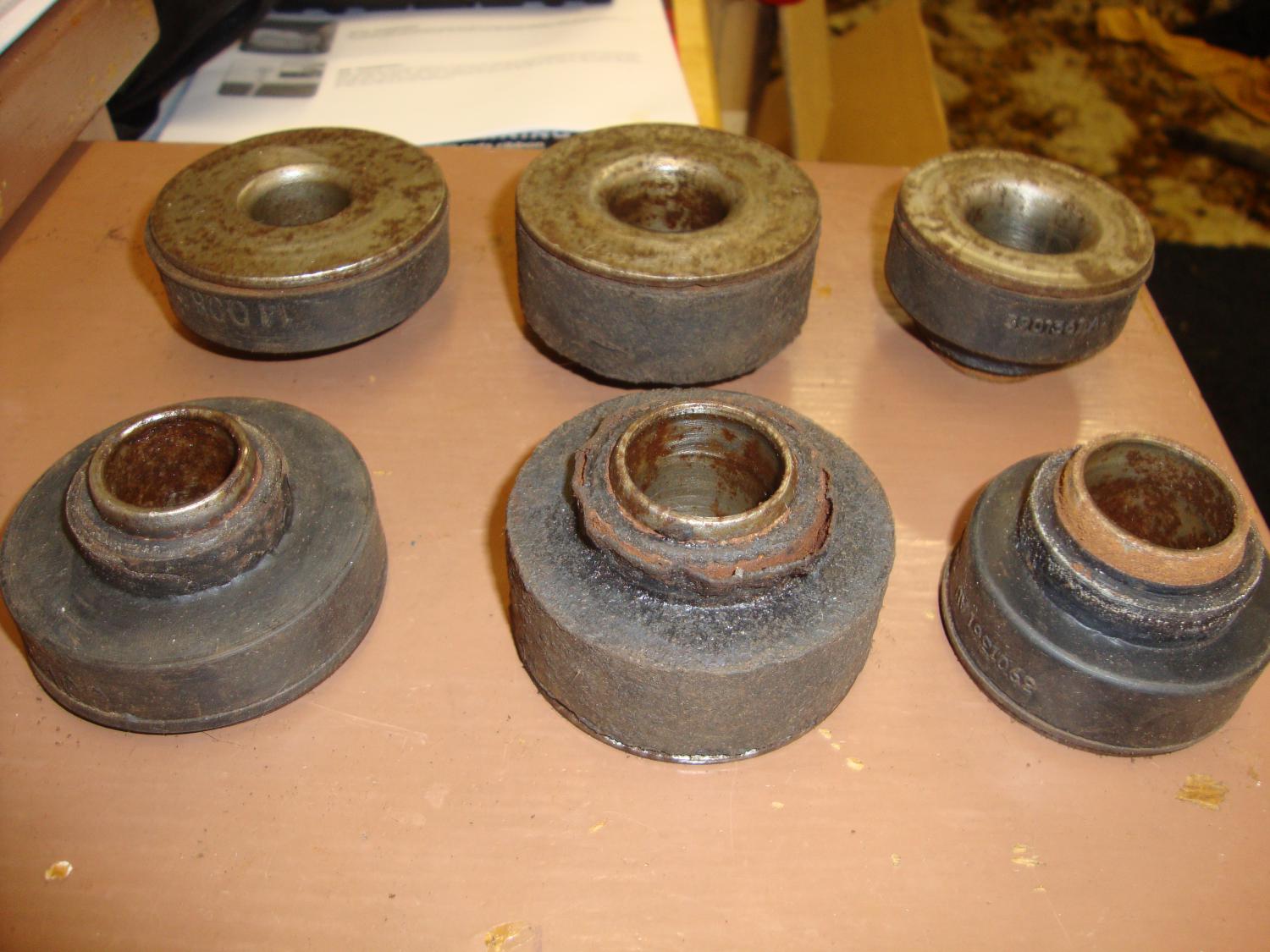

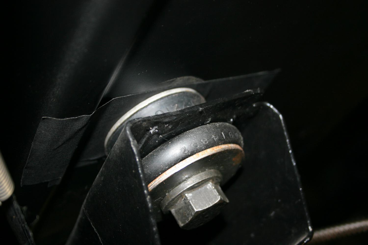

is it possible to replace the bushings without dropping the complete sub frame car was restored with aftermarket bushings but i found a nos set

Yes, I've done it back years ago. support car carefully by the rockers then use floor jack to lower sub enough to swap the bushings.

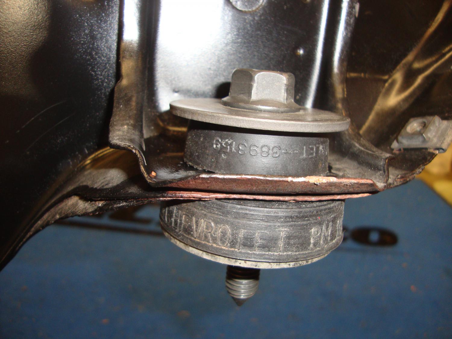

Default 1968 Swap import Bushings for NORS GM parts
Done
Mine No Motor,
One side at a time, Front end loose A partial Project car.
Loosening Fuel and brake lines clips/retainers.
Jack body at rocker to gain separation distance.
69 Los Z11
68 SS/RS 396/325
68 Los Z28
