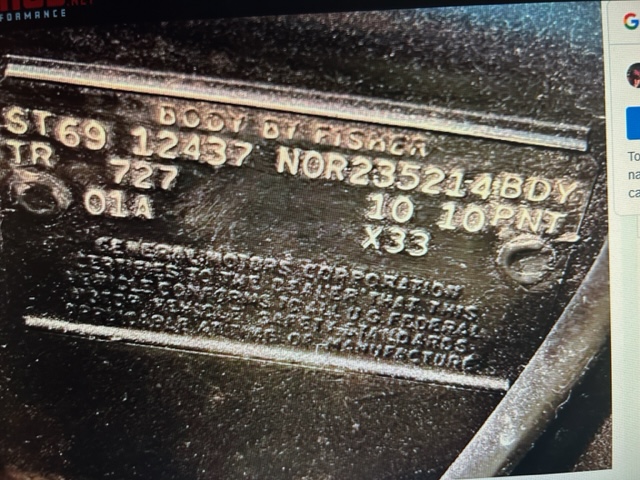

Would like to hear from Kurt S and Jonesy on the trim tag.
I can tell the old ones (pre 2007) from TrimTags.com, but not so good on the newer ones.
What do you guys think?
https://bringatrailer.com/listing/19...maro-z-28-157/
I know there are a lot of things wrong. Engine is too late for a 01A car. Rear stripes are closer to 68 spacing than 69. Not likely a ducted hood car originally, etc.

That car has been flagged as a fake and the owner will not accept what Kurt has told him, fake trim tag....

I have seen this tag before and that is a reproduction tag.

Other issues
White headliner and white sunshades were never on a 69 Camaro
Short window crank handles In back. Crank handle knobs should be clear
Wood grain dash not available with standard interior
Ugly repop Headrest covers

So much wrong with this Camaro.
Reproduction tag.

VIN 124379N570274 for future reference

Interesting the seller didnt post the block stamp pictures that are on camaros.net. Not sure there is any original parts on the car with the restamp block, fake tag and 5 leaf springs.
