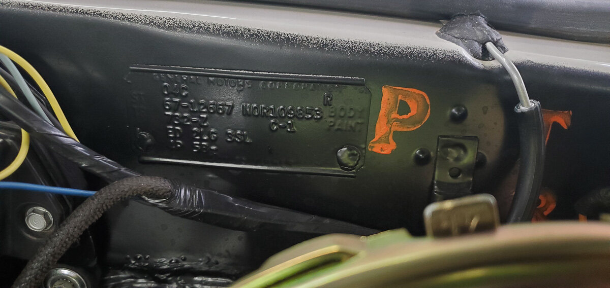

... Has anyone checked out the Cowl Tag on the 1967 Camaro Indy Pace Car at Heartbeat City ?
... check their website.
... Am I reading that correctly ?
... 04C
... 4P
... What do you guys know about this car ?

Doesn’t seem to have a fleet code for a pace car?

From HB City website:

Maybe the dash is the fleet code? Usually it’s 1118. Maybe Charlie can chime in with a pic of the cowl tag from the Dan young pace car he owned. This car was probably built the same week as the young car.

Dan young car was built 03c so I was off a month on the heartbeat car build.

... Here is the cowl tag on my 1967 Camaro SS396/375 car.

I forget when they started putting 4K on the cowl.

Lots of 67 IPC's just have the dash and not the full F&SO code on the tag.
1 of 3?? I know of over 20 L78 IPC's.
Not the original block.

And he wants $600,000?
