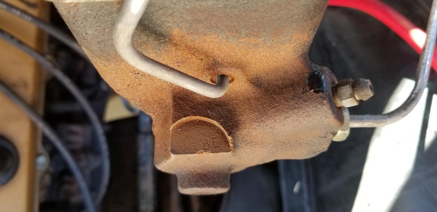

I thought a list of the different master cylinder codes could be helpful. The codes appear in the 68 and newer Buick, Pontiac, and Chevrolet chassis service manuals. Anyone able to add the Oldsmobile codes (section 5 of the manual) or the 1970 Chevy?
I kept the list short and simple, so there may be more info in the service manual.

Kurt - "EB" is the code for 1970 Camaro with power brakes...assume it's the same for Firebird as well.

Added.
Can you see if there is a table of 1970 master cylinders in the 1970 Chevy chassis service manual? In the 69 book, it's on page 5-16.
It's not in the 1971 manual, btw.
The 70 Pontiac table had many empty rows - it was not complete. Confirmed via another source that 70-71 Firebird was EB.
Thanks!

I have 1972 Chevy Nova SS Master Cylinder with a OX stamping. Anyone know much about this stamping?

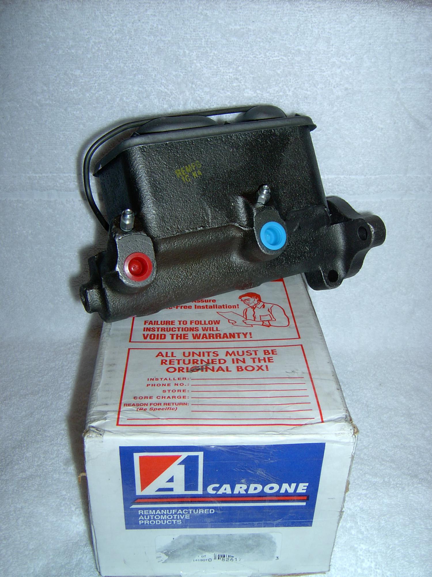

I have a rebuilt 409 BE

I believe BE is 1972 Chevelle w PDB
Could also have other applications.

BE has also been listed as 70+ full-size and I think it had many applications in the early 70's.

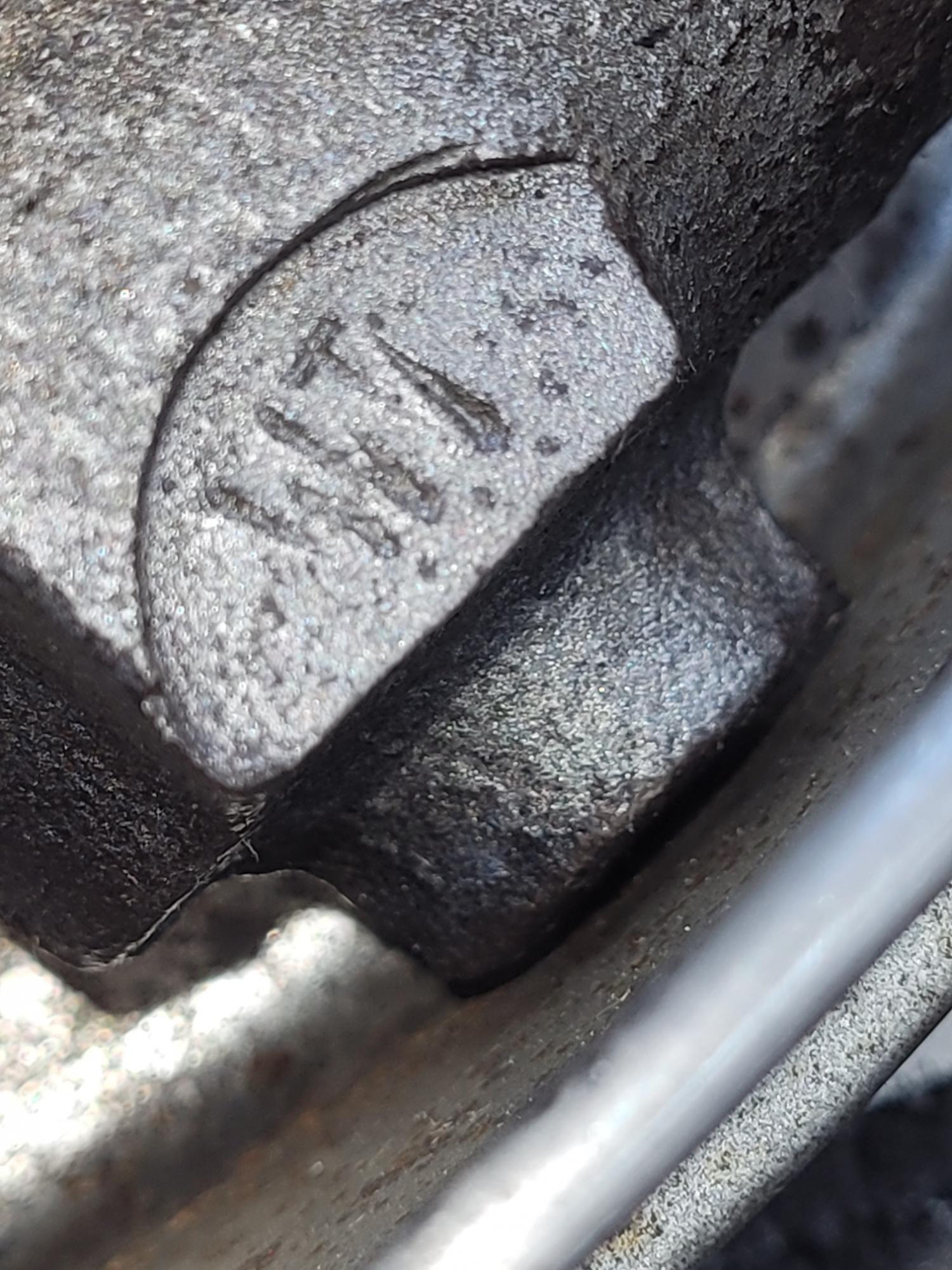

UT code for a 70 Nova if anyone wants to know.

Rebuilt BE "409"
