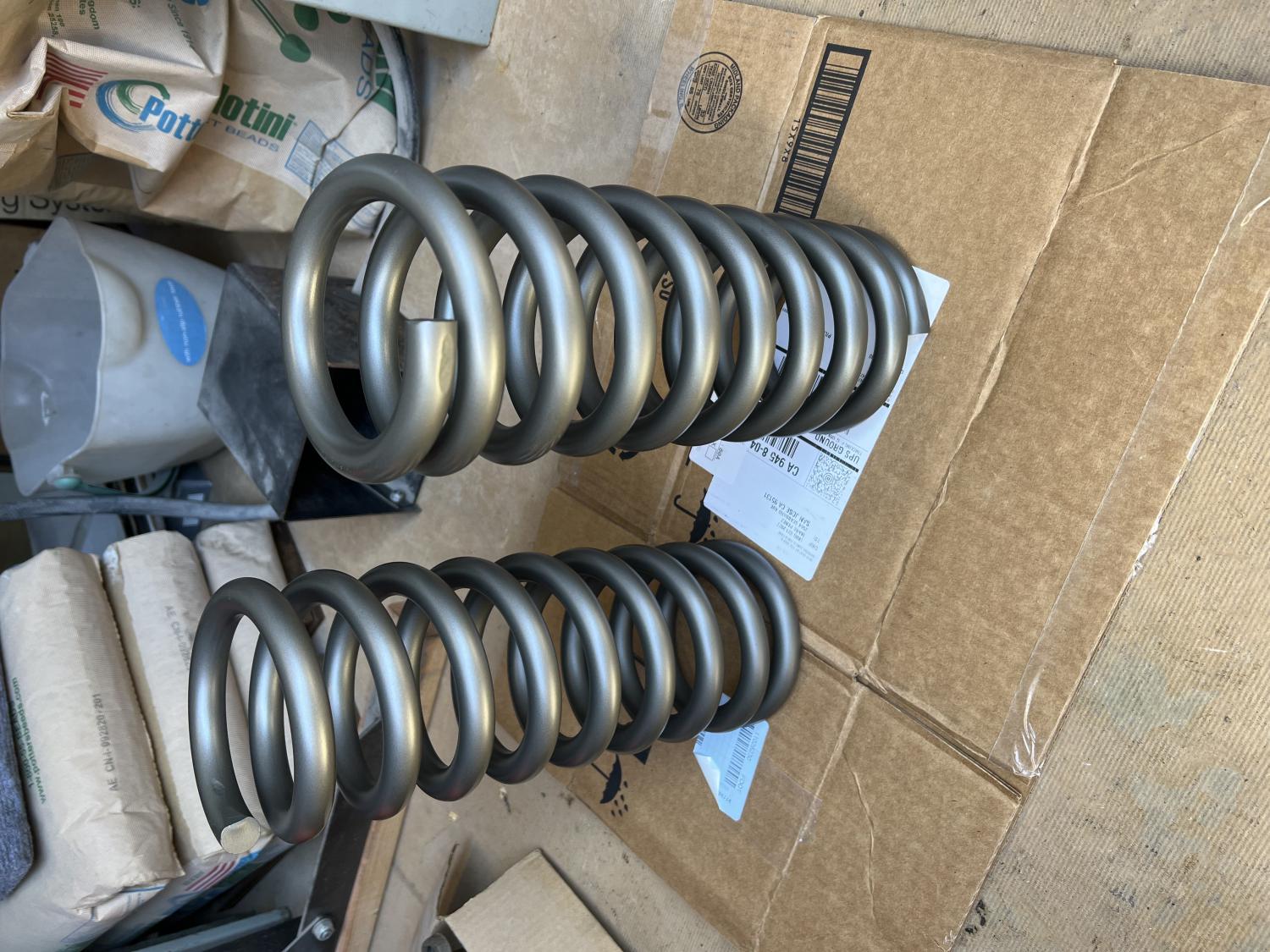

Steve, I worked with Kevin at Coil Spring Specialties last year on a custom set of front coil springs. I first ordered in the spec recommended by Wayne D Guinn which brought my front fenders down to about 25 3/8”, measured from the center of the fender trim. I wanted lower to sit level with the rears so I ordered a second adjusted set that got me to 24 3/8”. I bet you can ask Kevin for the spec that Matt from California ordered last year. Or if you want 25 3/8” I’ve still got those in a box. Here are a few photos of ride height on 215/65 BFGs. DM me if you need any more details.
Thank you to Motorhead848 for refinishing and installing them

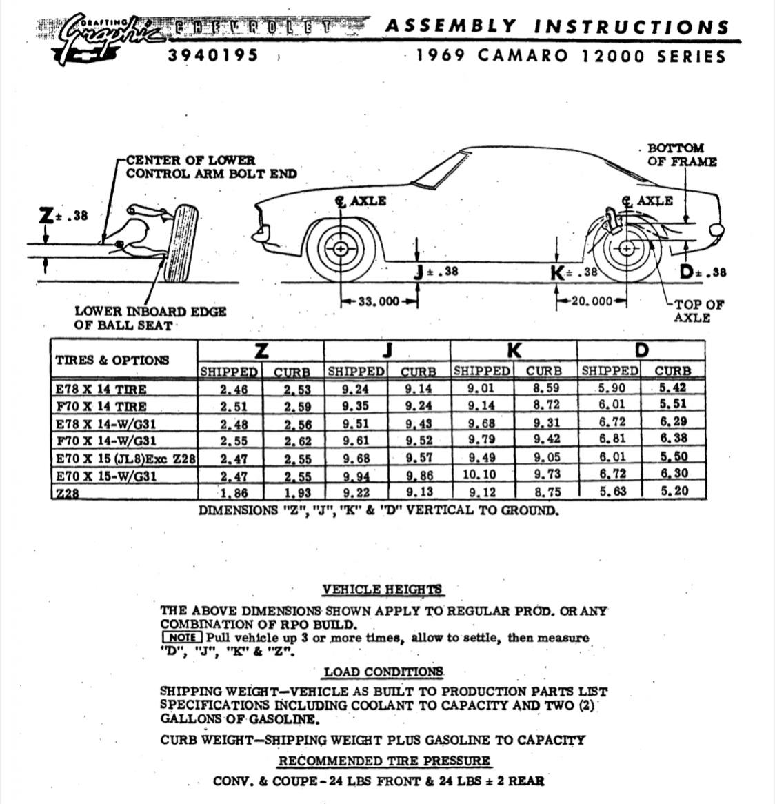

what is the recommended ride height - using stock spring and stock bias tires?

Eddie, here’s the page in the AIM about ride height. I’ll have to measure from those locations and compare, but certainly the look I prefer is level and with the tires slightly tucked into the fenders. I like to think GM Styling would agree
I should also say that my springs from Coil Spring Specialties are 507 lbs/in, which is stiffer than stock. The front feels very planted in cornering without a compromise in ride quality
