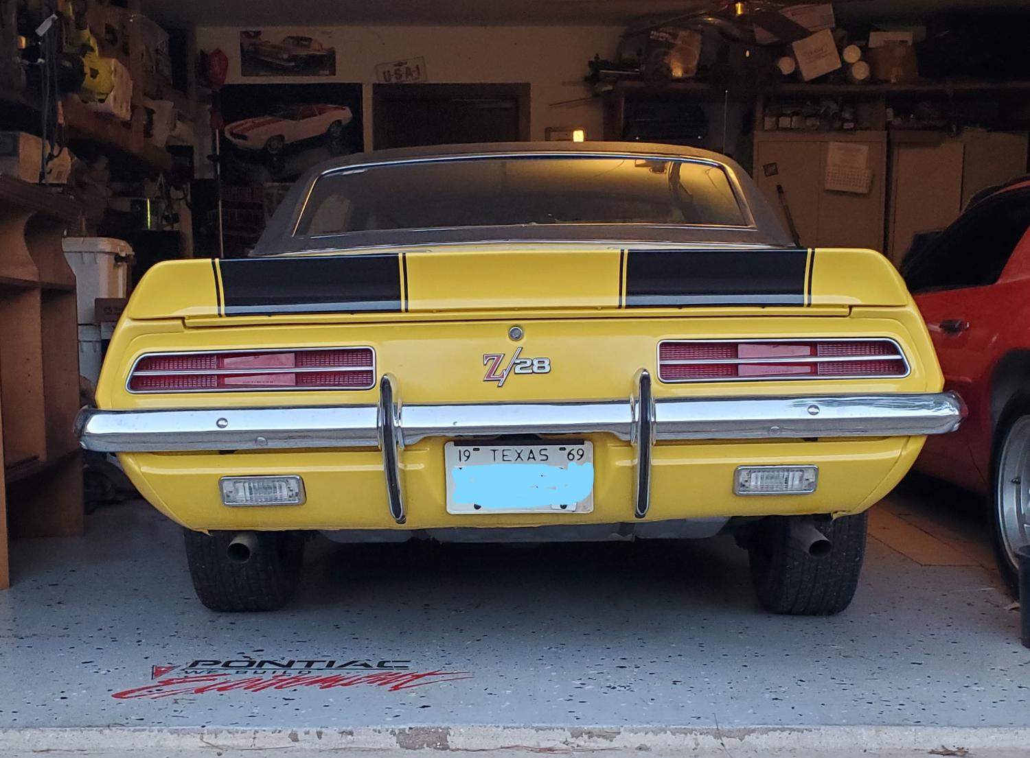

Steves thread on coils was close but I'm having a rear leaf issue I believe I think this pic says it all. Rear Leafs were replaced with repro Z springs from Camaro specialties 15+ years ago. I took some rough measurements of LR= 24.5" RR= 26 ". Now front coils? no idea if ever replaced or not but its the back that's noticeable most I do have a new set of the Moog 6308 springs and I'm not sure where to start - replace fronts and retest my thought if its the same would be to swap rears from side to side? One thing I did notice is why I can see more of the right side of the gas tank VS the left. Maybe this a body issue?
