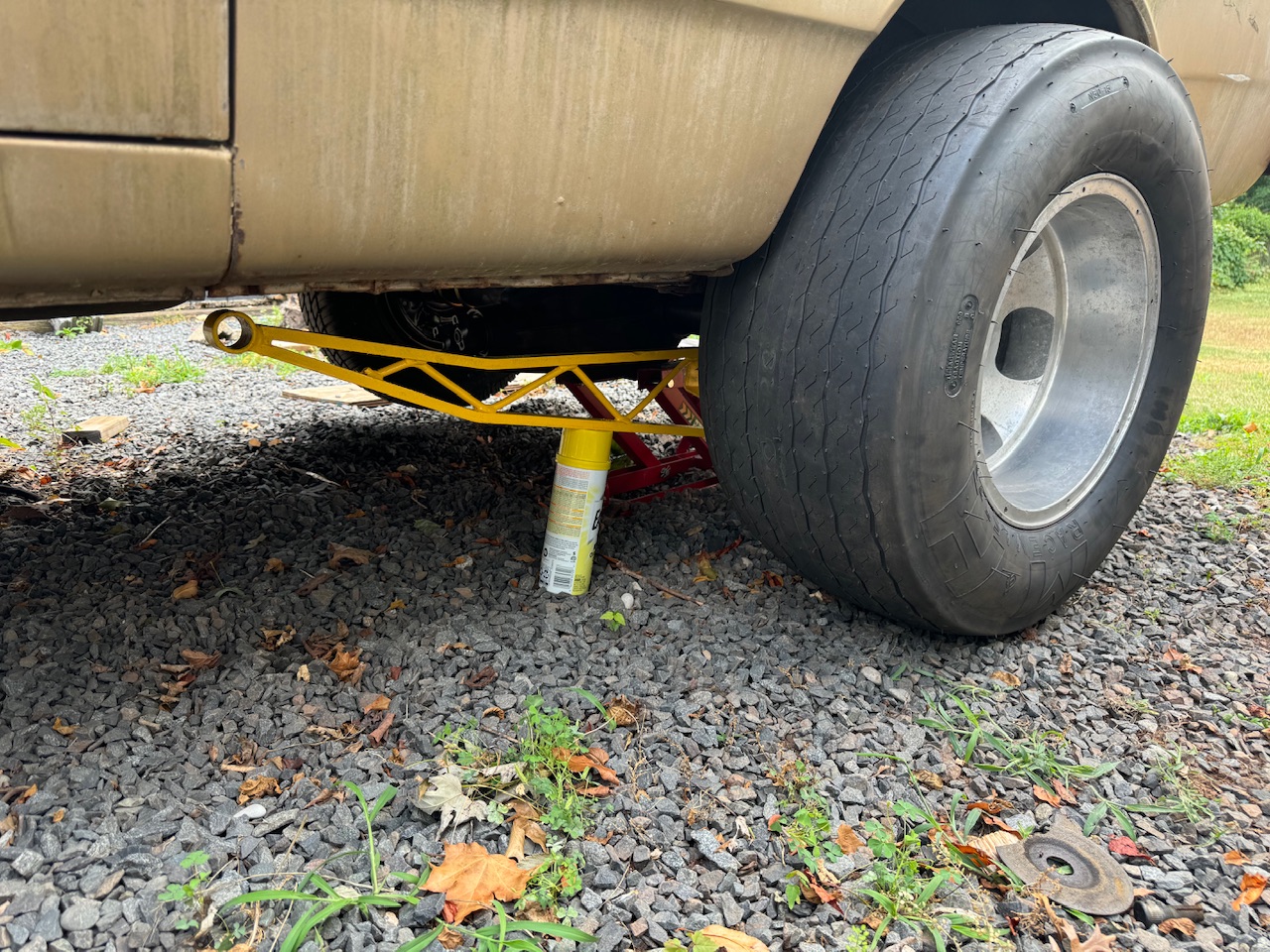

GM A body Lakewood ladder bars and N50’s on 15x10 slot mags look good. I think it’ll fit the era I’m going for. Now I wish I could find a used GMC 671 blower to rebuild.
