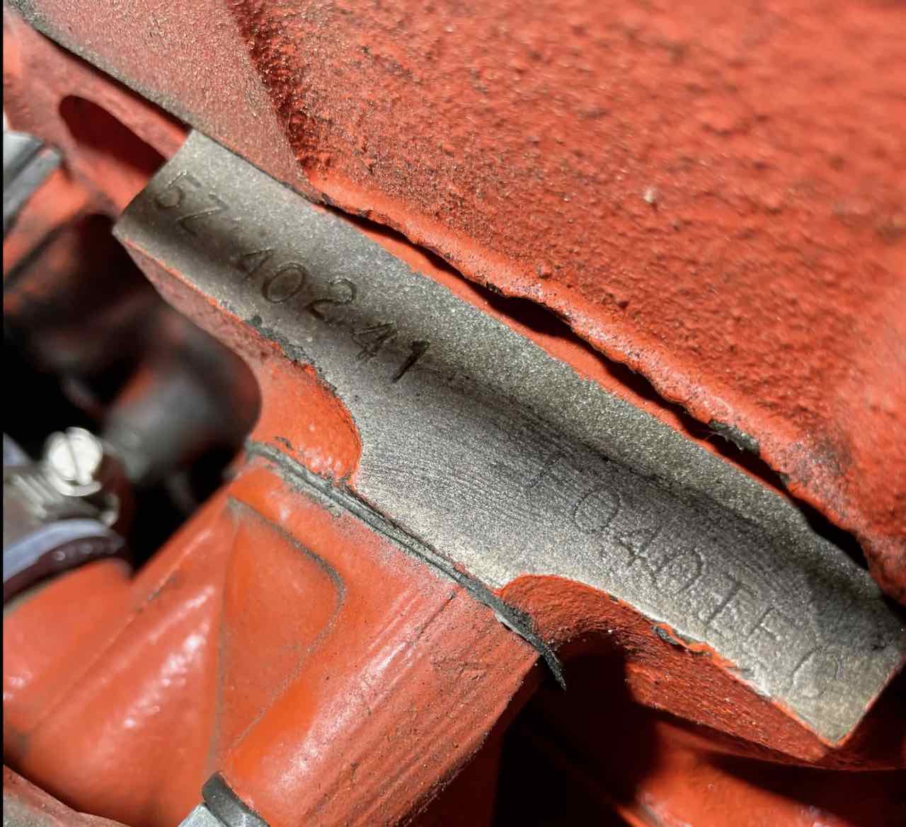

Pic of the engine pad in the BAT listing. Lots of undercarriage shots as well.
Gotta say, this shot makes me think the paint and body work looks much better in pics than in person. I could be wrong of course.

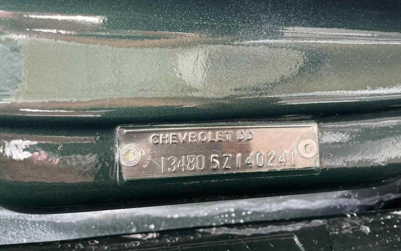

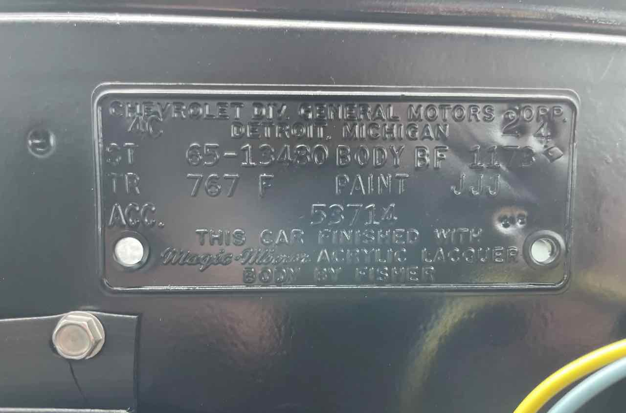

Engine pad, VIN tag, and cowl tag from the BAT auction pics.

Thank you gentlemen, many questions answered!! And I agree Bill!
