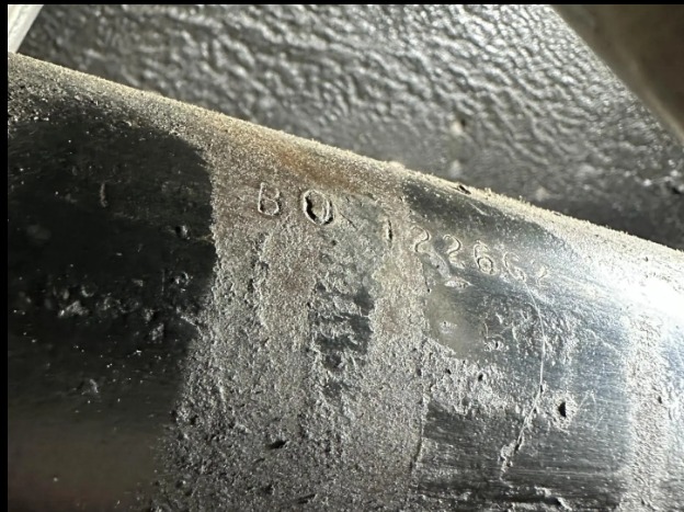

Has a 388 block with casting date of K-16-8 and a rear is a BO1226G2
124379N609445

That rear axle stamping looks altered also. The O in the BO stamping looks to be stamped over.
