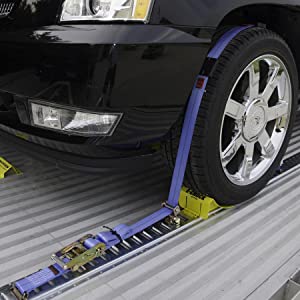

Just did this on my 24 Ft Trailer. Used E track and made to measure straps from Macs Tiedowns. Used Grade 8 bolts and large washers with nylon nuts underneath. Tracks were placed for 59 inch front and rear track and minimum 108 inch wheelbase.

I always add e-track to my enclosed trailers. The flexibility for moving tie down points is great - especially when hauling ATVs. However, for bigger cars it’s kind of a PITA to fit yourself between the wall of the trailer & the car to install the anchors. Anybody else find that to be an issue?
I don't trust that single strap setup but I am usually hauling drag cars with skinny front runner tires. I just had a buddy hauling a car on a dolly that had a single strap come off on one side. I have straps that form a basket that go on each side of the tire with a strap over the top of the tire to tie it together. It is adjustable for tire size. Never have had it come loose.

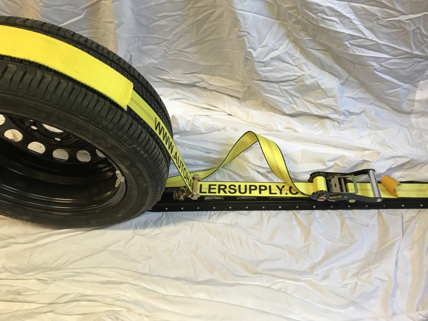

I ordered 4 x 5 foot pieces of Horz E Track from TruckingDepot.com as their shipped
priced was better than Harbor Freight and others........... I bought one extra 5' Piece that I am going to cut into shorter pieces and use for backing plates under the wood floor of my Pace American Trailer Now I will order 4 x https://www.autohaulersupply.com/cat...het-553839.php from AutoHaulerSupply.com and 4 x https://www.autohaulersupply.com/cat...-dw-554785.php so I can use my own ratchets (I have many extra)
