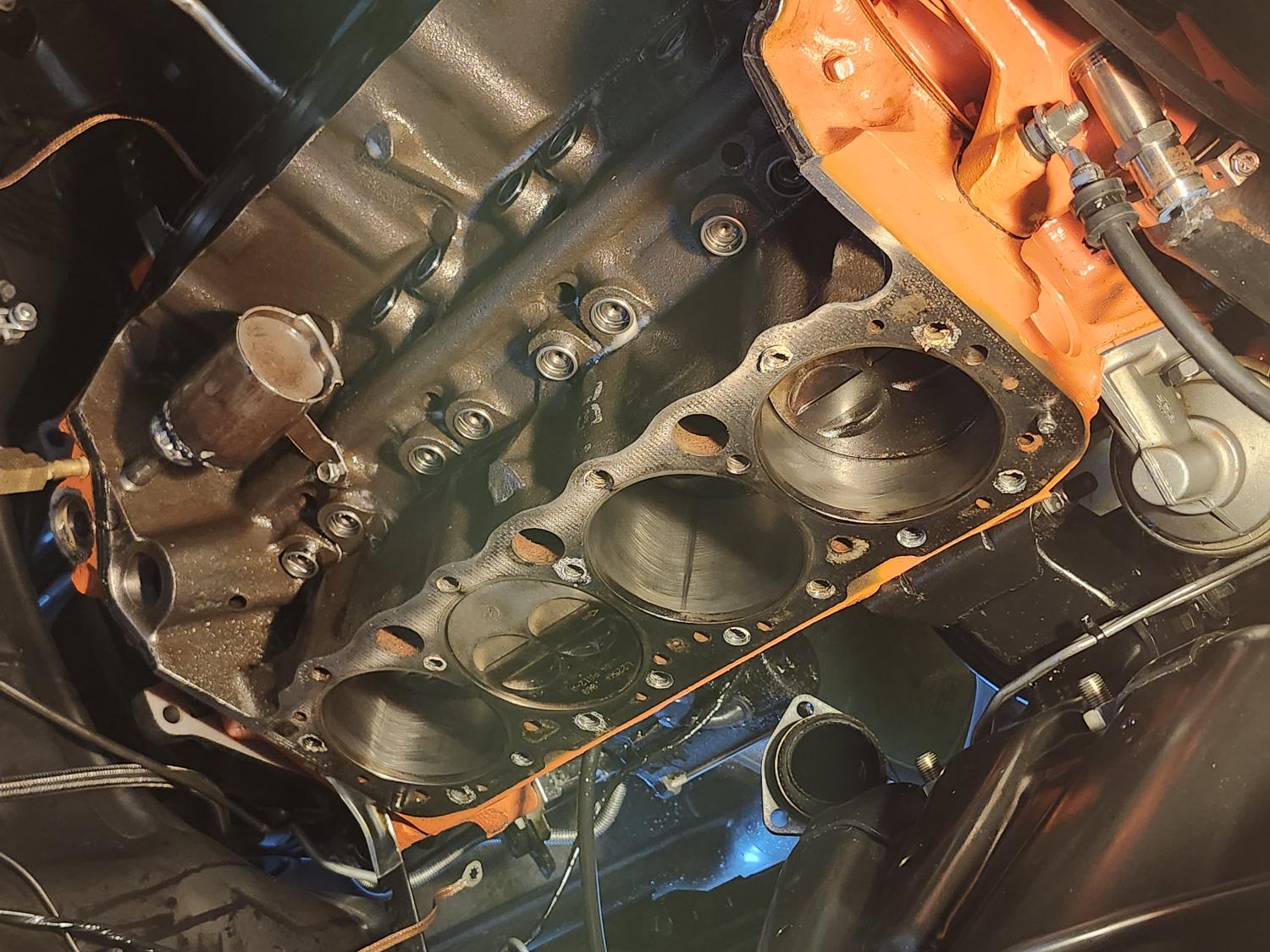

We pulled the heads on my 67 Nova SS with a 327 and found coolant in the cylinders. Both headgaskets were toast on my new 700 mile motor. Any ideas as to why this would happen?

Originally Posted by X66 714 View Post
What was the condition of the coolant?....Joe
The coolant was clean...a straight 50/50 mix. The motor actually hydraulic'd trying to start it. Very weird that both head gaskets went. One was severely compromised. I will try and post some pics.

Originally Posted by Lynn View Post
Gonna need a lot of pictures.
Any mods to the block or heads or intake?
Couple of photos

It appears the use of sealant on the head bolt threads was way overdone and migrated between the gasket and block/head, preventing the gasket from sealing flat and tight. May not be the cause of the gasket burning out between the cylinders, but it should still be avoided when reassembled.
Could be the gasket itself was inferior for the task. What compression is it built to ?
The scoring in #4 needs to be addressed as well. Possibly the missing piece of the fire ring wedged between the piston and cylinder wall..

Sorry to see all of this. Like Mitch mentioned, the #4 cylinder will need to be addressed. I'll also add, the rods will need to be checked for twist. Sadly, it's a rebuild all over again.
