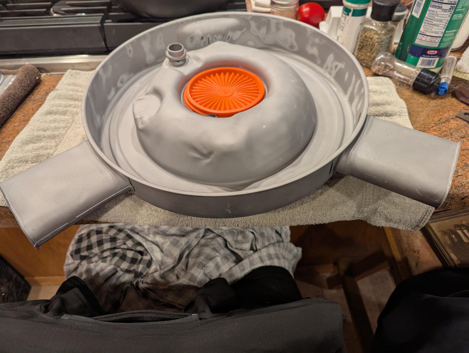

I'm attempting to restore a 1970/71 Z28 Air Cleaner.....
Using 100 Grit Garnet Sand (in a cabinet) the Black Paint & Gray Primer
is coming off quite slowly.....I am suprised as I would have thought the
original mfg would have used a cheap lacquer, but apparently not.........
Has anybody else been down this road before ????
I am thinking to Epoxy Prime the Bare metal and Finish with Single
Stage (Hardened/2k) Black GLOSS Gun Paint

100 Grit should go through that factory paint pretty quick, check the nozzle tip on the blaster gu. These wear out pretty fast, and if worn out, will not concentrate the media correctly. Obviously make sure your getting enough psi to the nozzle as well and that the water/moisture separator is working.

JRSully, I have fwded your suggestion/thought to my contact who operates the company
where I'm fortunate enough to use his machines to clean/blast my parts........
It was taking way to long to remove the air cleaner paint and "Something" must be wrong
with the machine/cabinet set up..............

Air pressure , suction line plugged partially or nozzle worn out

One other thing could it have been powder coated , that usually comes off slower blasting..

I use glass bead and crushed glass every day . Factory come off easy with good equipment.

I am using someone elses equipment to blast my parts & this old GM Air Cleaner
I am not wanting to insult or pixx my contact off..........but I agree with you'll
that something is wrong and I only can HOPE that it gets fixed.....

With gray primer under the black, I doubt it's original paint. I've never seen anything but a thin coat of black on original parts under the hood and interior.
I'm with Gary and use crushed glass at LOW pressure ~ 40# and original paint disappears easily and the glass doesn't remove metal. It will leave a slight texture for the epoxy to bite into.

Air cleaners typically have the thinnest of black paint on anything under the hood. They were very thin coats at best and when I have blasted them it is similar to blowing old dust off of something. In other words it takes no effort whatsoever and a standard lid will generally take me about 2 minutes to blow the paint off of both sides. Never have I found primer on any engine parts. Most of them were dipped in lacquer and not sprayed. The air cleaner being one exception. The dipped parts take a little more effort but there is still no primer on them.

How old is the blasting media. Fresh media makes a very noticeable difference.
