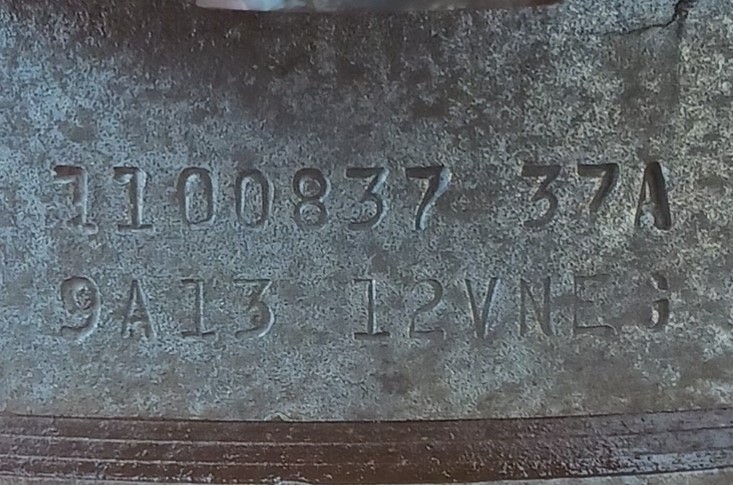

Might just be a Camaro dunce but I have questions.
Pics are Delco stuff on a third week Feb 69 Baltimore Chevelle.
Delco is still Delco right?
9K I would think is for a 1970?
Am I missing something here?
Were 1969 Z28 cars being built in Oct 69? I would think Oct 68 makes more sense?
