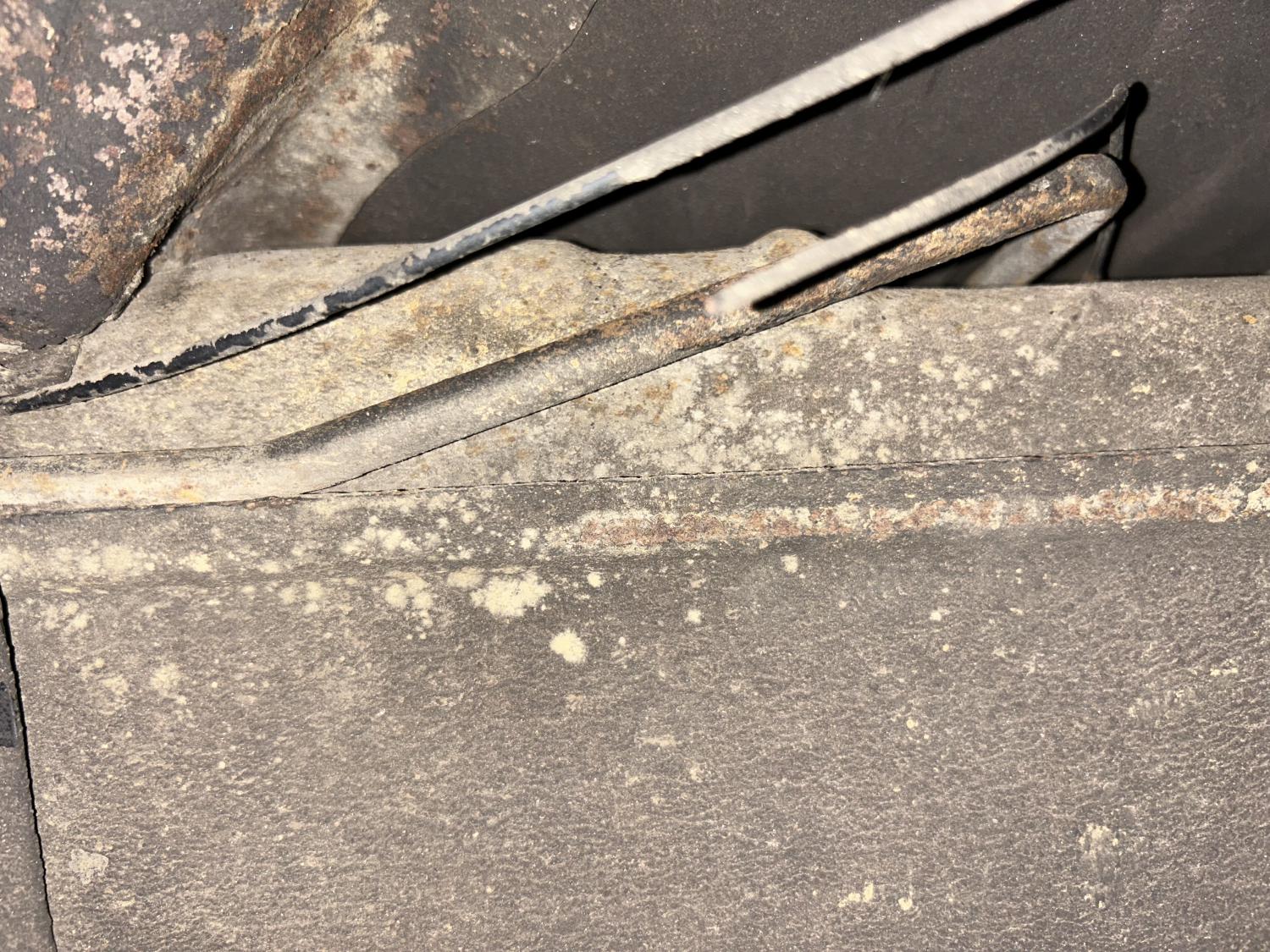

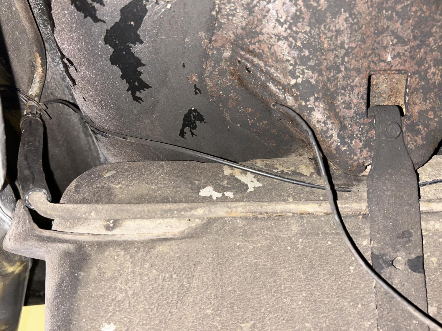

Hoping someone here may have some info on the differences between L34 and L78 sending units. I’ve got a 69 Nova that I believe was an L78 and was under it yesterday getting pictures of the single fuel line and noticed the sending unit only has one single 3/8ths line coming out. I’ve done some research but no one’s ever given a set answer. I would assume the L34 would return to the tank through the sending unit?

A L34 would have had a return line. I looked in a 69 Assembly Manual to make sure and it does show a return back to the tank. So, it looks like you have a L78 setup. Post some more pics of the car you have. Guys here love the pics...

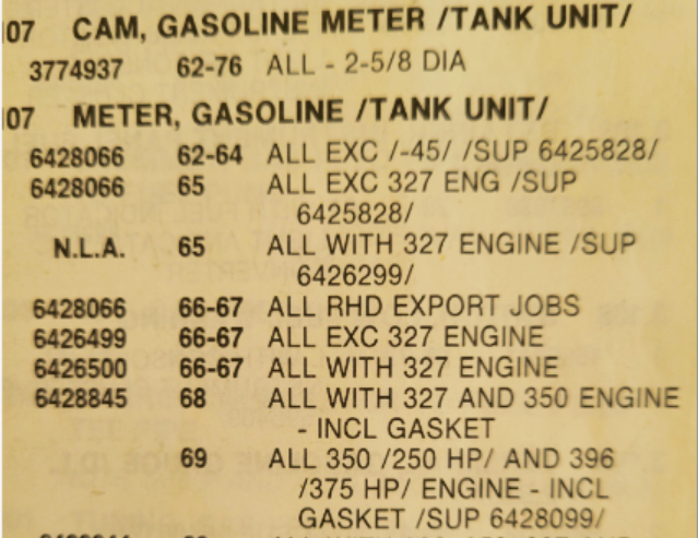

I found 6428845 as the part number for the 1969 Nova L78 sending unit in my parts catalogue (as shown at bottom of picture) Good luck !
