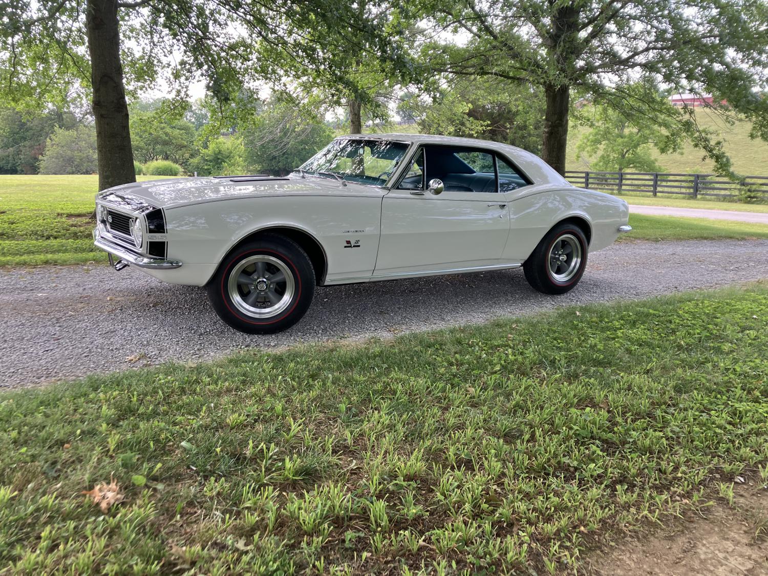

I like American Racing Torque Thrust on any car. These are 15x6, IMO they’re just a cool 😎 wheel. These tires are Coker red line radials 205/75R/15, no rub!

Those look great, I have 215/70-15 redline radials on my '68 Z and they also fit well.

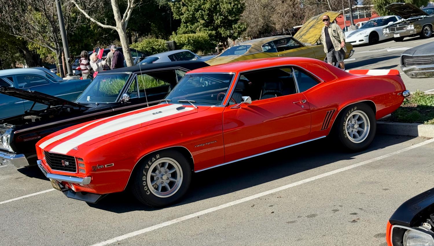

I have BFGs in 215/65 and 255/60 (custom sidewalls to say Goodyear but they are BFG TAs). They are on reproduction Minilites from Trans Am Race Engineering, 15x7 with 4” backspacing and 15x8 4.5” bs. Factory RS fender wells with all hardware and no rubbing
