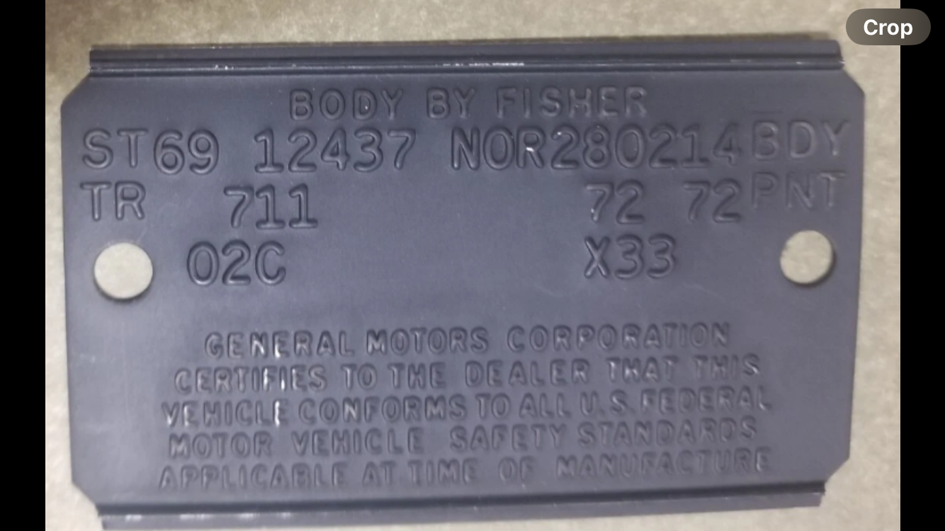

https://www.ebay.com/itm/127183467678
reported VIN 124379N694129
N694129 was final assembled on or about October 3, 1969. Car has a non-original 12A [1st week December 1968] body tag. The upper dash panel has been replaced, breaching the factory VIN tag installation.
Both tags may not be original to the car; hidden VINs should be verified.
Car recently sold at the 2025 Mecum Indy auction.

Add these two to your list of questionables :
(Both currently on the bay)
Chavez Ravine
No question about it, repops!

Two trim tags with the same body numbers. You would think the fakers would have more brains than that.

Nope...

A vert became a coupe??? I wonder what the hidden VINs and title say :|

Nope, two different cars.

This listing was ended by the seller on Fri, Jun 20 at 1:28 PM because the item was sold. ��
