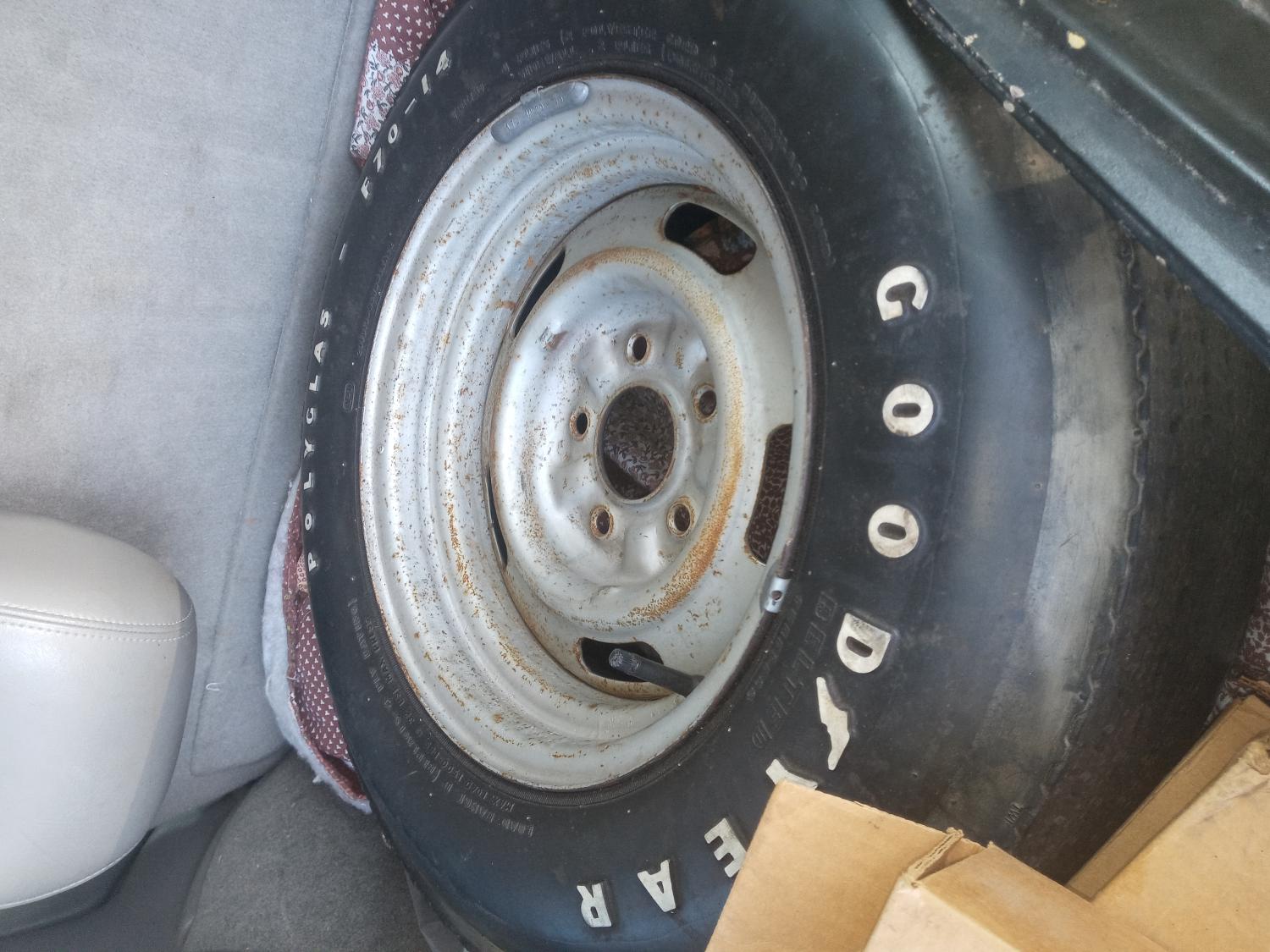

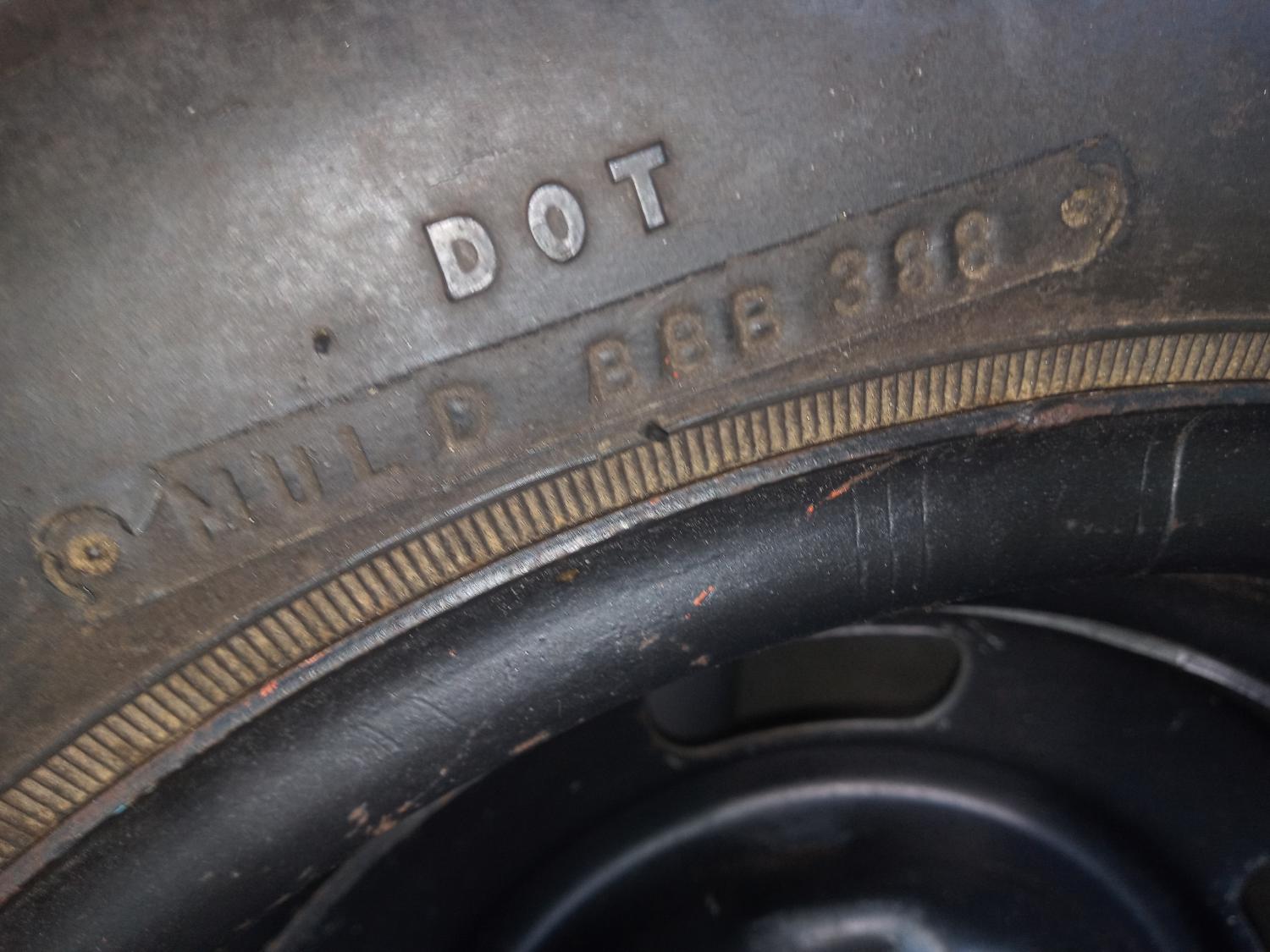

What is the date on this Goodyear F 70 14 tire its on a 69 YJ rally wheel

Looks like post ‘71, DOT System 4 coding. Last 3 digits are week and year, so 388 is probably the 38th week of 1978.

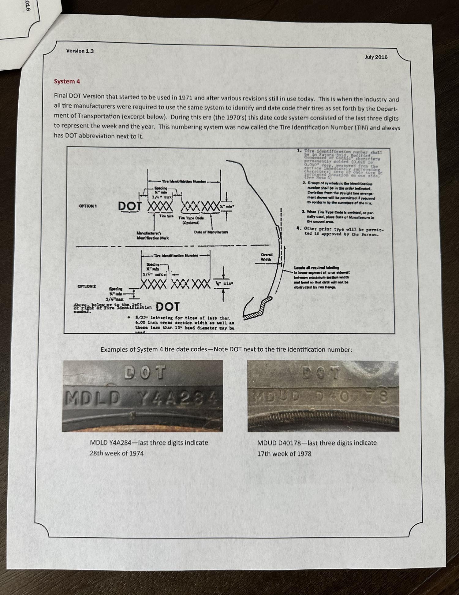

This should help to validate what has already been said:
