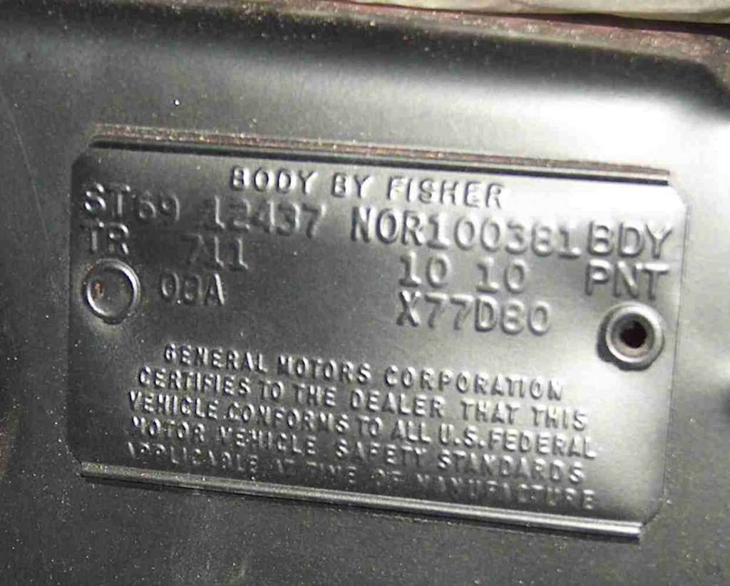

I am currently refinishing all my suspecsion components on my 03E Norwood built 69 Z/28 Camaro. I need your expert opinions for proper color and placement of inspection paint on the following parts:
-disc brake spindles
-steering arms
-tie-rod ends
-idler arm
-pitman arm
-steering box
-drag link
-sway bar
etc, etc... i have many photos but some contricict others and others are inconclusive. I have a start but would apriciate your help. Any pics would be awesome. Thanks!
TM
