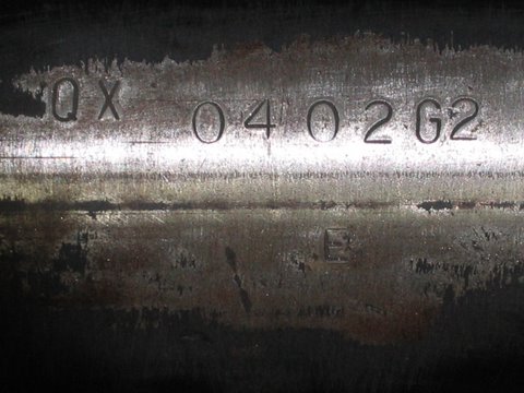

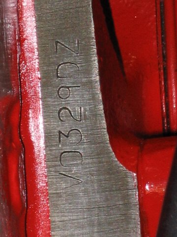

I need help determinating if the numbers posted here are real or restamped.

When was the car built? 04A 04B? Do you have a pic of the vin stamp from the transmission.

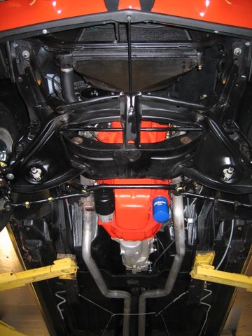

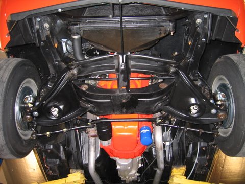

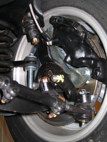

I need help identifying the number - if they have been restamped...

Another Picture -

Another picture - 2

More pics 3

Another Picture 4

All the dates line up... the axle is a 2nd day April the engine build date is March 29th... What is the casting number on the block? Do you have a photo of the Vin on the block?
The broach marks on the deck look a little heavy. I would like to hear what some other guys think... The car should most likely be an 04A or 04B build date...
