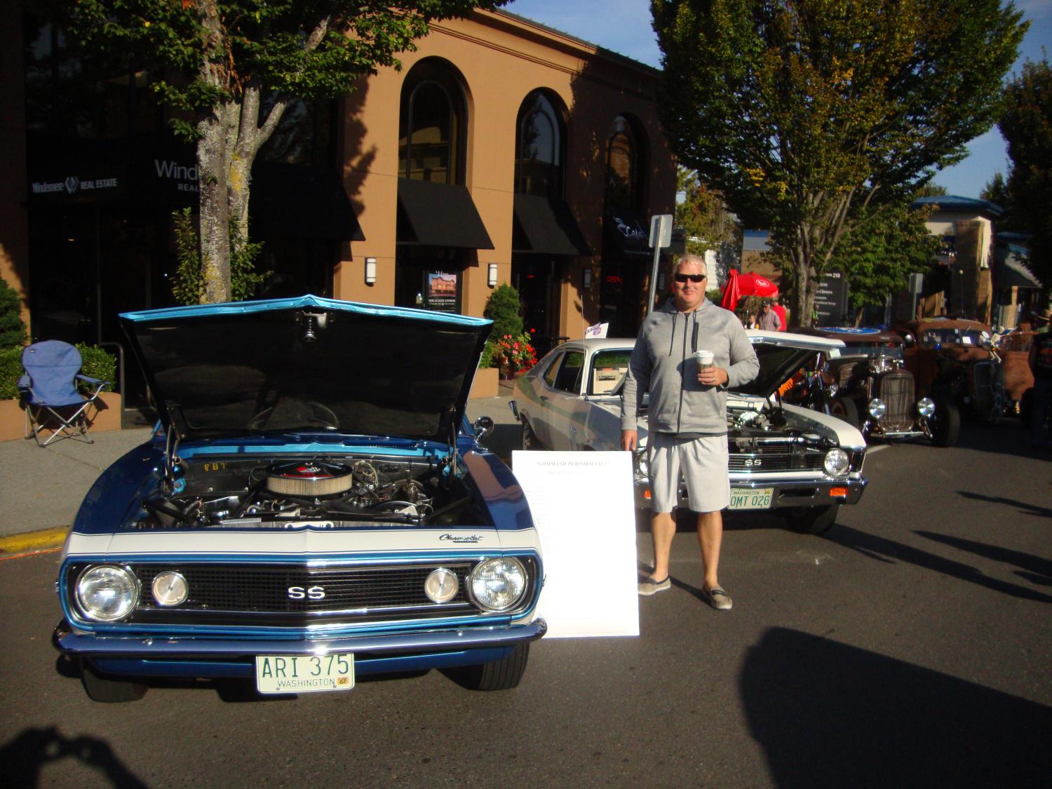

  #29
Old 09-13-2023, 06:09 AM
169indy's Avatar
169indy 169indy is offline
Join Date: Oct 2001
Location: Washington
Posts: 780
Thanks: 1,085
Thanked 699 Times in 234 Posts
Default Paul at the Edmonds Car show w/ 4K
What a great time talking with Paul and a pair of Solid Lifter Hot rods
JIM
69 Los Z11
68 SS/RS 396/325
68 Los Z28
