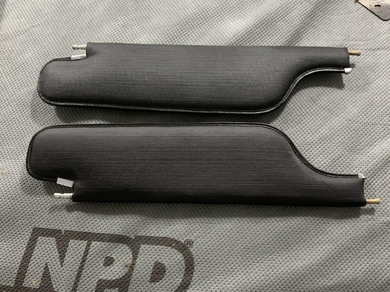

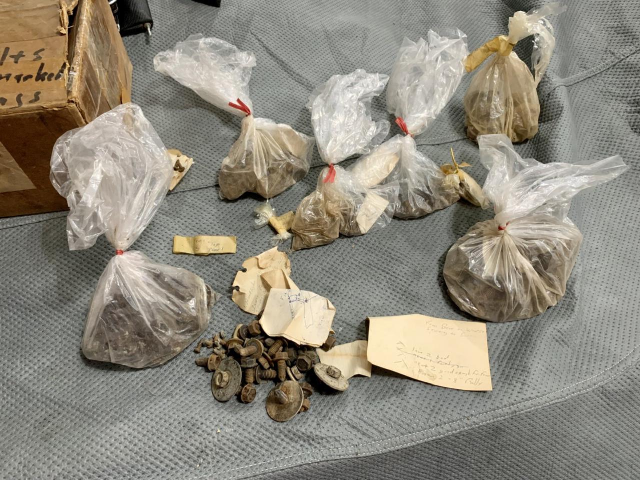

Small updates. Been too cold to get out in the garage for very long here but started on bolts, screws etc of cleaning and preserving.
Process is as follows:
I’ve setup several small plastic containers. First one is citrus degreaser to soak the bolts etc. pull them and clean them with a blue scotchbrite pad and dry off. Then into 1st container of evapo. Sit for 24hrs, pull out clean again using the evapo as the cleaner along with blue scotchbrite pad then into another container of evapo and wait another 24hrs. After that pull out towel dry then use PB Blaster silicone lubricant.
Photo 212 - 213 - Hardware as found. At least it was bagged and tagged back in the late 70’s early 80’s.
Photos 214 - 215 - 1st rd of hardware after cleaning.
Photo 216 - 217 - Sunvisors after cleaning. Forgot to snag a before.
