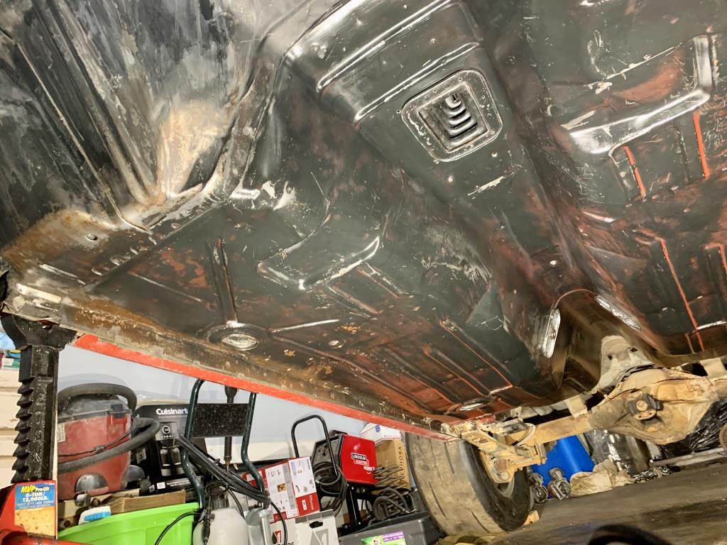

Roughly 3 days at around 8hrs total of cleaning over the weekend I managed to get the rear floor tubs cleaned along with the remainder of the tunnel. I still need to go back over the pass side forward of the seatbelt retainer but other than that and a few touch-ups here and there I hope to either move back to the firewall and then sub so I can get that back under the car and then begin on the rear of the car.

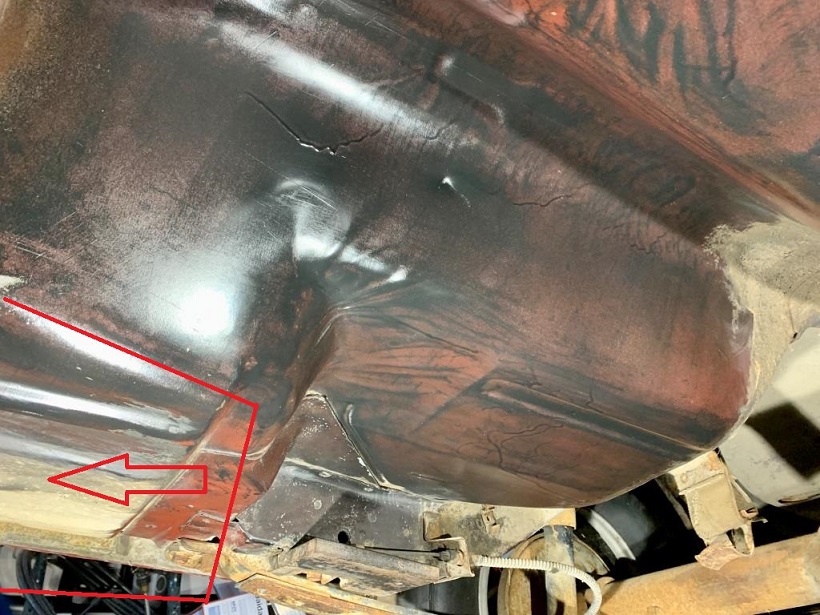

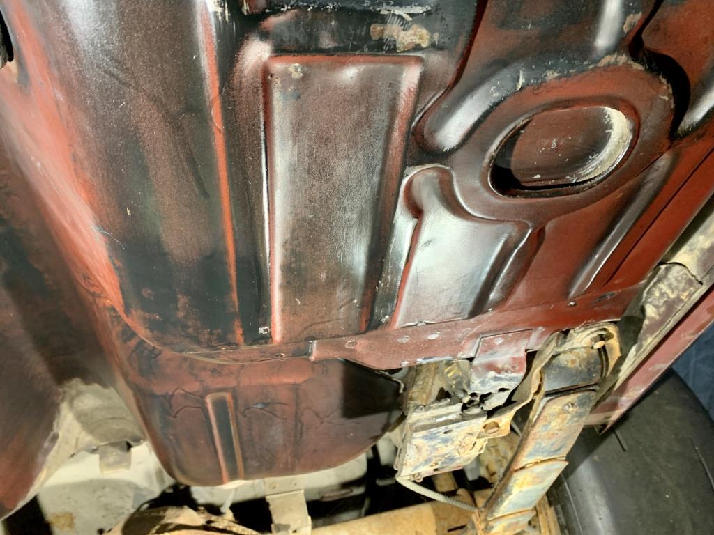

Photo 394 - Rear tubs before cleaning. Not sure if there is a difference in Texas dirt and TN but this was very compacted. I found success with soaking it down with my favorite citrus degreaser and then gently peeling of the layers with a razorblade on the flat surfaces making sure not to damage the original finish.
Photo 395 - 398 - After removing the majority of the dirt with the blade I hit the surfaces again with degreaser and then gave it a work over with a blue Scotchbrite pad. Once the surface was bare and clean I then coated it with Meguiar's #7.
Photos 399 - 401 - Finished product - I still need to go back and hit the pass side front tub in the photo with the red arrow.

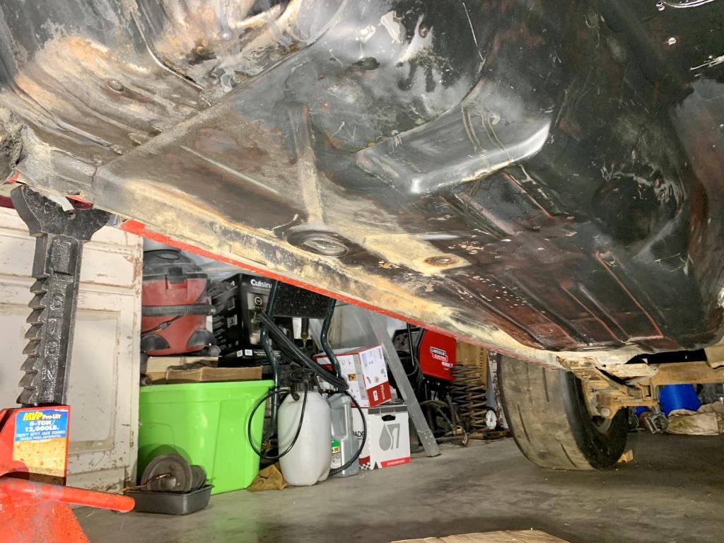

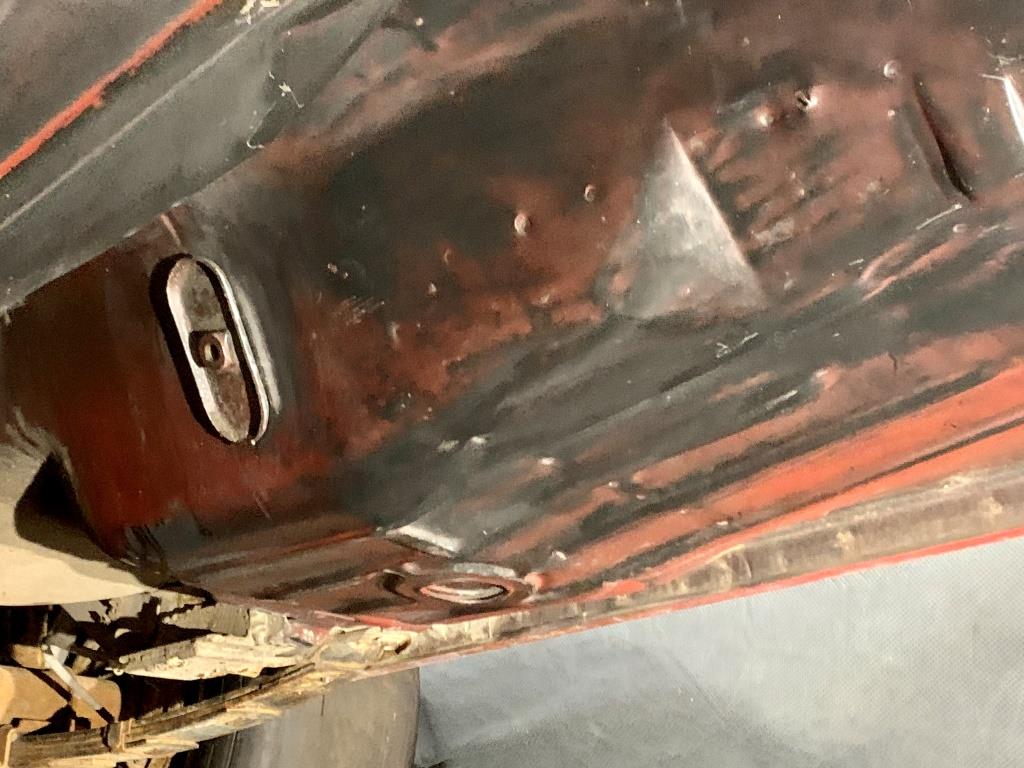

Went ahead and knocked out the passenger compartment last night. Overall, I am very happy with the condition of the floors considering the amount of caked on Texas and TN dirt. Next, I'll move my attentions back to the firewall and then on to the subframe.

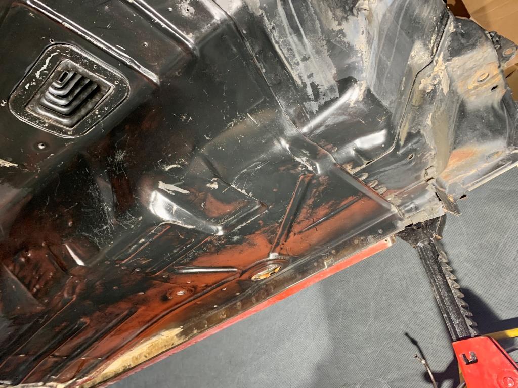

Photos 402 - 403 - Finished pass compartment floor. After cleaning with the aforementioned process; I applied a healthy coat of Meguiar's #7. Oh and I received my plastic razorblades I ordered and they seem to work ok for the cleaning of dirt and grease but I'll put them to the test on removing heavier layers.
Photos 404 - 405 - toeboards and front floors.

A couple of before photos for contrast.

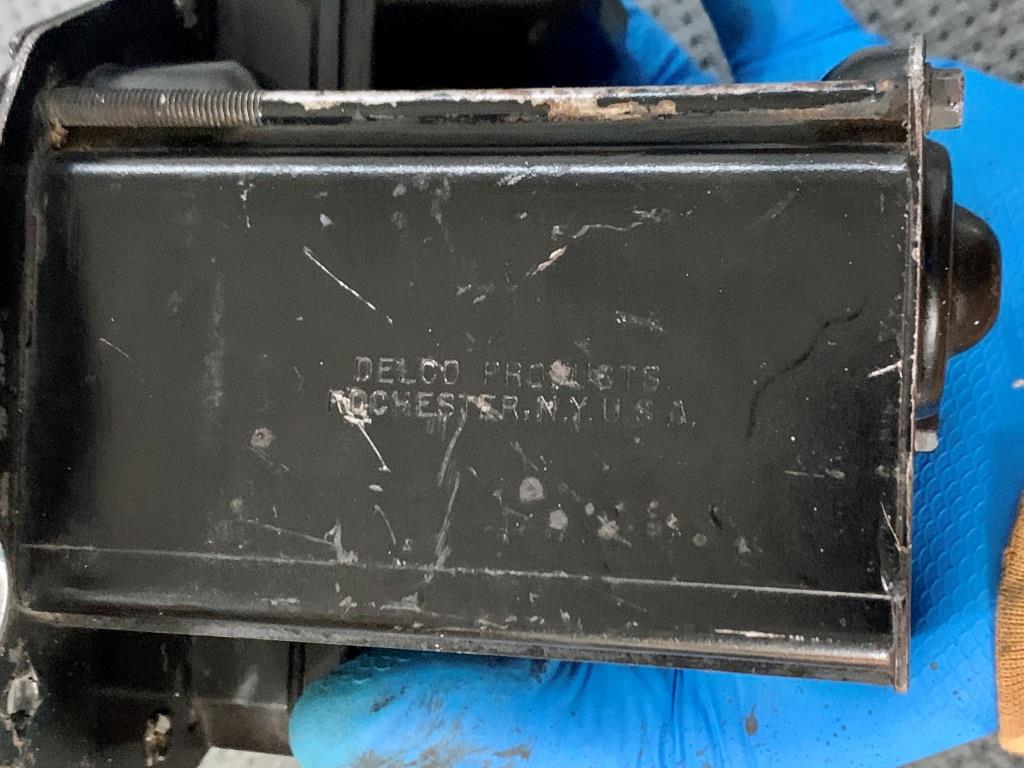

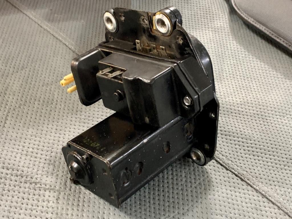

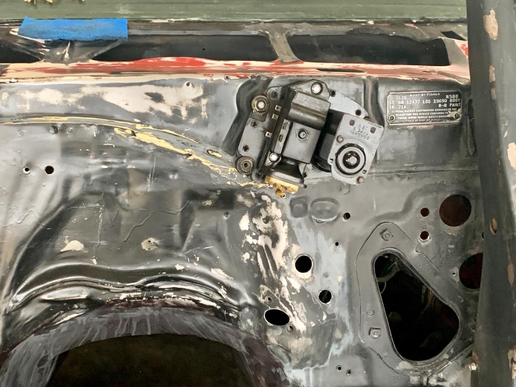

Not much of an update but I am still working on the cowl and firewall (mainly cowl, wiper transmission area) removing black spray bomb, primer to get down to the white for the stripes. Very time consuming but I will update that once I have completed the upper cowl area. But just to have some sort of an update here is the wiper motor clean up.
Photo 412 - 413 - Wiper motor as found. Basically the process citrus degreaser and blue Scotchbrite pad and paying attention to the yellow ink stamp on the can.

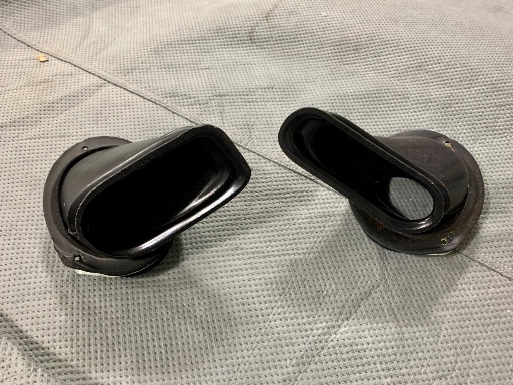

Another small update. Since I needed to pull the cowl vent ducts I decided to give them a cleaning as they too had black overspray on them.
Photos 425 - 426 - Duct after removal and before cleaning.
Photos 427 - 430 - Citrus degreaser, green Scotchbrite and then soaked in Evaporust. Finally applying Meguiars Mirror Bright Vinyl & Rubber Treatment.
