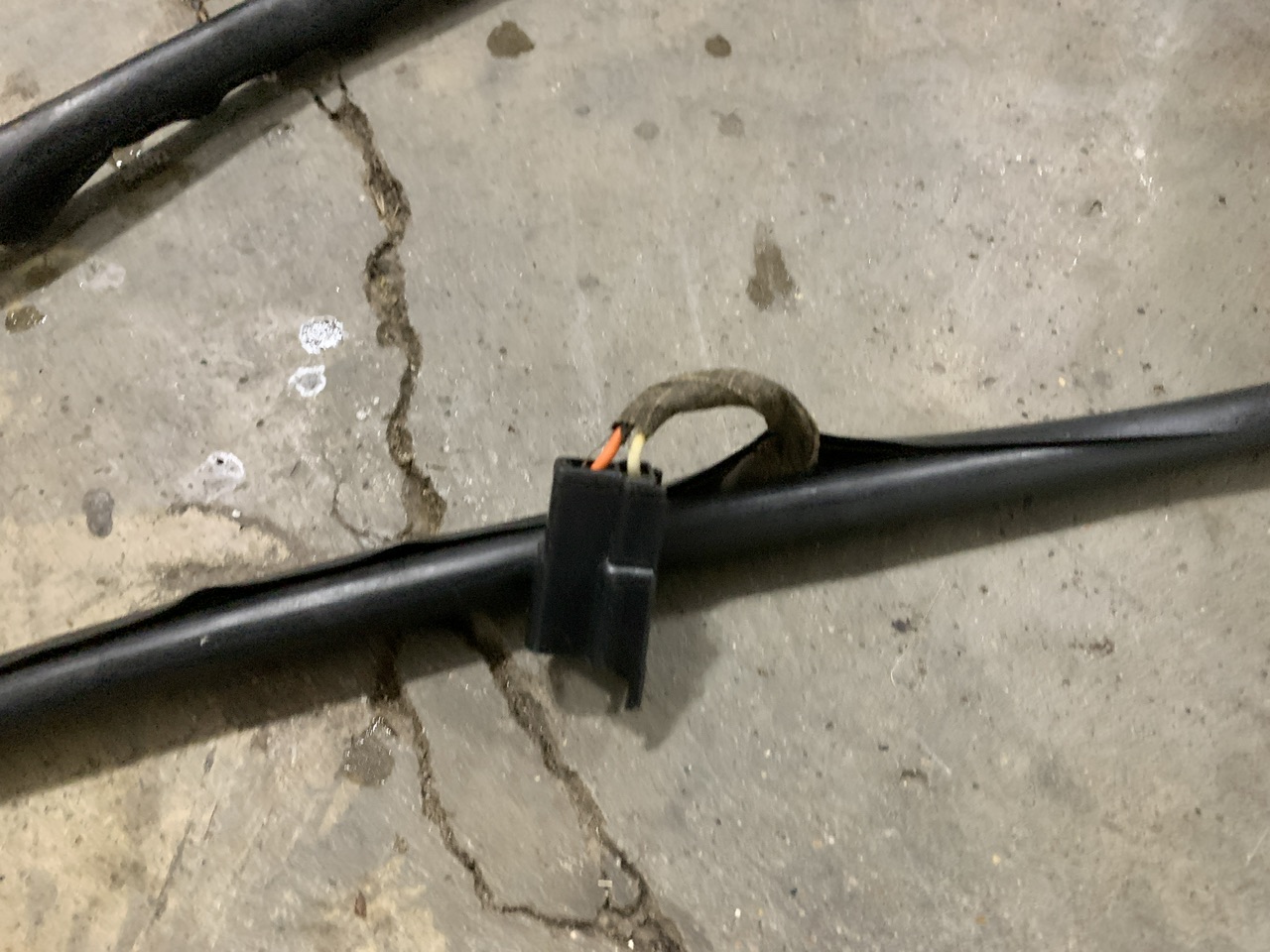

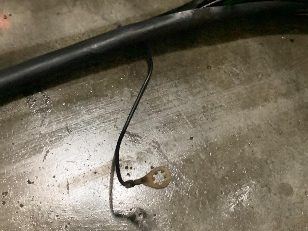

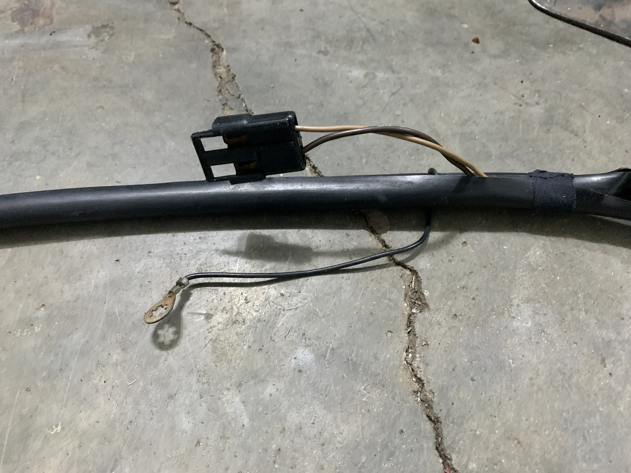

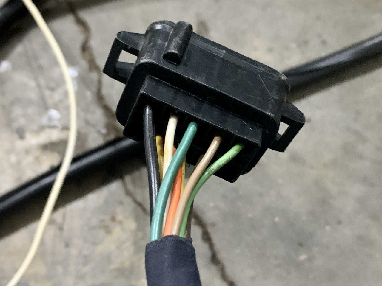

Not much progress this week as I worked on other items out in the garage but I did start on the tail light harness now that the other harnesses are just about ready to go.
Photos 510 - 511 - Before cleaning
Photos 512 - 517 - After citrus degreaser and then soaking the sockets in evaporust as they were pretty rusty. Cloth tape will be on order soon so I can repair the pieces missing as well as the clips.

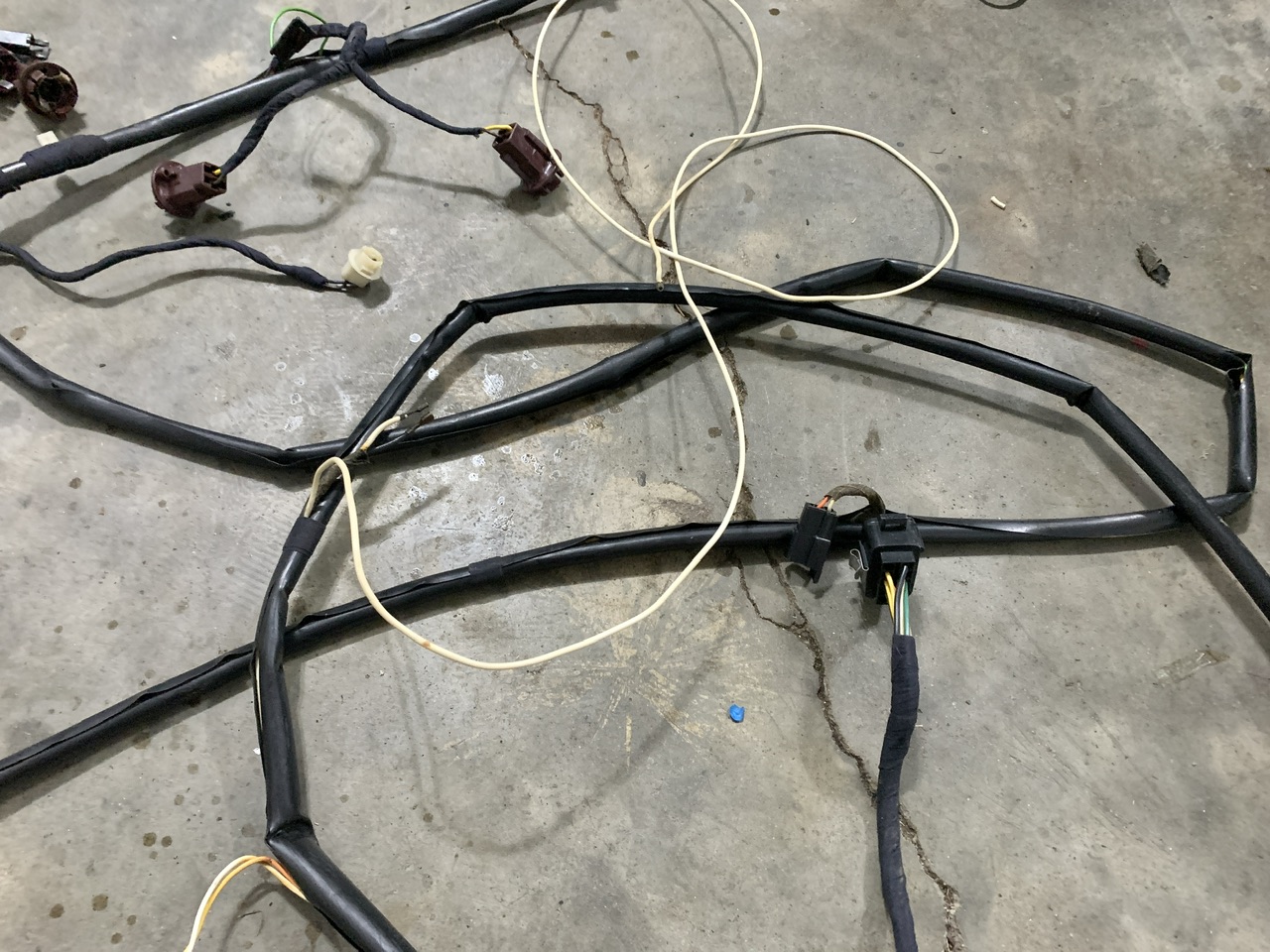

Photos 518 - 523 - The tail light harness has now been repaired and unfortunately I ended up having to retape the majority of the harness. But original sockets etc so it’ll have to do.

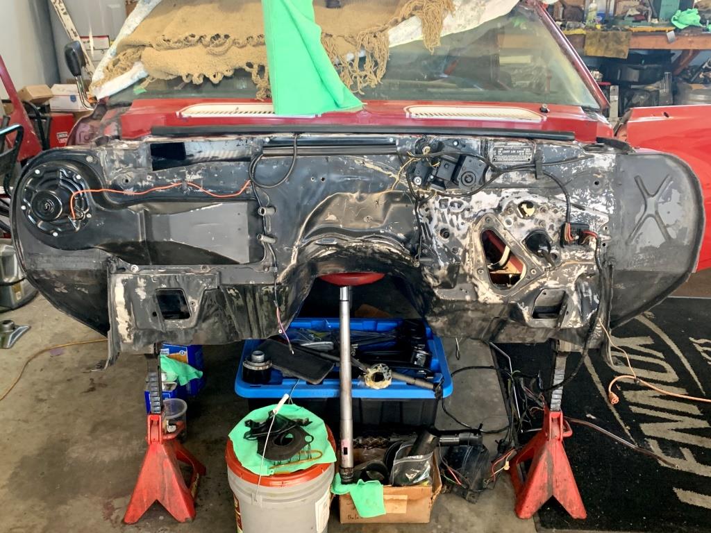

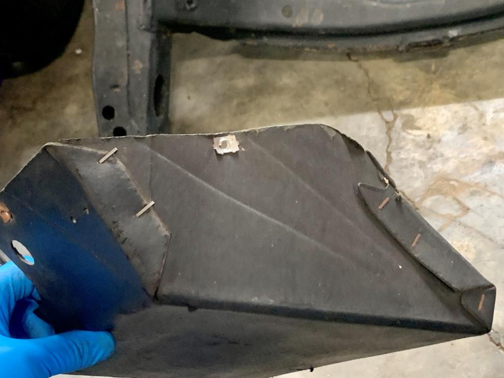

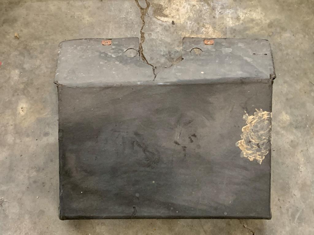

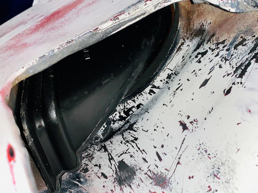

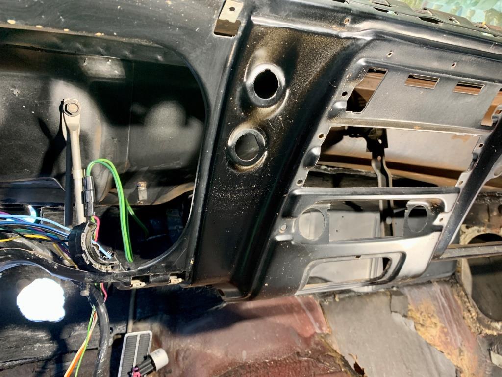

Some progress over last weekend. For accessibility I pulled the glove box and door. While it was removed I cleaned the box. Mostly just test fitting everything to make sure I'm not missing anything and of course there are a few odds and ends I have to locate in my parts stash but overall pretty straight forward.
Photo 524 - Before starting the test fitting.
Photos 525 - 526 - Glove box removed
Photos 527 - 530 - Glove box after cleaning
Photos 531 - 532 - Heater box with core installed from the interior.
Photos 533 - 536 - Cowl ducts installed

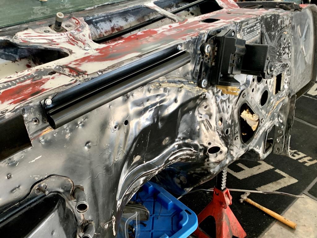

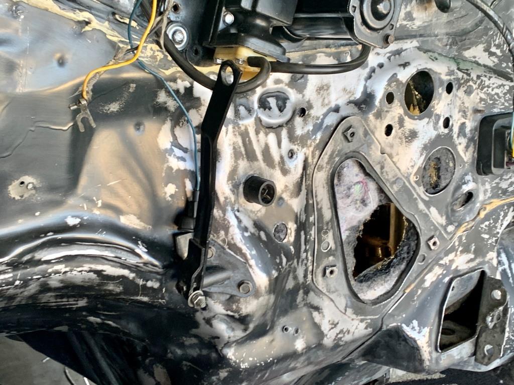

537 - 539 - Outer heater box installed and the rest of the firewall cleaned. BTW the MEK substitute works almost as good as the original stuff so that was nice to see. Also added the wiper transmission, wiper motor, cowl panel and harness (temporary).

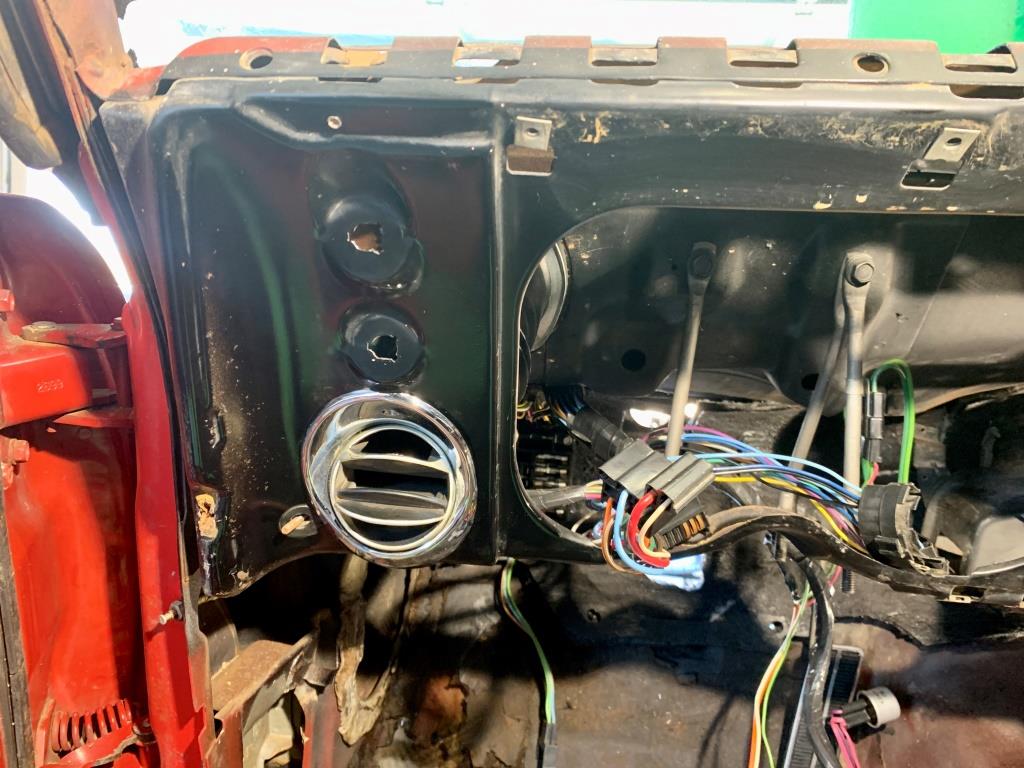

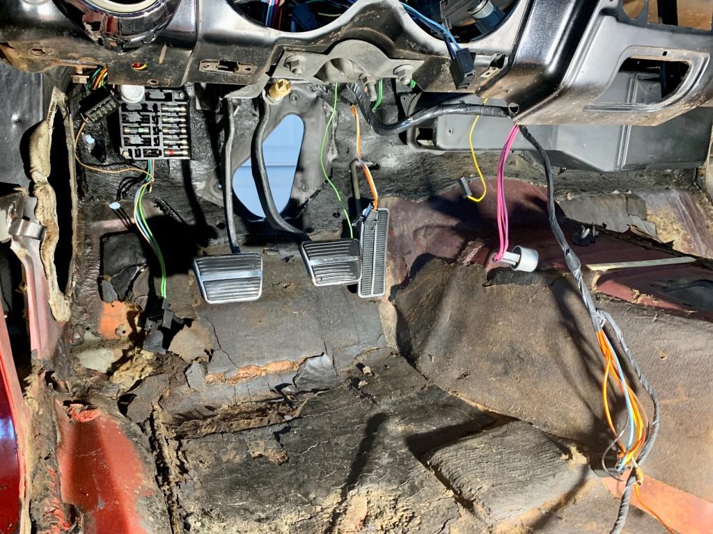

Next updates are the reassembly process for the firewall components, harness, dash items etc. All in all everything is gong back together smoothly.

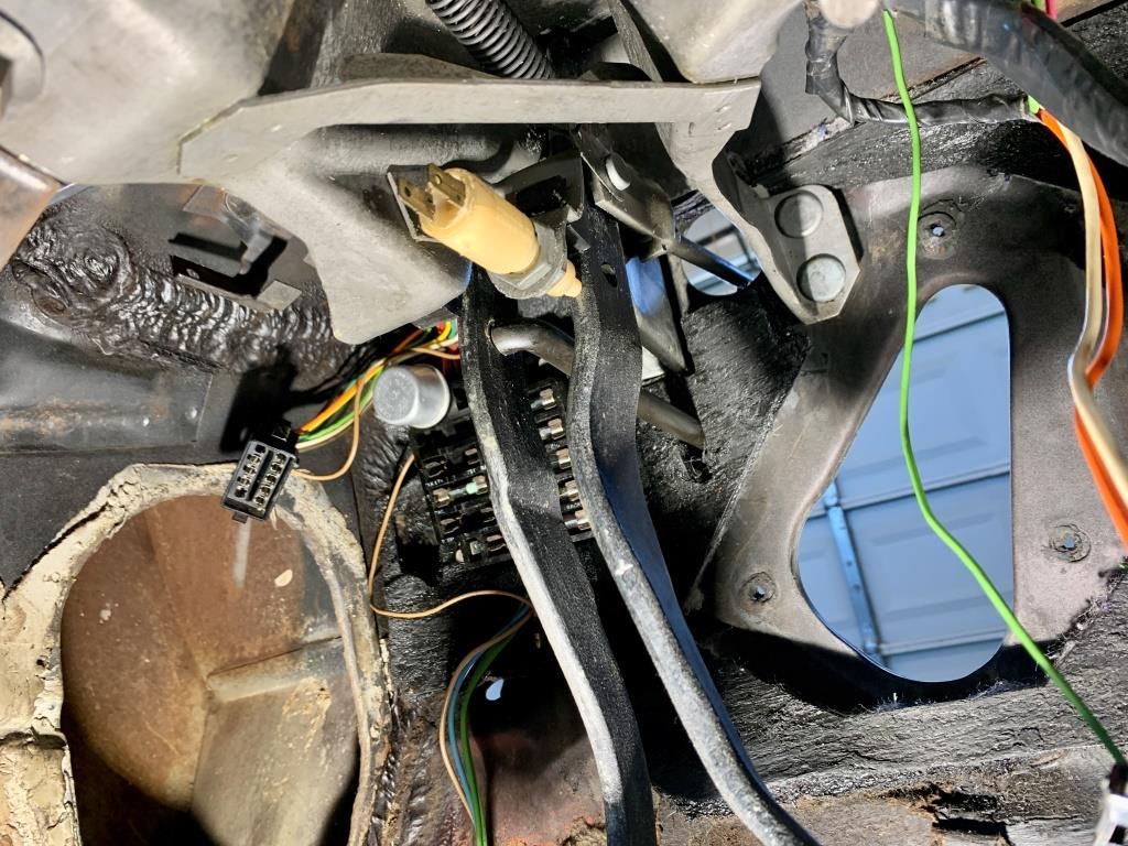

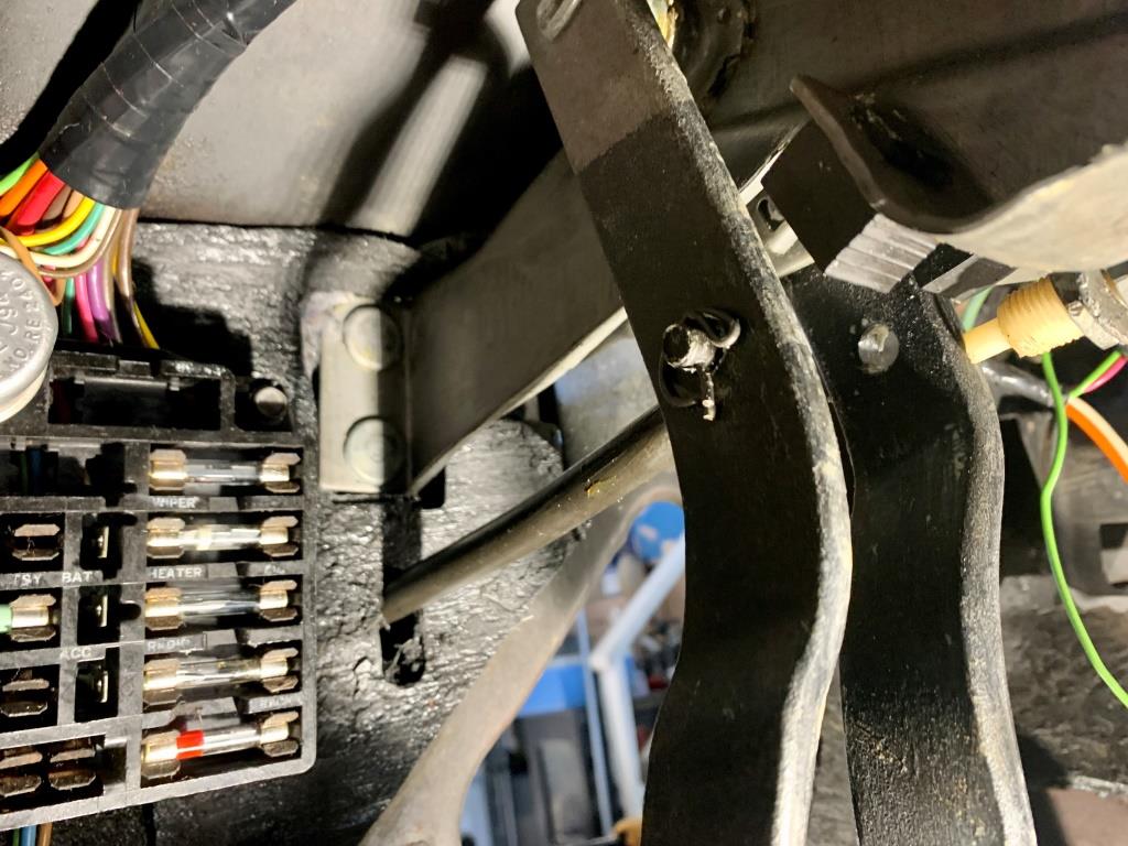

Photos 542 - 546 - Fuse block installed, along with gas pedal and throttle arm.
Photos 547 - 548 - Next were the Astro Vent duct work and the bezels & balls

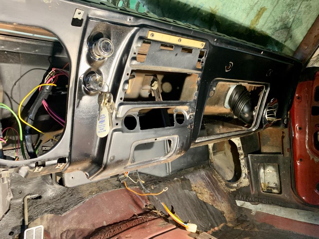

Photos 549 - 551 - Using my Harbor Freight special da polisher I run over the dash face with some Mequiars 105 since I had previously had #7 soaked into the paint prior.
Photos 552 - 555 - Installation of the drop down brackets, pedal assembly and clutch rod along with its boot.
Photos 556 - 559 - Dimmer switch, ignition, headlight, wiper and cig lighter switches installed
Photo 560 - Shot from the outside of firewall. Also installed correct 4 rib washer nozzle hoses.
