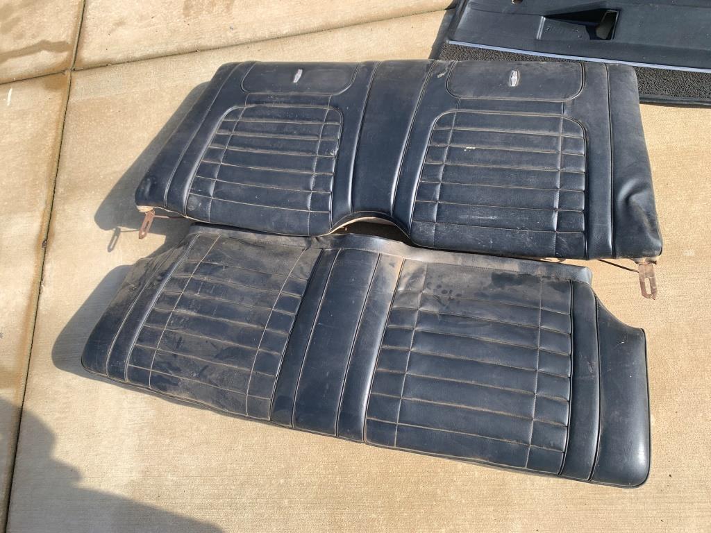

I had gotten the seats out over last weekend and of course I showed the pass seat previously but here they are now ready to be installed. The shine will die down after soaking for a few days. As dry as they were I felt it wouldn't hurt.
Photos 607 - 608 - Seats when pulled this weekend
Photos 609 - 611 - Front seats finished.
Photo 612 - Rear seat

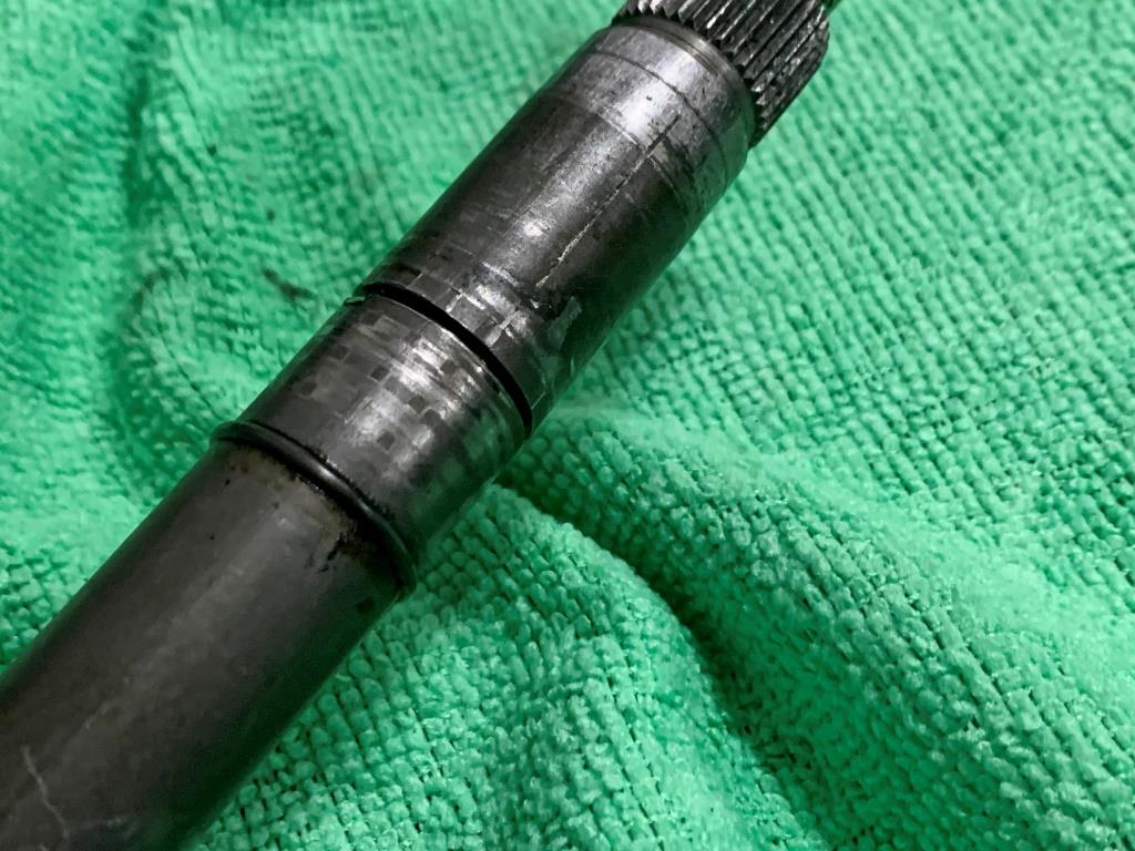

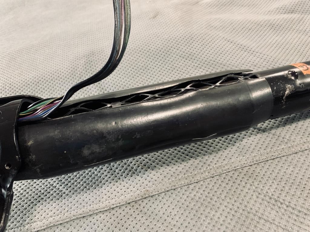

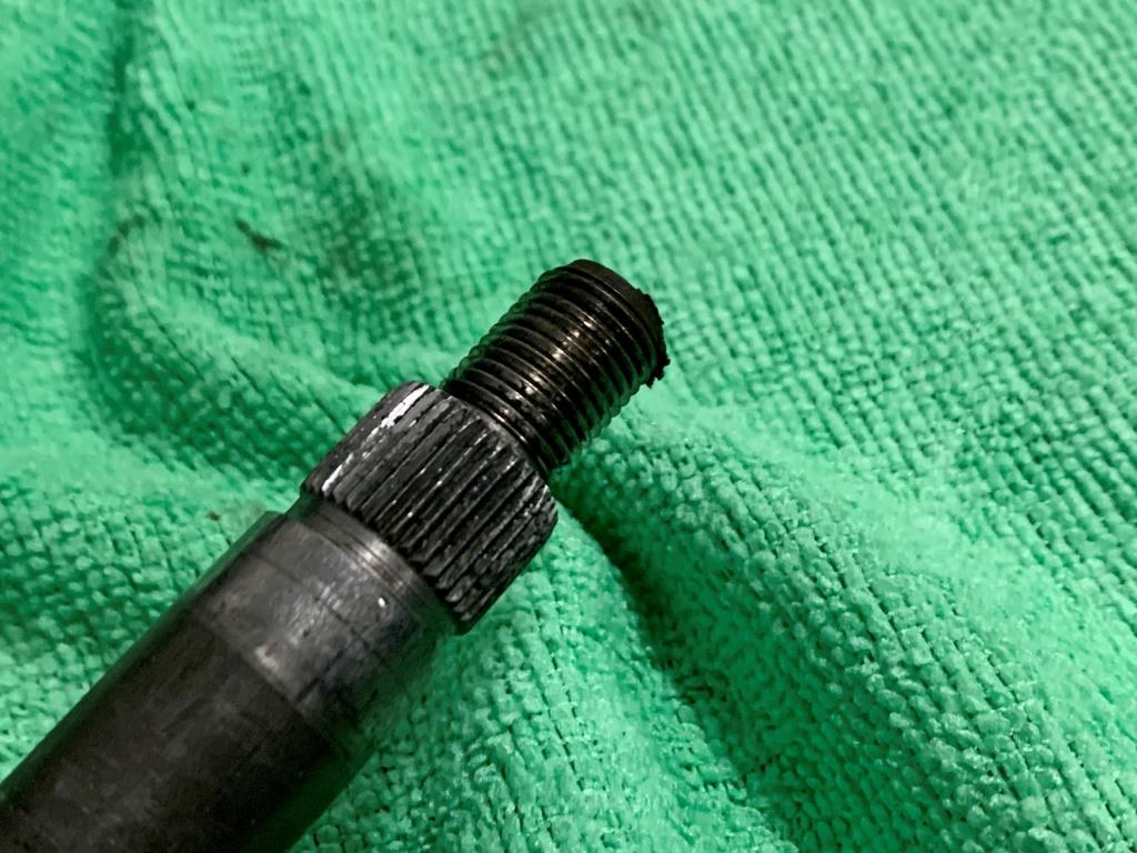

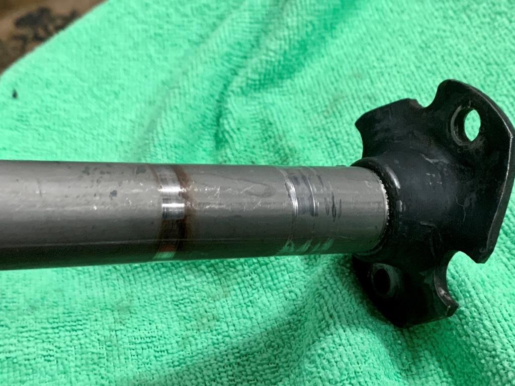

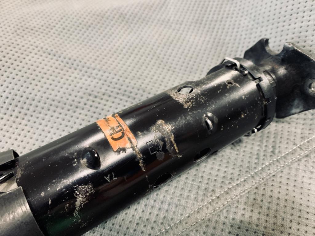

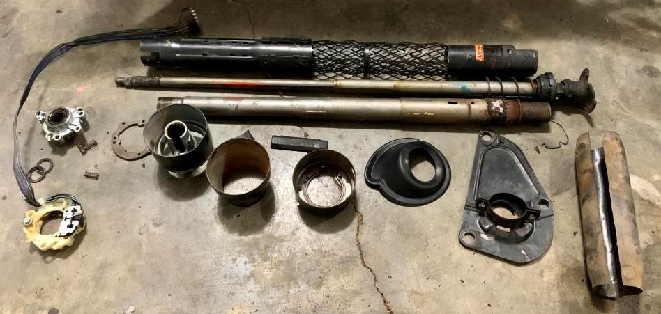

Previously removed the steering column for clean up and turns out the lower bearing was trash so it'll get a disassembly, clean and new lower and since they do not sell the bearing for the upper and since it is staked into the aluminum housing it would be a possible issue but thankfully the upper bearing on mine was good just needed repacking with grease. Lower bearing was ordered from Ground Up (ss396.com).

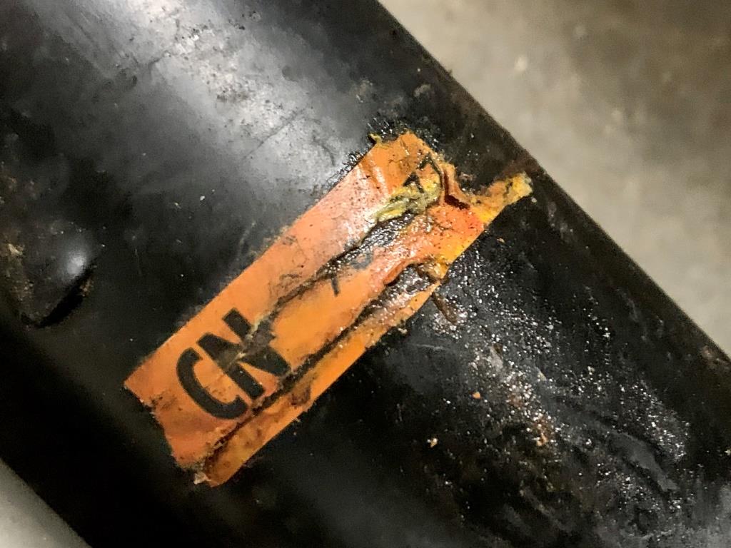

Photo 613 - 616 - column removed and disassembled and of the column decal

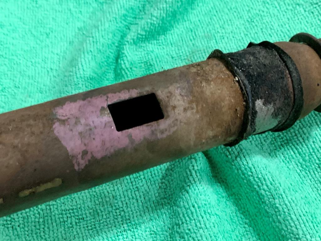

Photos 617 - 626 - Paint markings on inner tube & main shaft etc.
Photos 627 - 629 - Tolerance ring & spring before and after
Photos 630 - 632 - Lower bearing compared to new replacement

Photos 633 - 634 - Lock plate
Photos 635 -637 - Upper bearing

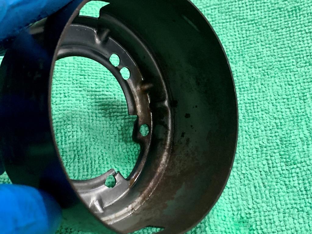

Photos 638 - 639 - Mid cup after cleaning but before evapo
Photos 640 - 641 - Lower cup after cleaning but before evapo
Photos 642 - 643 - Cover
Photos 644 - 646 - Inner tube after soaking
Photos 647 - 649 - Cups and cover after soaking and polishing with Mequiar's M105

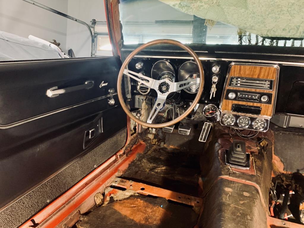

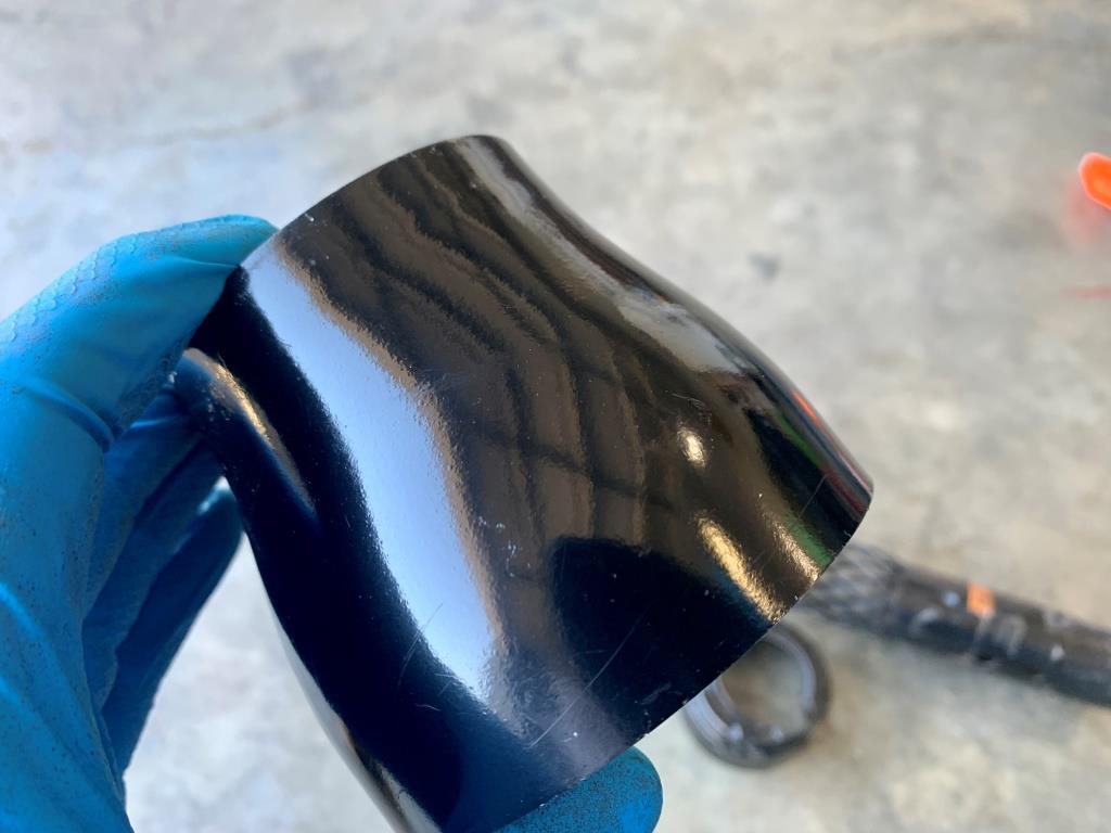

Photos 650 - 653 - Mast jacket after cleaning and polishing
Photos 654 - 659 - Reassembled
Photos 660 - 666 - Back in the car.

Love that original orange tag!!
