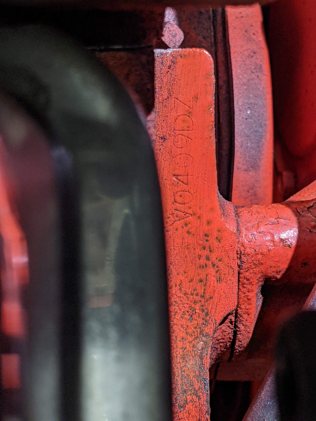

I love how the Z28 has a VIN sticker on end of the door with a VIN 124379N632690 and it says the build date 07/69 which is way off. Too early of a car to have the sticker.

The engine pad stamping is legit on the Z. The rear axle tube stamping also looks good. Too bad the orig tag got swapped. Probably for a color combo change.

Tag is an easy to spot early reproduction tag
