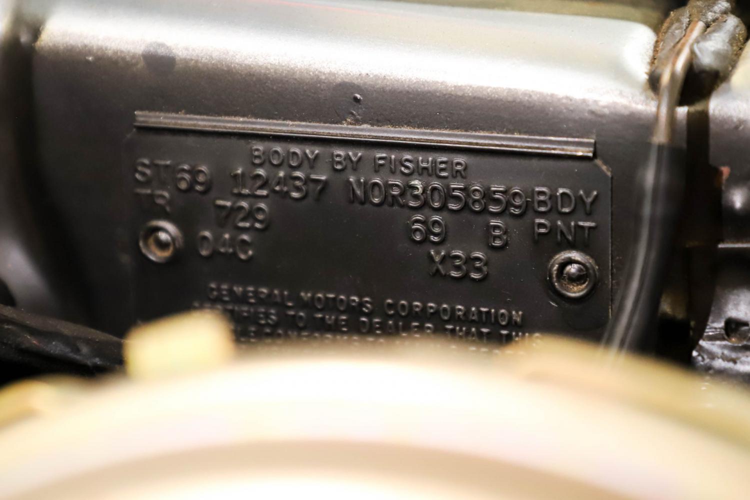

https://www.ebay.com/itm/11540475424...IAAOSwlLJilXkr
123379N660459
From the ad:
"Body off frame, nut and bolt restoration. Factory correct L89 396-375 hp with aluminum heads. The factory only made 311 of these cars. This one is built to correct specs using period correct driveline. The tag on the firewall has code 72 72- correct for Hugger orange, no vinyl also has X22 code indicating SS396."
Missing from the ad: clone, tribute, re-creation. Guess they didn't notice the 6-cylinder VIN.
