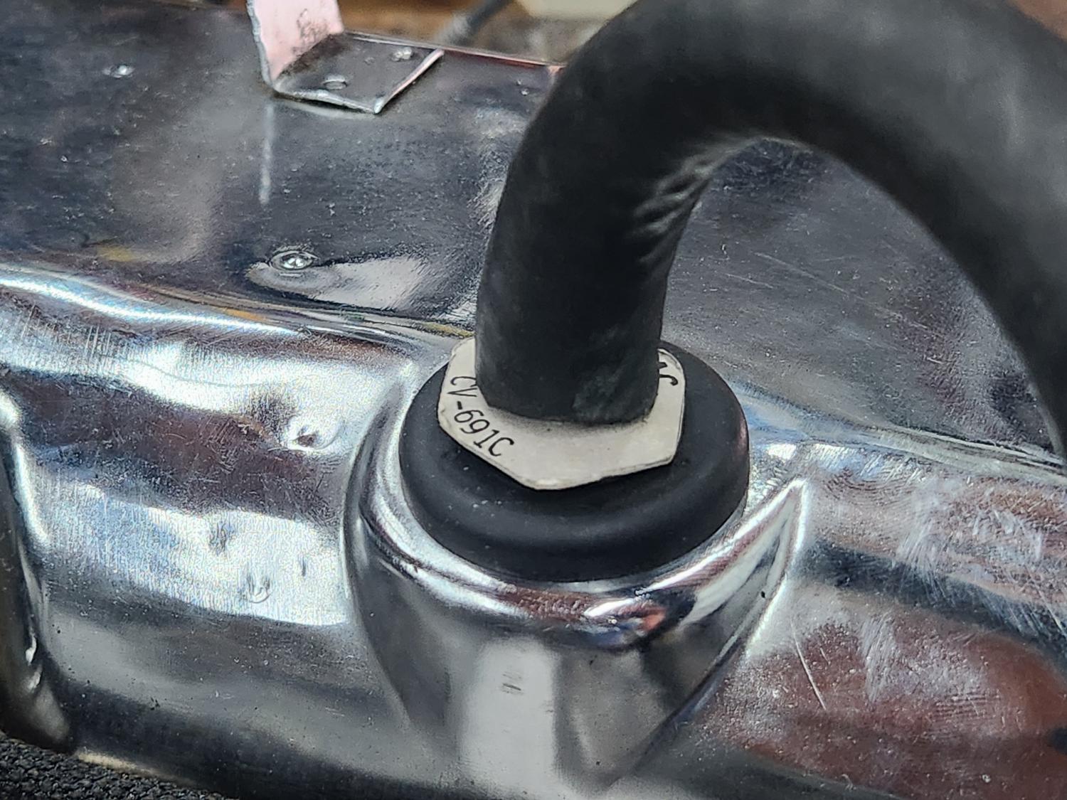

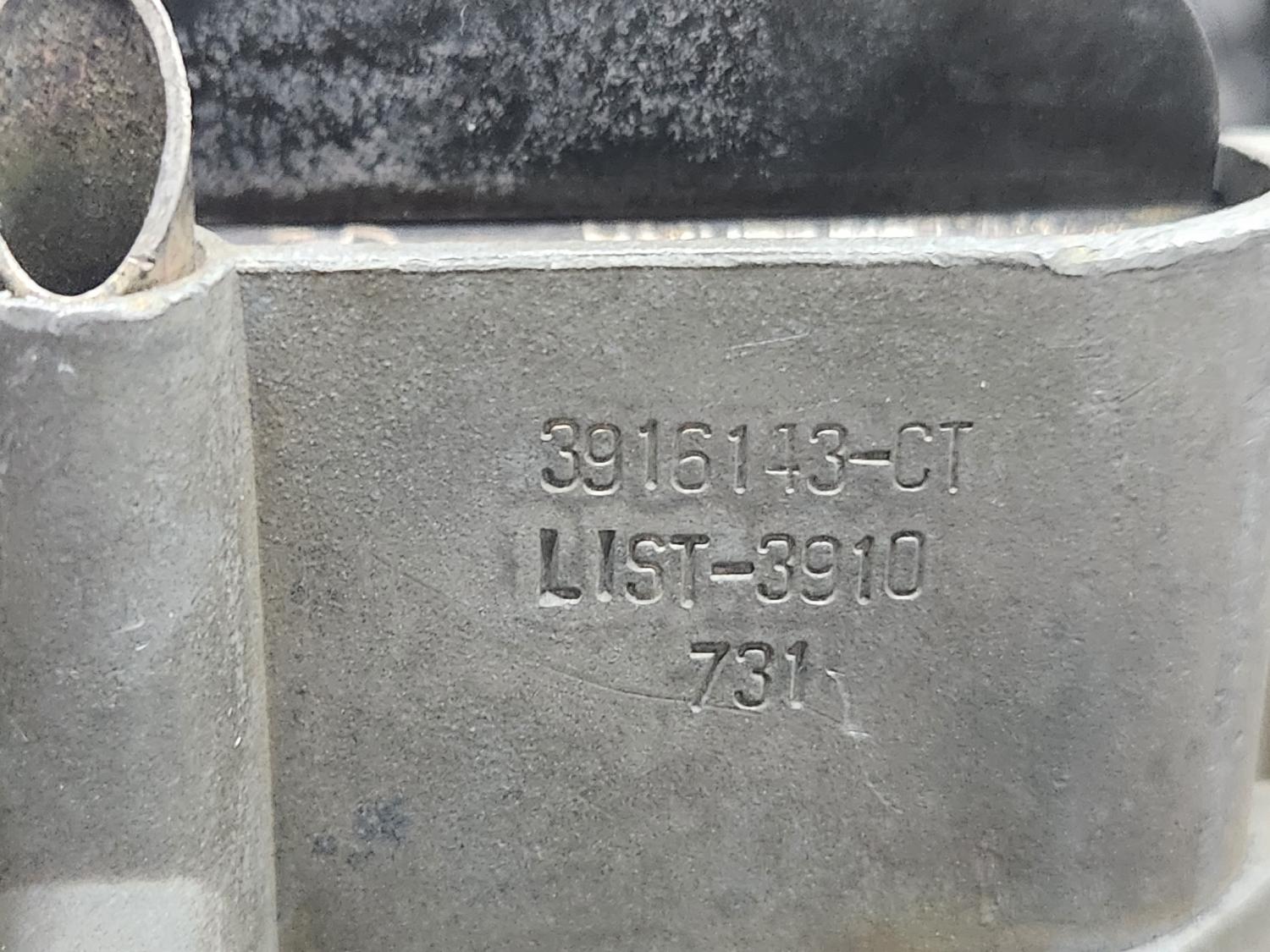

This engine was originally built for my 67 Base model Day2 big block swap project so it is by no means a pure 67 engine.
It is a 70's 2 bolt (studs) main block, 077 heads, 198 intake, 3521 crank, list goes on.
With all that in mind I wanted this engine to look like a NOM built up with all of the 67 touches swapped over.
Some of the 67 only goodies include but not limited to:
March 67 3910
Alt+Pulley
Valve Covers
Crank/Water Pump Pulley
PCV Brackets (square tab pcv hose clamps installed after pics taken)
I used thick valve cover gaskets and studs to clear the polylocks.
The RH temp sender on the intake is for a sun greenline gauge
The M/T Super Scavenger headers fit absolutely perfectly
